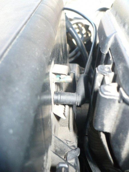

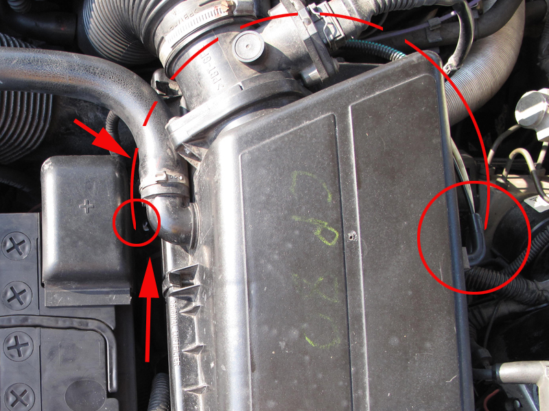

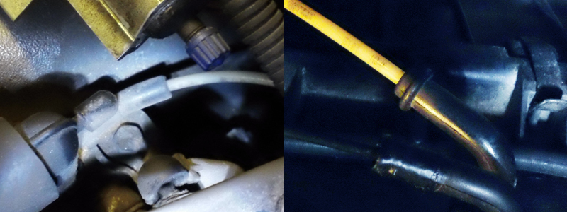

Try this simple fix if you haven't already https://www.matthewsvolvosite.com/airbox-thermostat-failure.html
... and make sure this vacuum line is connected... here are two photos...
upper nipple at this cover...
...to the connection at base near fresh air intake.

Also one question has been plaguing me since I first popped the hood on this car.
The two vacuum nipples on the back of the air box.... Which one is supposed to go to the vacuum tree and which is supposed to go down to control the flap? I've people say both ways.. or does it not matter?

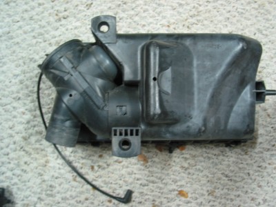

Post by xHeart »
top goes to the airbox base, nipple next to the fresh air intake.
bottom travels to the vac tree.
check for tear then seat/plug the elbows gently and properly.
that is your 18% with 850rpm!
