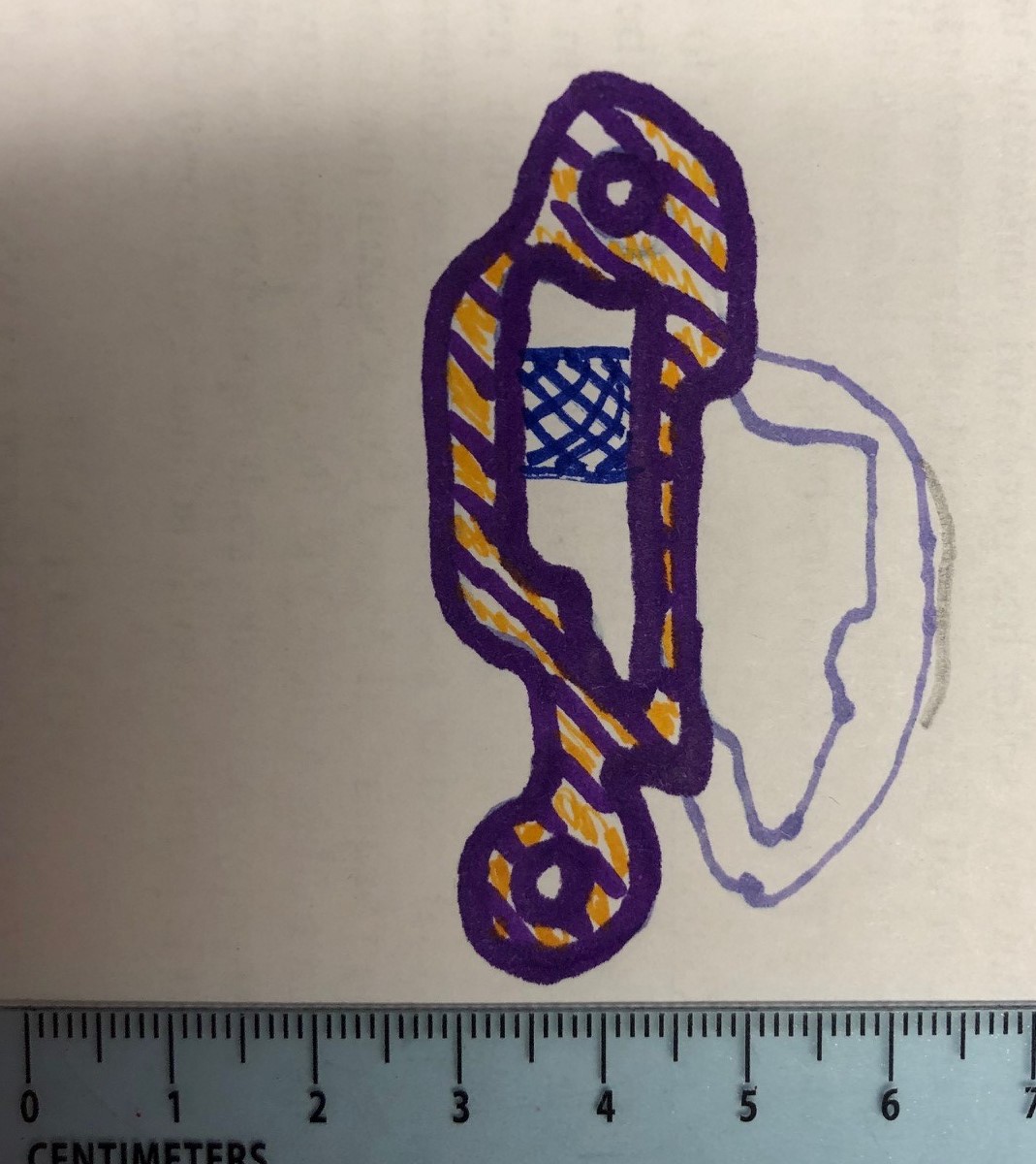

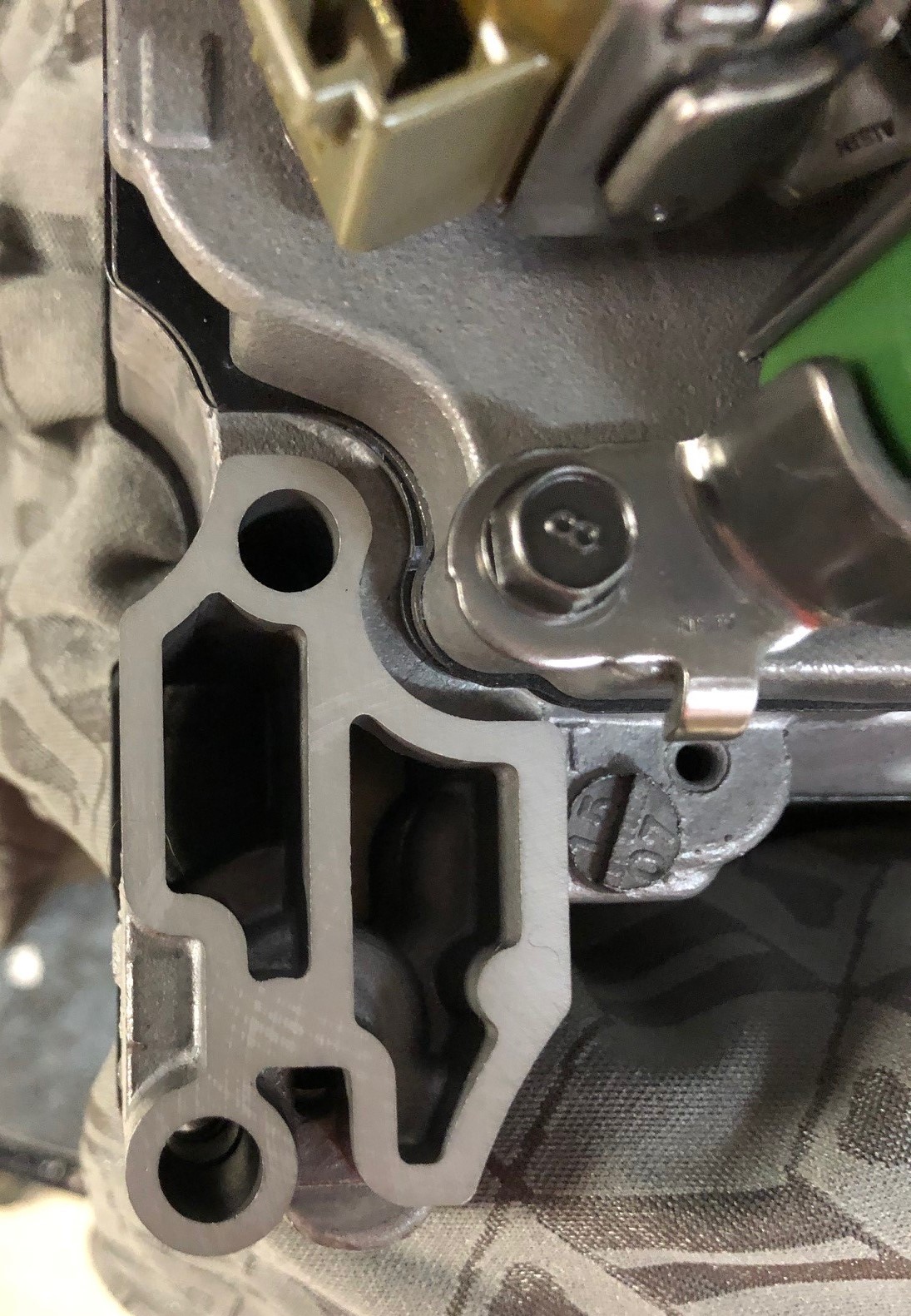

In the hopes some member tries it, I pulled out an old valve body to take some measurements. Attached is a sketch of the post and a description of what I think may work.
First is an actual picture of the port. This is a trace of the port. I think that one could fashion a plate, affix a fresh transmission fluid supply inlet port, and push fluid into the system and have it drain out the drain port nut. Looking at the trace one would cut a piece of stiff metal or plastic 2.5cm x 7cm to serve as the cover. What is important is the gasket and mounting holes not so much the plate. It can be a rectangle, but the two attachment holes must be exact, and the inlet port fully covered. With these dimensions there will be over lap, but it is fast and simple. It can be trimmed to size if one wants.
Using the two bolts that hold the port cover on will secure it, a washer or two may be needed to prevent the bolts from bottoming out. This could ruin the valve body so take note. Sealing the cover will be by gasket, which will have to be hand traced. The original port cover should provide a good source for the trace dimensions. Describing what is going on, the dark purple outline with purple and orange hash marks, would be a paper gasket one would have to cut. This is to seal the system so pressurized fluid could be forced in. In the gasket area, is a 10mmx10 mm square where the fitting would be attached, denoted by blue hash marks. This is a size limited spot - maximum width on one side is 10mm - the other side has plenty of space. The depth would permit a fitting to be sealed with a nut. The fitting has to be towards the top of the valve body as depth is limited on the lower end. You will see this in the picture. I think a 3/8" fitting could work, but wonder if it can pass enough fluid. Depending on skills and material, one could weld something on and create a larger inlet.
Just some ideas - I want to see someone attempt this. Even if it is a fail, it could still be used to flush debris from the drill method.
