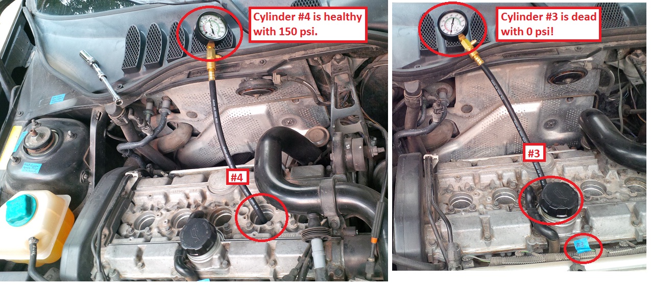

- The Compression Tester Gauge arrived. It is INNOVA 3612 Compression Tester; about $23 on amazon etc. with good reviews.
PROCEDURE:
- D/C Fuel Relay.
- Removed all 5 spark plugs.
- D/C Ignition Wires
- Crank with Throttle Opened.
FINDINGS:
- Cylinder #1: ~150 psi
- Cylinder #2: ~135 psi
- Cylinder #3: 0 psi
- Cylinder #4: ~147 psi
- Cylinder #5: ~150 psi
- Poured some engine oil into Cylinder #3, still 0 psi. So burned Exhaust Valve is confirmed.
- Asked my 18yo son, on the way to Kansas City, he filled with Octane 87 b/c it was the cheapest. I didn't want to make him feel guilty b/c over the last 20 years, I have filled my many cars (even brand-new) with Octane 87 with zero issues.
Currently, I only use Octane 91; when stuck I use Octane 89, but not Octane 87.
So, my options are:
1. Sell it to some talented Volvo enthusiast since the car has so many new parts.
2. Donate this to the refugee family (I sponsor a few refugee families a year).
Technically speaking, per rpsi, one can drive it like this for 100K miles LOL (I already disconnected the connector to Fuel Injector #3).
3. Keep it as a "junk 2nd car" in case my daily driver breaks down.
4. Or wait until I have some precious time and rebuild the head with new Valves and Seals.
5. Or ask one of the guys at the local Volvo shop to see if they want to do this for me at home for extra cash.
6. Where is rpsi when I need him LOL?

I drove as fast as 75 mph with my burnt valve. Long hills is what concerns me. Spoke to a guy a few days ago that said that he'd been driving around in his 960 for 2 years with a burnt valve. Up and down the east coast. lol

Yeah,
I already d/c the electrical connector to the Injector #3.
At idle it is rough but not stalling. On highway, I can tell the power is about 85% of what it is used to be.
Not bad, I can live with it for now.
This has been an interesting experience...Bought the 1998 GLT with 145K miles 5y ago (Fall of 2012) for about $2300.
Over the last 5y, I have spent about $2700+ on parts, labor was mine of course. Many hours spent on: front suspension, rear shocks, heater core, rebuild heater hoses, rebuilt trans hoses, Oil Cooler Tstat, Front wheel bearings x2, brake jobs, rebuild brake calipers, lock actuators, fuel door fix, igntion tumbler FREE fix (removing bottom plate), timing belt/WP/Tensioner etc., Serpentine Belt/Tensioner, AC Pulley bearing fix etc. etc.
Looking back, I might have been better with a "$5000 car"; something like a 2005 S60 with 100K miles, this way I didn't have to fix the items mentioned above. Next time, I will be smarter and buy a "$5000 car"...LOL.
I wish the valve didn't burn, this way I can keep the car forever.
