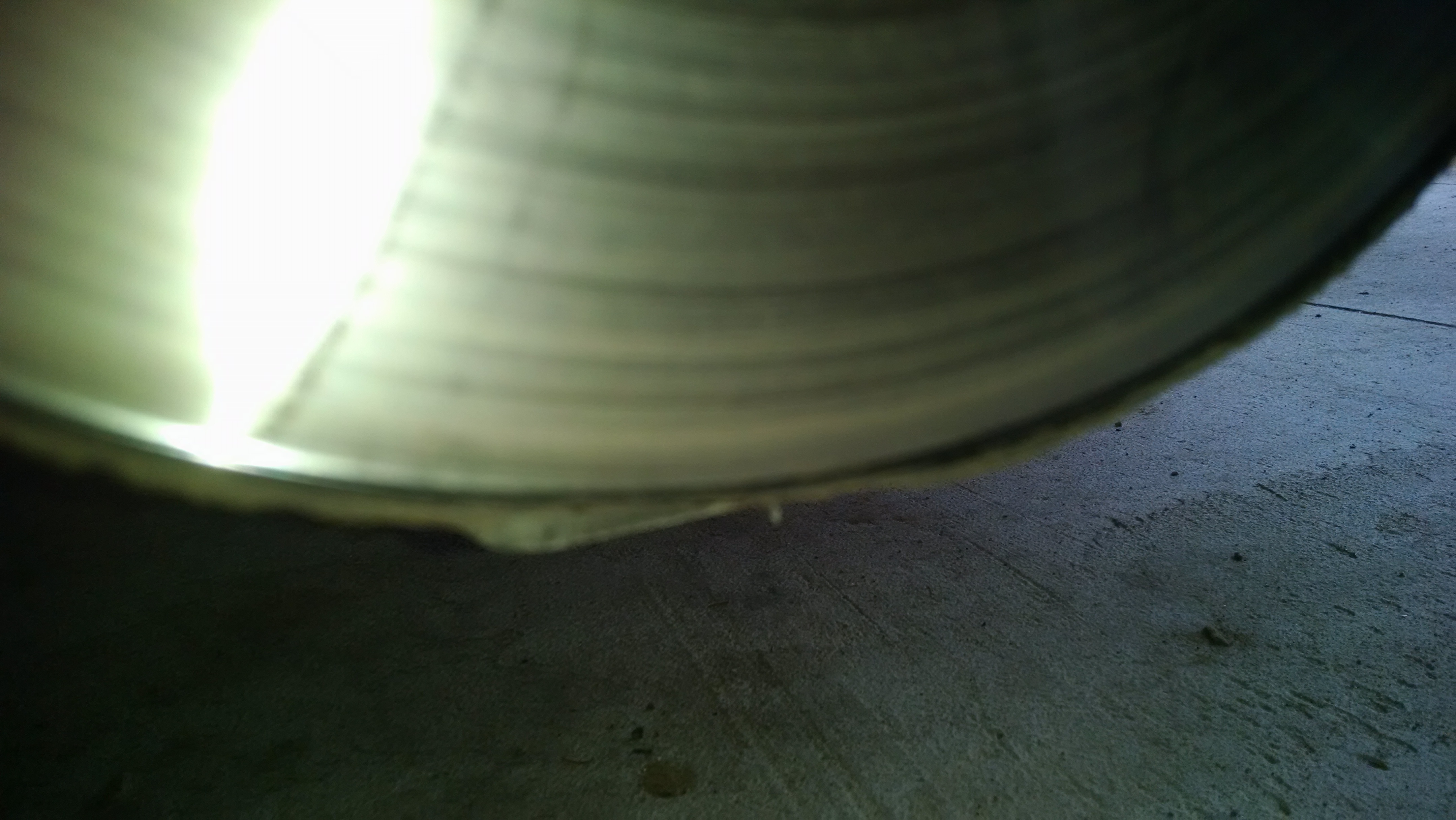

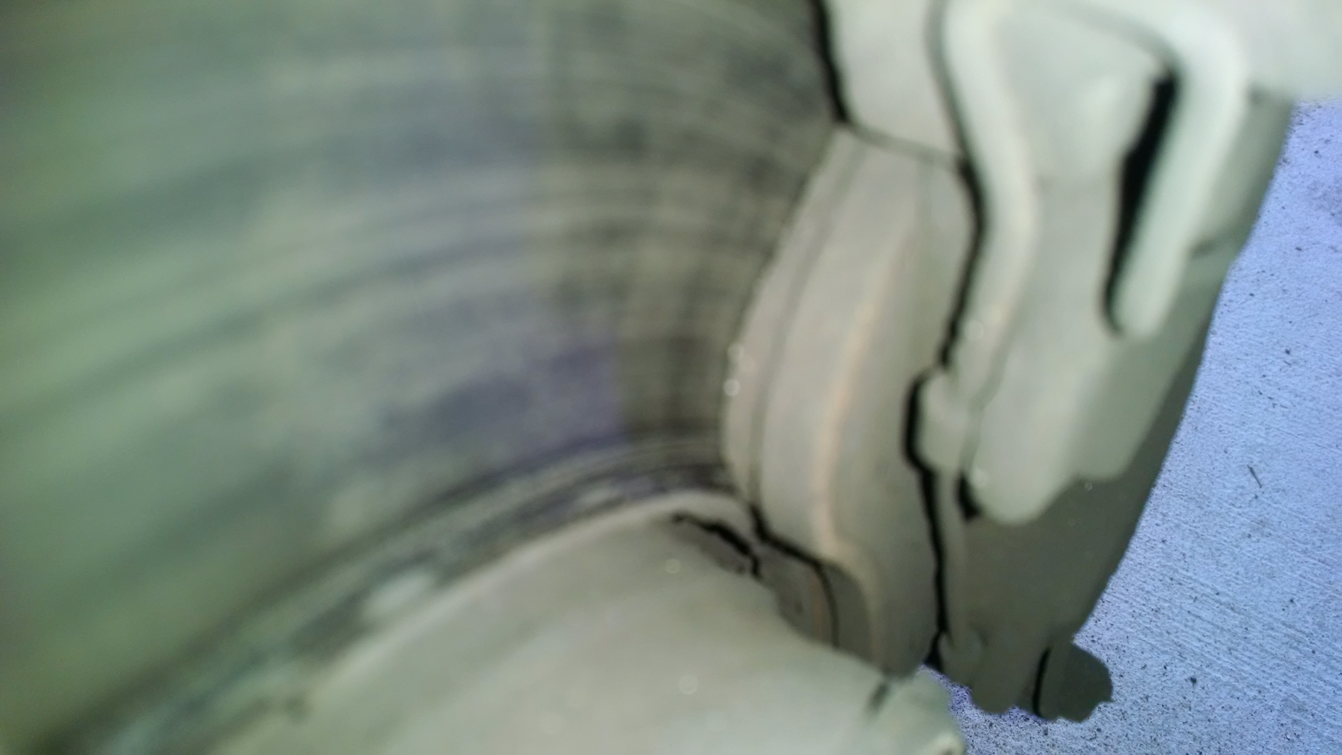

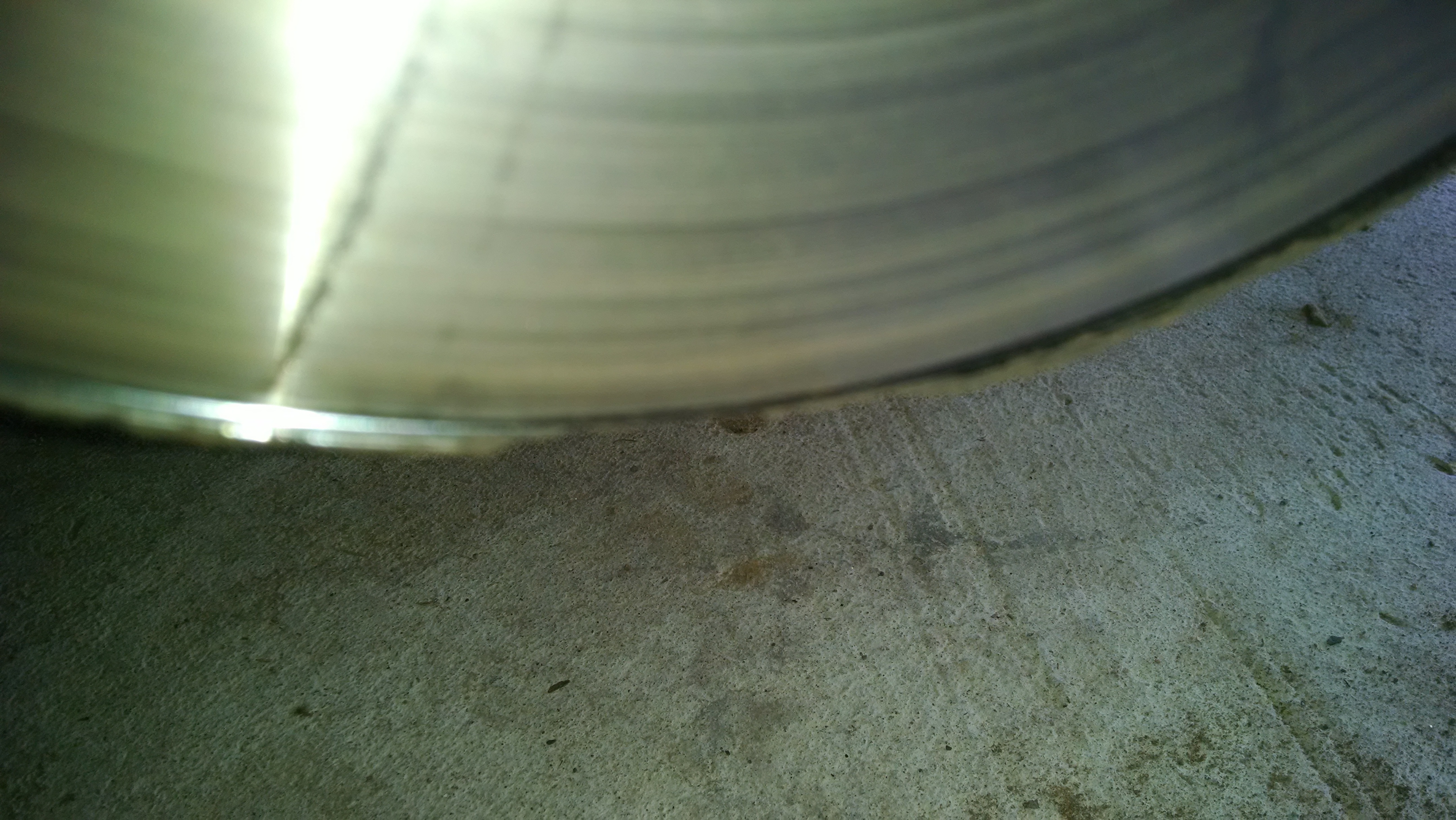

Front right:
I took 4 measurements with the calipers, all slightly different. Rather than uneven wear, I think it's just the caliper.
Average rotor thickness 24.74mm (absolute lowest reading was 24.62mm)
Pads need doing as they are squeaking but look to have a bit left.
There is a little ding in the outer edge of the disc on the bottom in these pictures - anything to worry about?
Pictures attached.

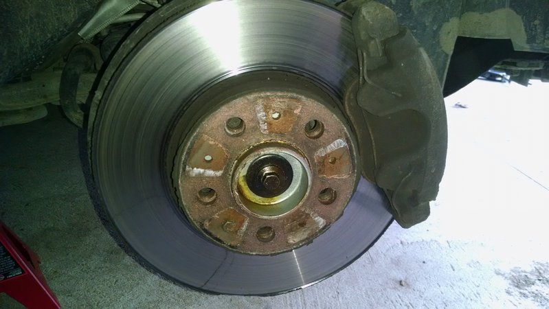

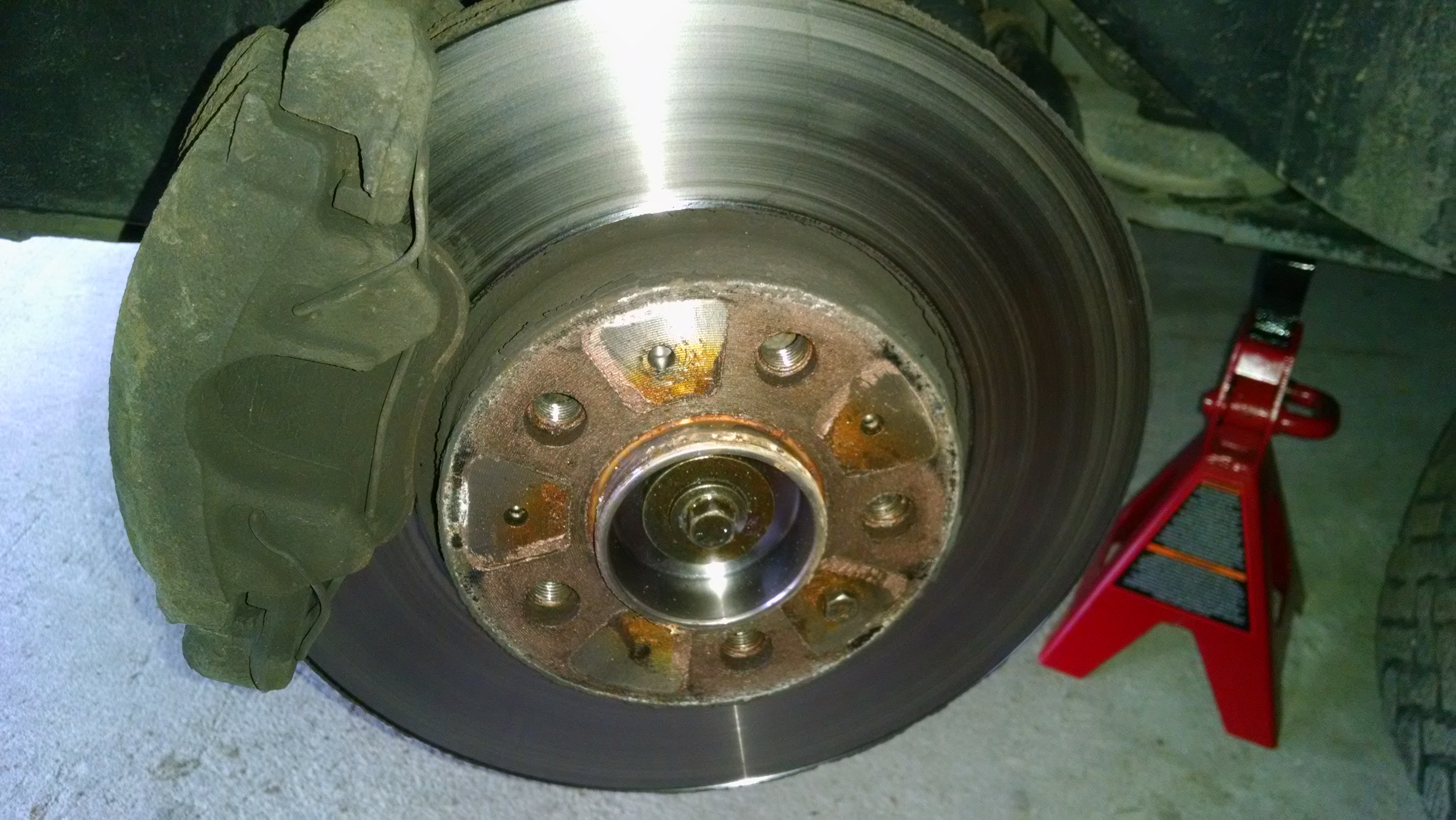

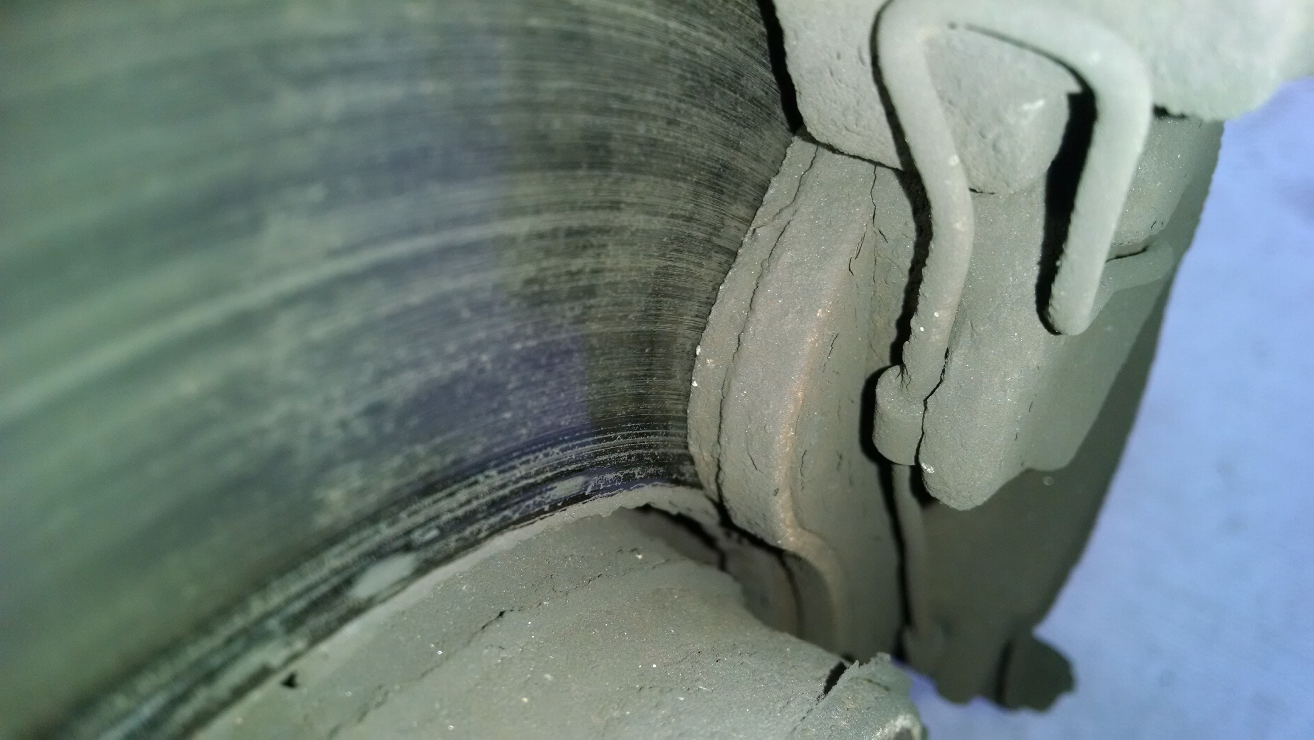

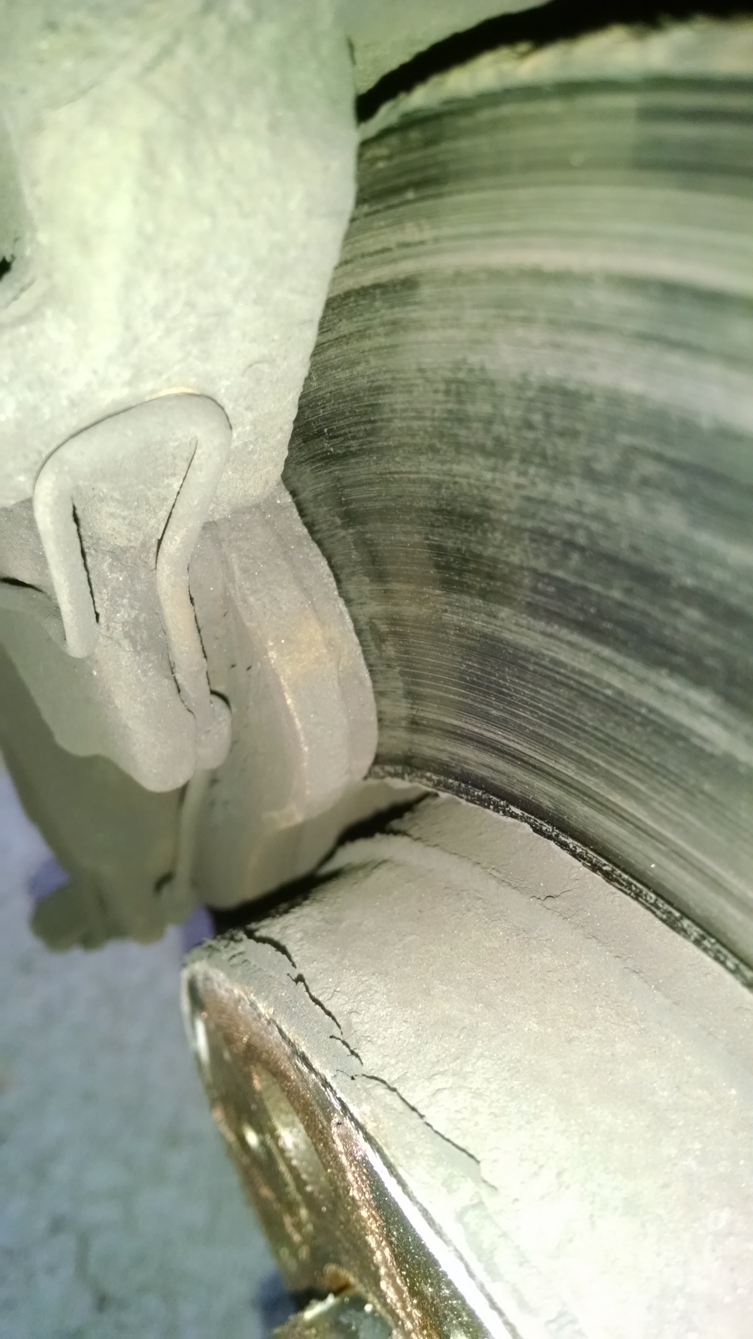

Front left:
Average rotor thickness 25.065mm (absolute lowest reading was 24.64mm)

Instead of replacing the pads because of squeaking, just switch the left and right rotors so they turn the other way. Give rotor in pic#4 a good sand near the center lip
