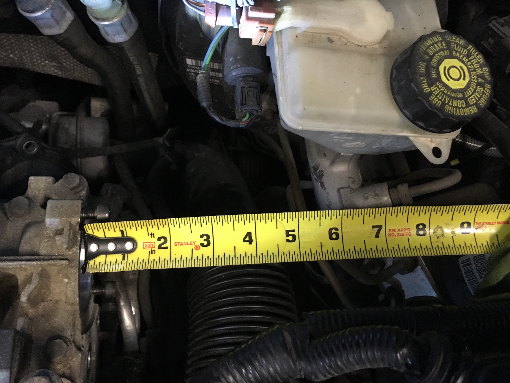

There's about 6" of free space from the head to the ABS lines below the master cylinder to fit a drill in. Might have to get hold of a short case or 90º drill. The turbo hose and all that will come out of there.

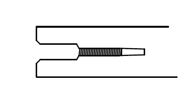

Here's a fairly accurate view of the situation. This is a section thru the camshaft CL. I love the brass bushing or sleeve idea, but it's not going to help here. In my current view, the only resistance to backing this out is how jammed the bolt threads are at the tapering end of the threaded bore.
