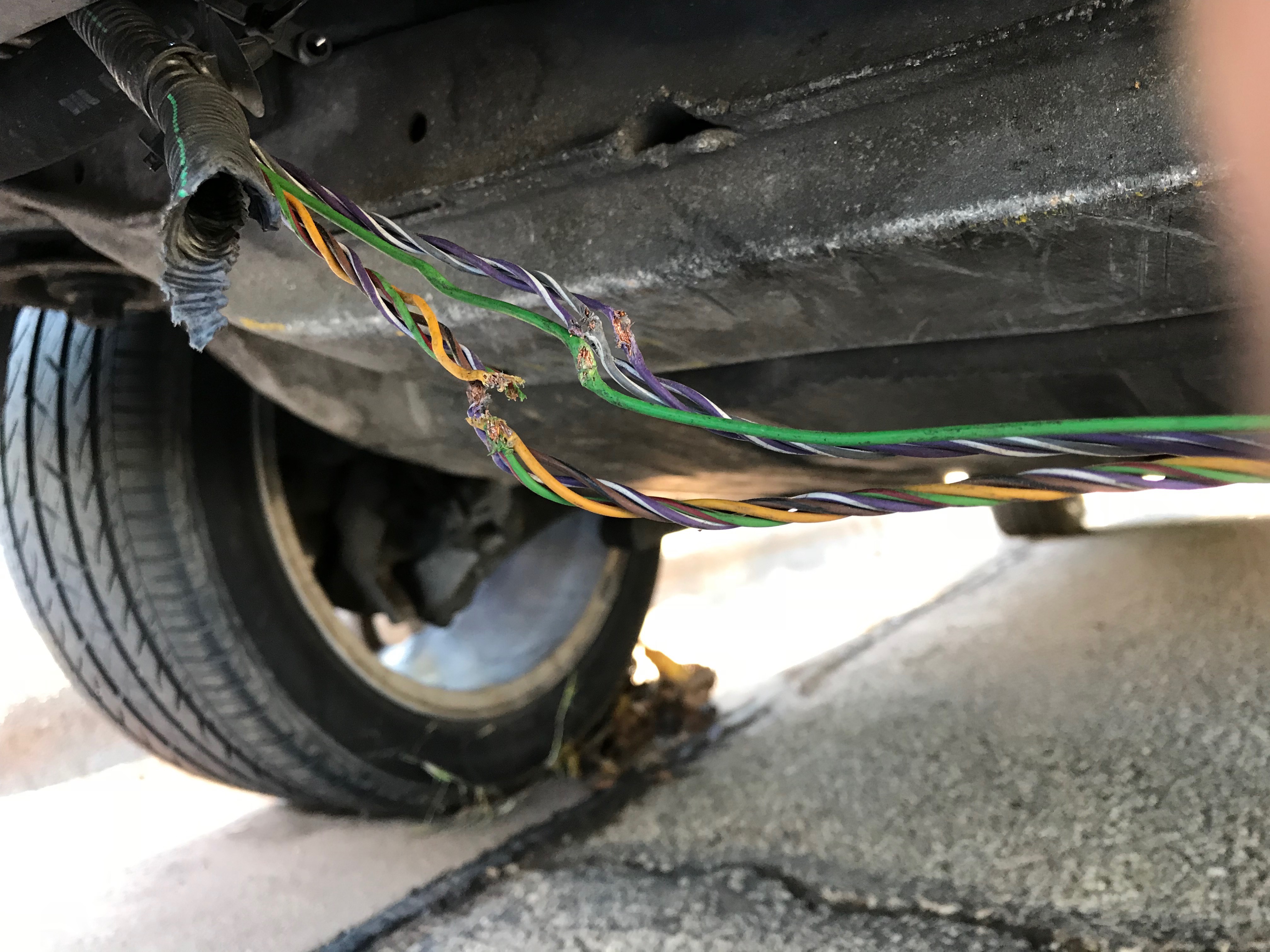

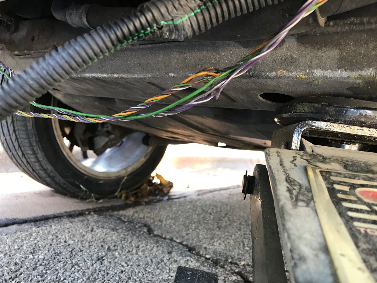

I went out to eat one night and bumped the curb at the front of the parking place. The curb hit the front of the crossmember, but didn't hit very hard. I turned the car off and went inside. When I came back out, the engine would crank, but not start, so I called a tow truck. When he was loading it, I notice a wire bundle hanging down in front of the crossmember that had some pretty obvious crush damage. I am going to attach a couple pictures of the wires.
The bundle hanging down was a plastic loom with eight wires in it, twisted into two strands of four wires each. All had suffered damage. Some had been completely severed, as you can see in the pics. The damaged wires were definitely in contact with each other and the steel crossmember. The wires were damaged in two places each, about a foot apart. I spliced the damaged wires, replacing the middle sections of each wire with fresh wire. I'm sure I got everything joined back up to the correct wires.
