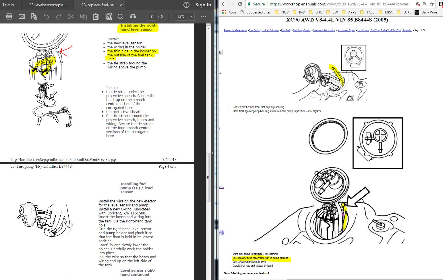

Hmmm...from Swedespeed
When you replace the fuel pump, you have to be VERY careful to avoid kinking the plastic hose. If it is kinked, you will see some of the same symptoms. I had to replace a fuel pump, and had those symptoms. Dealer foreman said maybe kinked hose. I had done the work, so had to pay to have them do it again. The hose had a slight kink when it came out, BUT, they said that could be from taking it out. The dealer warrantied the pump, it was showing up to 86% duty cycle, and the engine would cut out. I sent them screen shots from VIDA, and the fuel pressure clearly would drop by 1/3. Seems to have happened more when turning a corner, but it happened often enough that they knew what to look for. Volvo never blinked on warranty claim, the dealer was very careful to document it, and they know me, and know I can do most of the mechanical work on my car. I just didn't know if I kinked the hose or not, but the kink wasn't enough to cause a problem, if I had done it. Sometimes, the hose is kinked so bad that it hardly flows fuel.
When you remove the pump, you have to try to swing the hose end so that it move almost at the very front edge of the tank, or else it hits a low spot in the tank, and gets kinked. Same for installing it. Use a wire connected to the driver side end when you pull it out, and then use the same wire (which was left in the tank) to pull the pump back in, but make sure the hose end is moving in a curved direction along the front of the tank. If you got straight across the center of the tank, guaranteed to kink the hose.

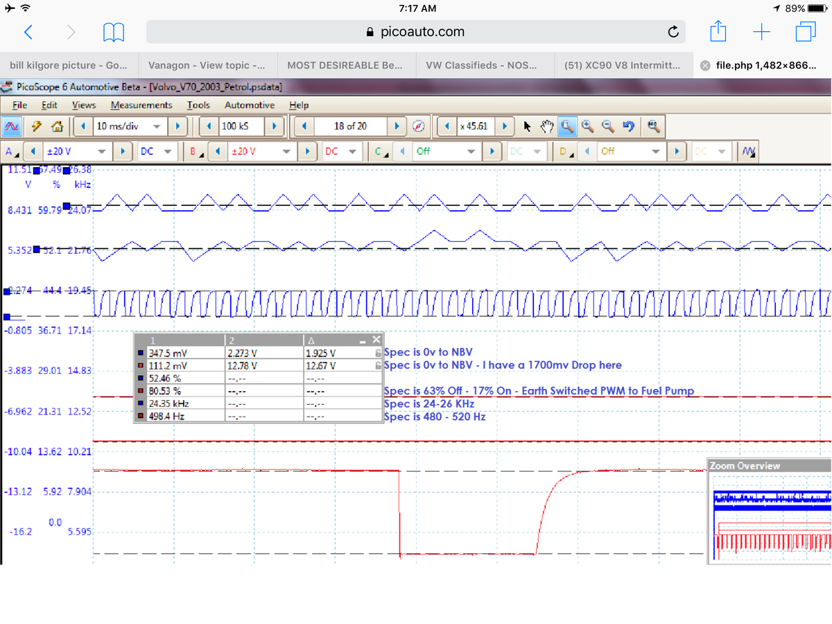

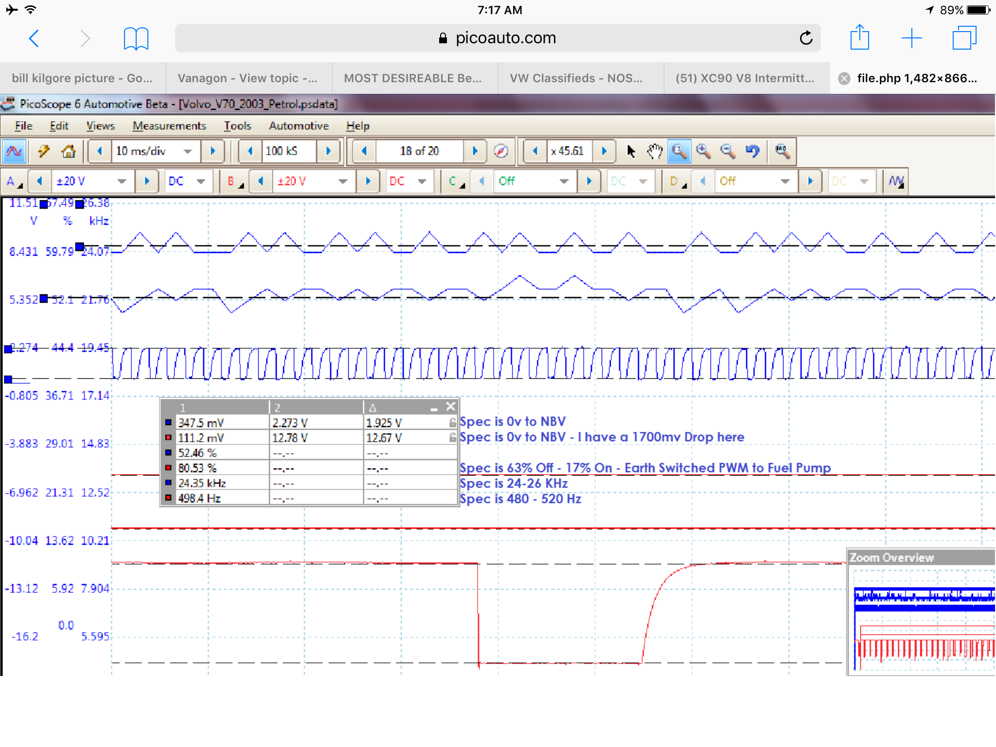

Shockwave...found this crawling the web, unverified
Link
https://www.picoauto.com/support/topic14491.html
Waveforms if ECU and PEM to drive pump
Link

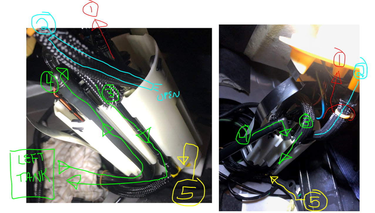

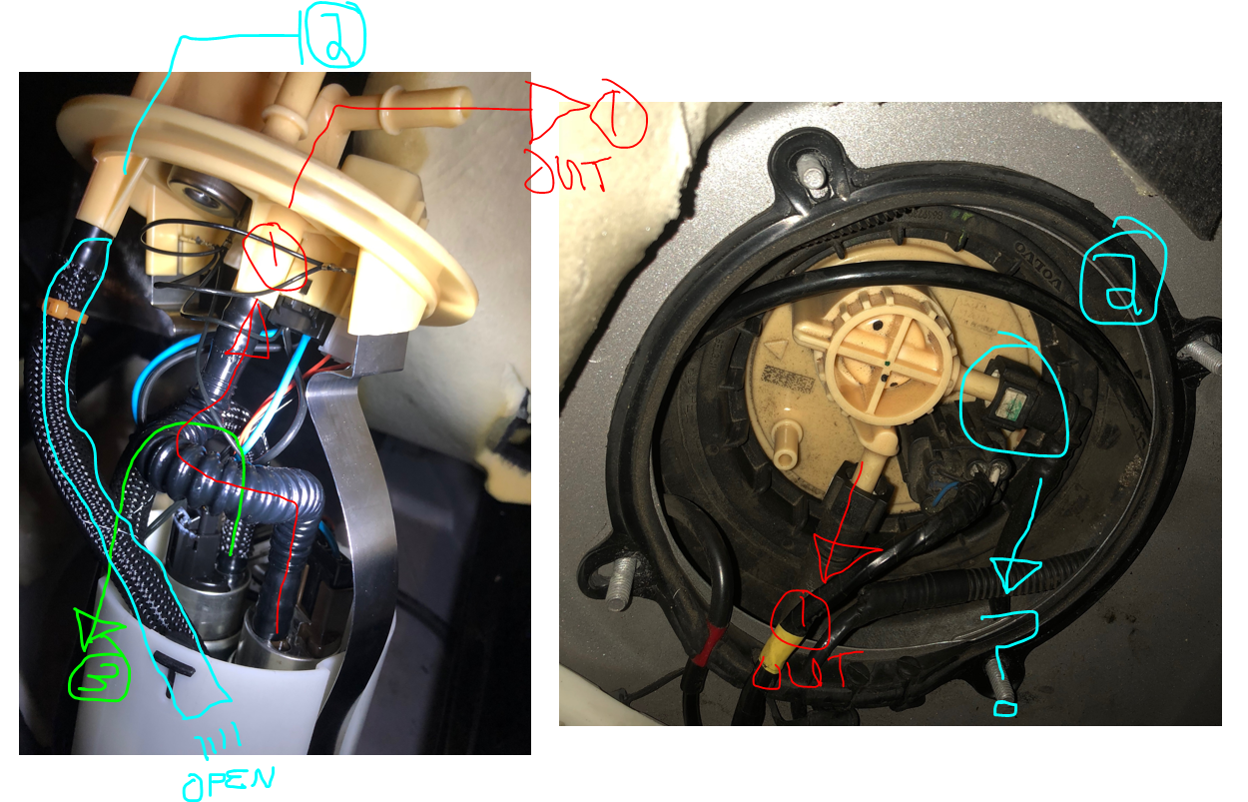

Ok, so finally got to it this morning (4:30-6am). No rats in the tank. Everything looks fine except for one thing. The return hose (4) from the left side tank looked to be out of position (not in it's channel). I inspected this before getting the pump all the way out so as not to have the pump removal disturb any root causes. Once I had the pump out (not fully as it seems to be enough to inspect without pulling the hose all the way out from the other side), I took MANY pictures, but I couldn't see any other obvious issues. Very small metal particles in the bottom of the tank, but only maybe 5-10 that I could see (left side).
Now, do I pull the hoses off the assembly and check them for obstructions? or could it be that the "return" hose (4) being out of position is not filling the reservoir? I imagine it sprays and the reaction force pushes it farther out of position so it overshoots. Then the reservoir does not get filled up. I fitted it back in it's channel on the outside of the reservoir, but it comes out easily if I gently fiddle with it. Maybe it needs to go all the way down so the elbow is just over the top. I didn't have time to see if the elbow was too wide for the channel/retainer, but it seemed like it was only wide enough for the hose and no the bottom of the elbow...I'll have to tie a wire around it to keep it in place I guess...Anyone know the nominal position of item (4)?
NOTES:
1. What is item (2)? It has an open end in the reservoir and an outlet on top. Where does that outlet go?
2. Gas gauge was at 1/4 tank before starting. I siphoned out the left tank and got about 4 gallons. That seems too much on that side. I did not siphon the right side, but it looked as full as the left.
3. What is item (5)? Seems to be a check valve...
4. I'm still not clear on the fuel transfer operation (viewtopic.php?t=60022). How does the pump reservoir stay full once the left side is emptied? Does item (2) perform that function via a siphon type operation? I'd guess that item (2) terminates at the bottom of the RH tank. But that means there are essentially 3 pumps...
NOTES:
