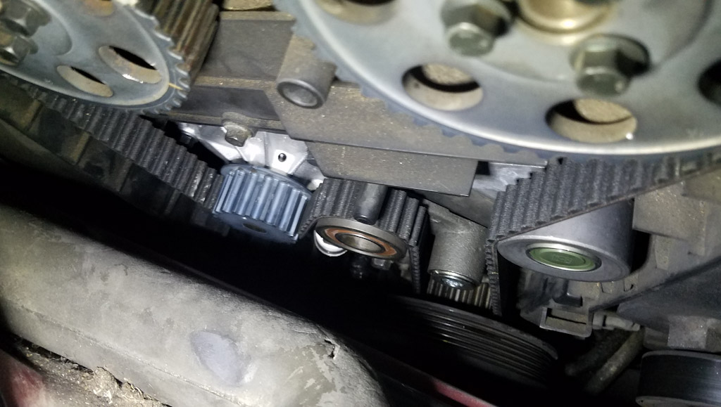

You kind of lost me there, should it be CCW?. If I can get a partial tooth onto the water pump I might be able to turn it over and roll the belt onto the water pump.erikv11 wrote: 18 May 2018, 16:54 You can "cheat" the cam sprockets 1/8 of a turn clockwise to keep the belt tight on the right side, then put the belt over the water pump last as suggested.

The idea is you may be a tooth short when you get to the water pump, because the belt is not actually tight on the right side of the path. So to make sure that is not the case: Start with the belt seated under the crank, pull it tight up the right side to the intake cam. Keeping the belt tight, if you can't get it over the sprocket (which is common), then cheat the sprocket CW just a bit, less than a tooth. That's a mistake in my post - should say 1/8 of a tooth, not 1/8 of a turn. Do the same on the exhaust cam.
When the belt is really hard to get on, often it is because it is not actually seated under the crank. That little nub under there is a PITA.
I would never crank the engine to seat the belt. Turn the crank with a socket maybe, but not with the starter. But it shouldn't be needed. Just to make sure, you didn't yet release the tensioner pin, right?

That makes more sense. I would also never crank the engine at this time. I was referring to rotating the crank shaft with a socket CCW 1 tooth then pulling the belt and turning the crank shaft CW 1 tooth ti take up the slack while remaining on time.erikv11 wrote: 19 May 2018, 08:04 The idea is you may be a tooth short when you get to the water pump, because the belt is not actually tight on the right side of the path. So to make sure that is not the case: Start with the belt seated under the crank, pull it tight up the right side to the intake cam. Keeping the belt tight, if you can't get it over the sprocket (which is common), then cheat the sprocket CW just a bit, less than a tooth. That's a mistake in my post - should say 1/8 of a tooth, not 1/8 of a turn. Do the same on the exhaust cam.

Success! Definitely an involved job but doable. That perfect crank and startup on the first try was beautiful to hear. I must admit as bad as the belts were, I had more trouble with the crank gear cover plate than anything else. I found that zip tying the belt to the cam gears and turning the crank 1 tooth CW gave me just enough slack to slip the belt over the water pump. Now onto fuel tank vent hoses.
