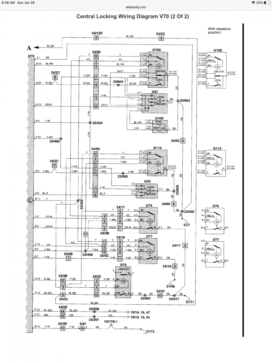

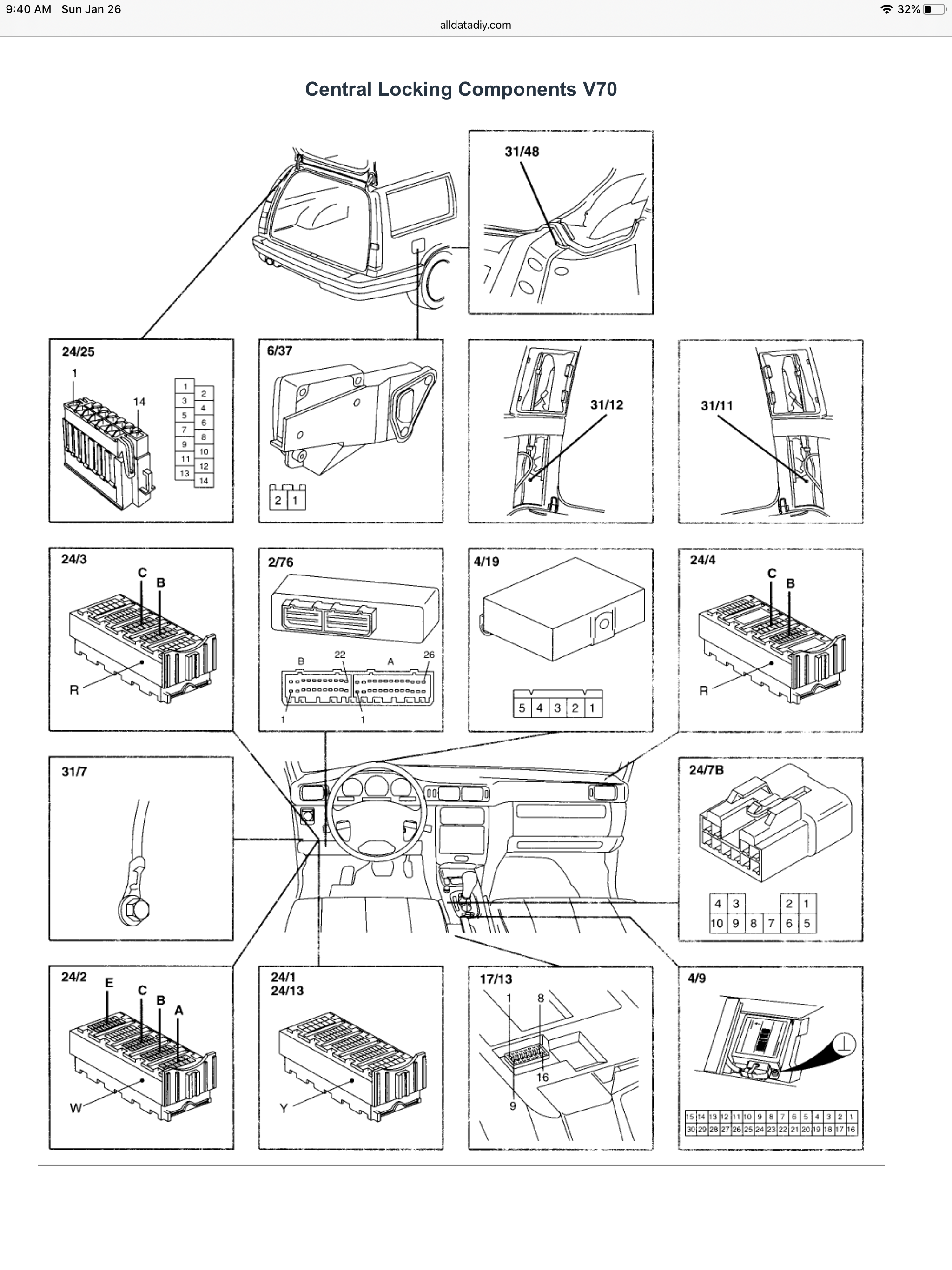

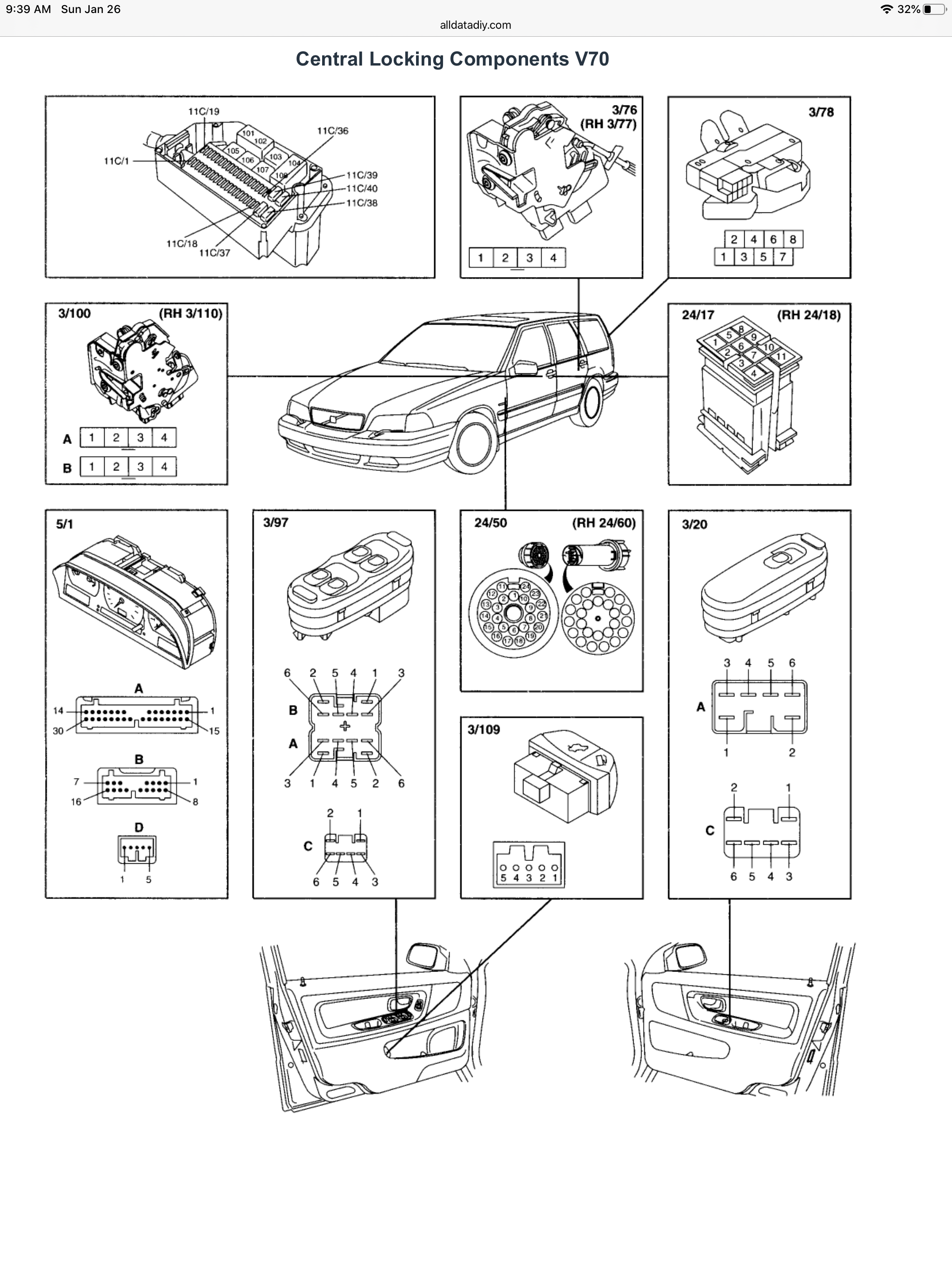

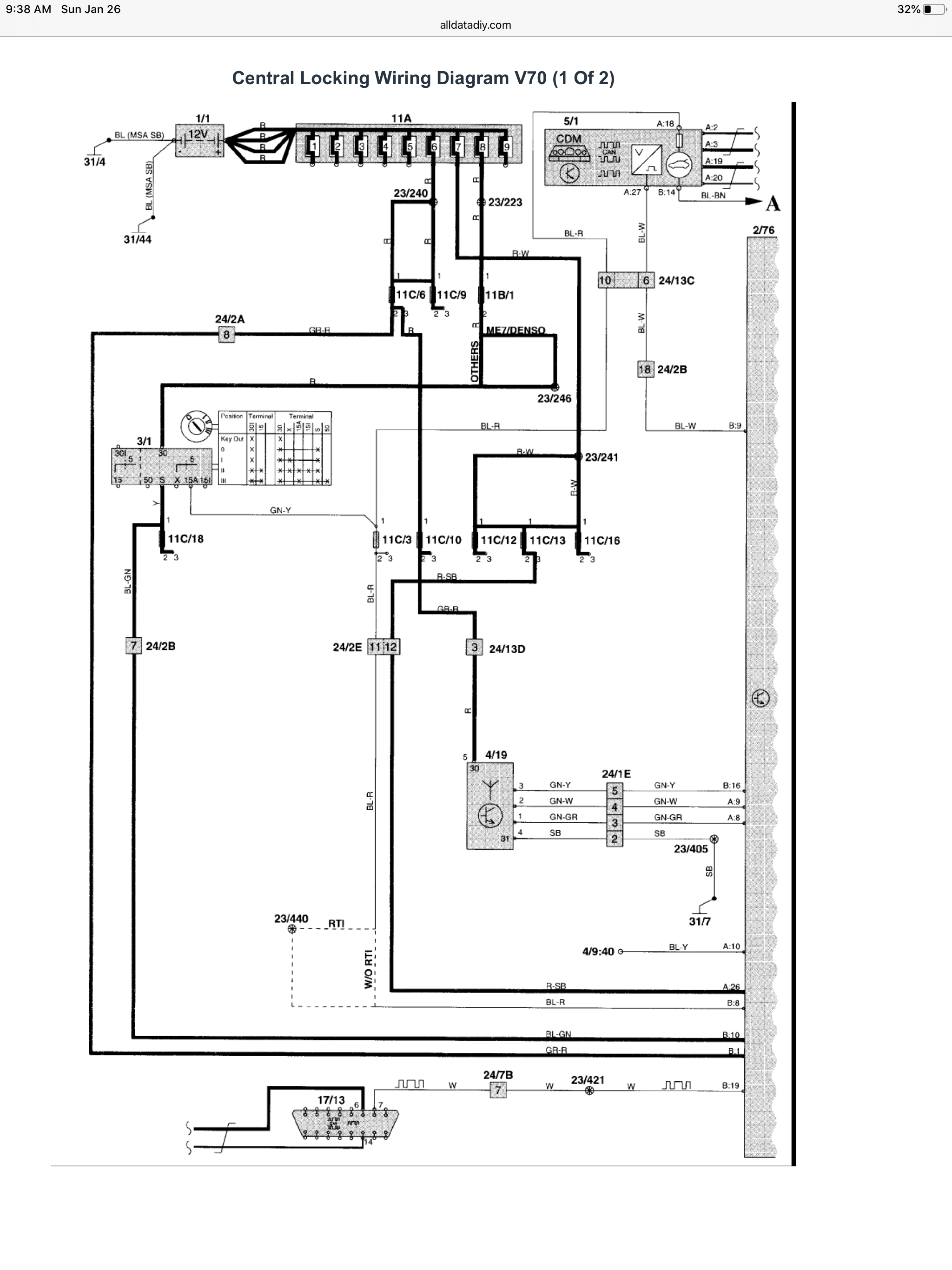

Adding the lock diagrams to thread for troubleshooting
Posts: 36147
Joined: 17 Feb 2013, 17:54
Has thanked: 1610 times
Been thanked: 4065 times
