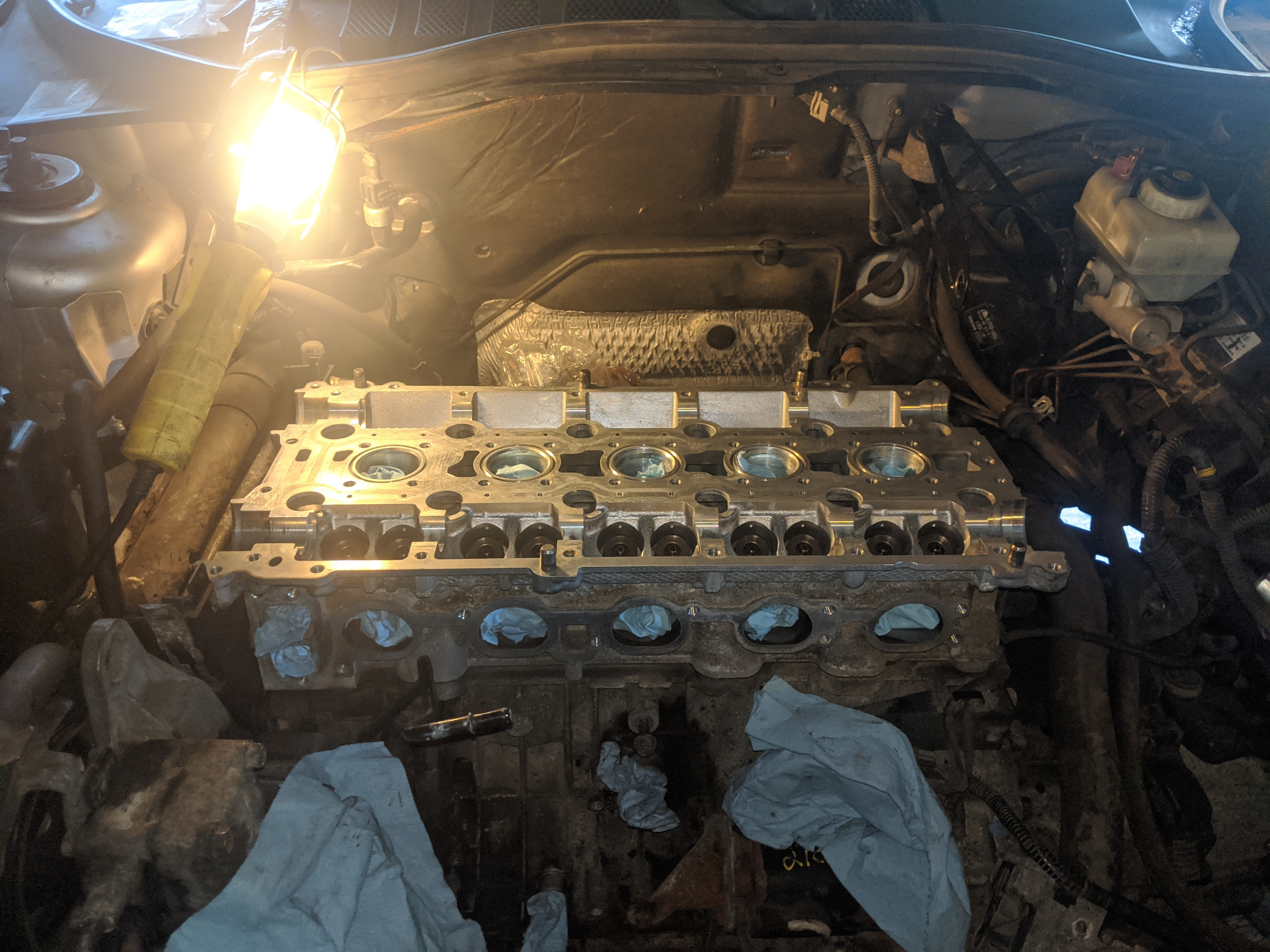

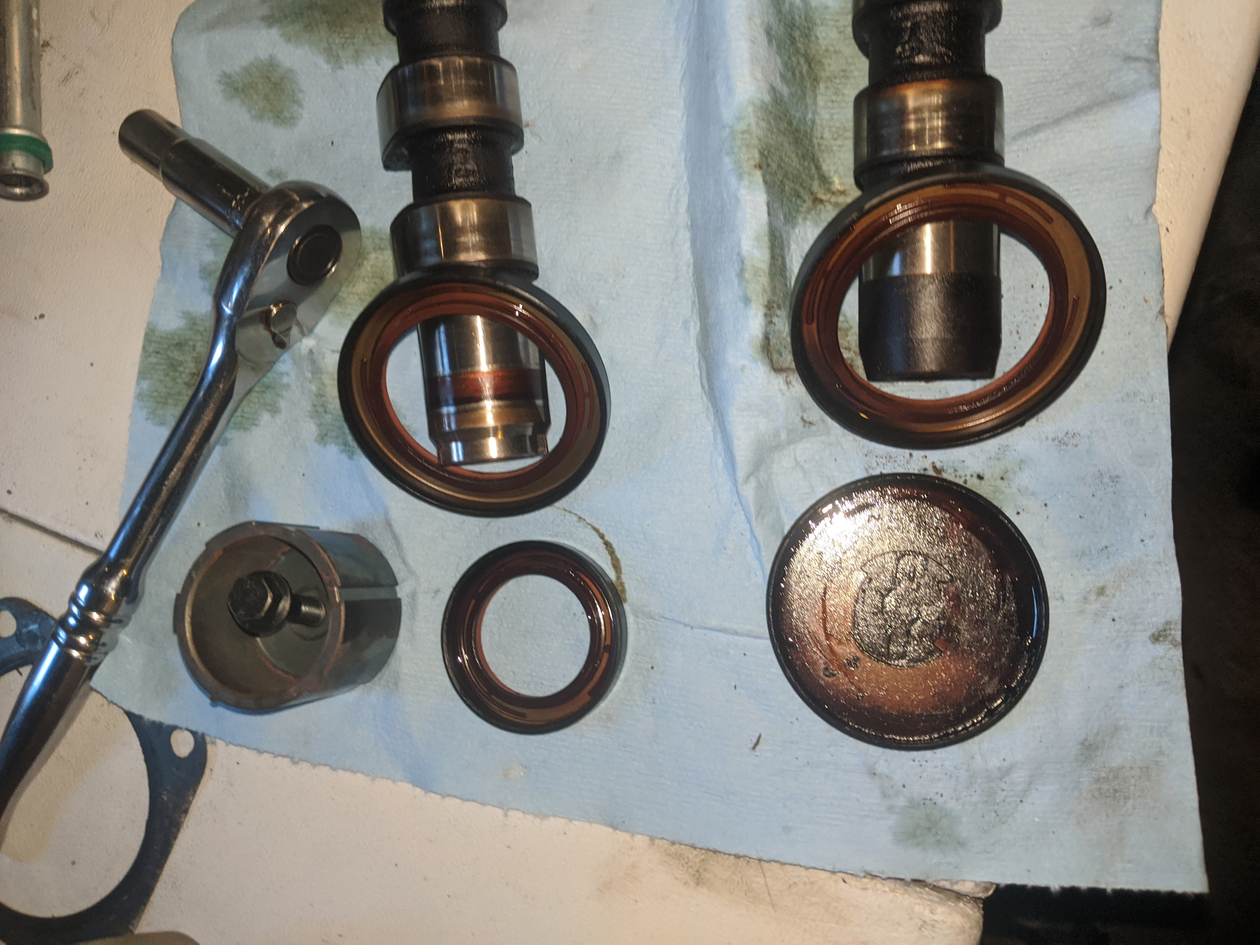

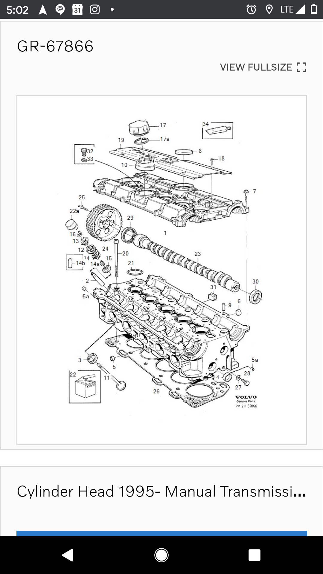

Getting pretty close, the head is all torqued down and I'm just working on getting it ready for the cam cover. I think I'll wait on the anerobic sealant until tomorrow as it should get up into the 30's. I realized my FCPeuro timing belt kit did not come with the right number of cam seals (im guessing it was put together for a vvt engine). In this photo, is this the right number of seals, or should there be one more small one for the exhaust? I can't remember if there one one more small one. The non-vvt diagrams I'm finding only show one cam, so I was assuming i needed two front, two rear and the cap for the side without the cam sensor?
