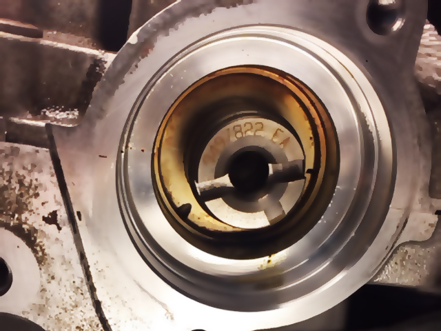

I was looking through my timing belt notes from 2012. Timing belt, serpentine belt, water pump, and all associated components were replaced during the DIY servicing event. It has close to 8yr/70,000 miles, and reaching Volvo recommended range for timing belt service.
Although, I had replaced the rear exhaust camshaft sealing ring during the PCV and oil pan service a year ago, I'll order the sealing ring pn 9943310, and have it at hand. Also, adding VVT cam solenoid gasket pn 30731212 to-dos.
I agree, it is best to service oil pump with the service kit during this 200,000 miles challenge. The success of this DIY is tools and taking time to do it right.
VIDA says, sealing ring for intake without VVT cam is pn 9440651.
Is it better to just replace the engine crankcase pulley with new to eliminate any what if?

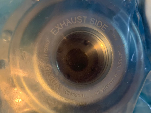

INA makes this exhaust pulley.

Yes they are. Did you get it through FCP?
I meant to write this a while ago. Don't be like me & forget to acquire the rear intake camshaft plug! You will not be able to finish the job without it. Also the rear intake cam does not need to have a seal + the plug. Just use the plug.
https://www.fcpeuro.com/products/volvo- ... 90-1397381
- OR-
https://www.fcpeuro.com/products/volvo- ... ng-1397381
Really, all you will need to replace is the rear exhaust seal, rear intake plug, front intake & exhaust seals, then your crank seal/o-ring/gasket. Make sure to use some sealant on your oil pump bolts (under heads & threads nearest heads).
I finished my 01 2.4T a few days ago & thought I'd list the cam seals I used. I skipped the oil pump reseal seeing as this entire job was done on mine 20k ago, and the crank seal/oil pump were dry as a nuns bush.
Here's your VVT front exhaust cam seal
Here's the front intake (non-VVT) cam seal
Here's the rear exhaust cam seal
Here's your rear intake cam plug Volvo and Aftermarket
Did you get a cam locking tool? If not, mine is free for the taking now that I'm done with my task.
