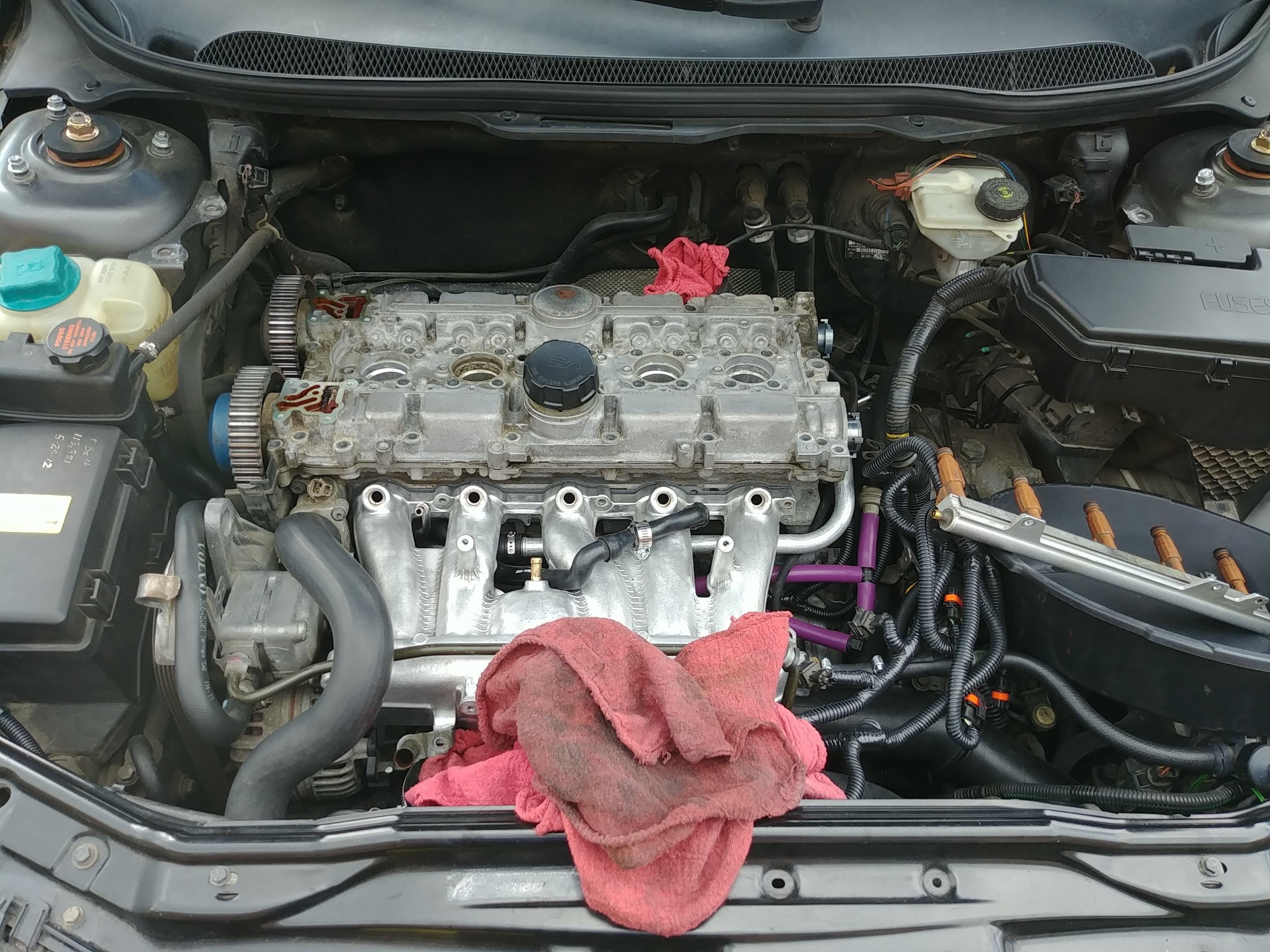

Today I got oil and coolant drained. I have the air intake, fuel rail, intake manifold and timing belt off. I have my intake and exhaust cams marked and all the head bolts off. Need to order new solenoid gaskets.

Ty..are you taking off the valve cover for some reason? It seals with no gasket so you don’t want to move those M6 bolts unless it’s coming off. You need permatex anaerobic sealer and 5 new spark plug o rings if it leaks.
Dual VVT...COOL. read up on resetting valve timing carefully , you have plenty of tolerance +-4 teeth for damage but only one tooth tolerance to an engine code

Good info. If im honest I have no clue how to fully remove the head. I watched someone on an older model but it isn't the same. And I don't see anything on how to remove the whole head so im just diving in. I have the intake and exhaust marked very carefully to put back together exactly how it was removed but I will take a look at resetting valve timing. Thank you

Could I actually asked you for a little bit of instruction as to what my next steps would be in this process. This is where I am. The Intake manifold is just hanging on by that banjo bolt. And I assume that thermostat has to come off

I will try to remember to post ViDA instructions today/tomorrow sometime. If you plan to remove your VVT’s for cam seal replacement I can loan you my cam locking tool. I assume you lined up your timing marks prior to removing the belt.
