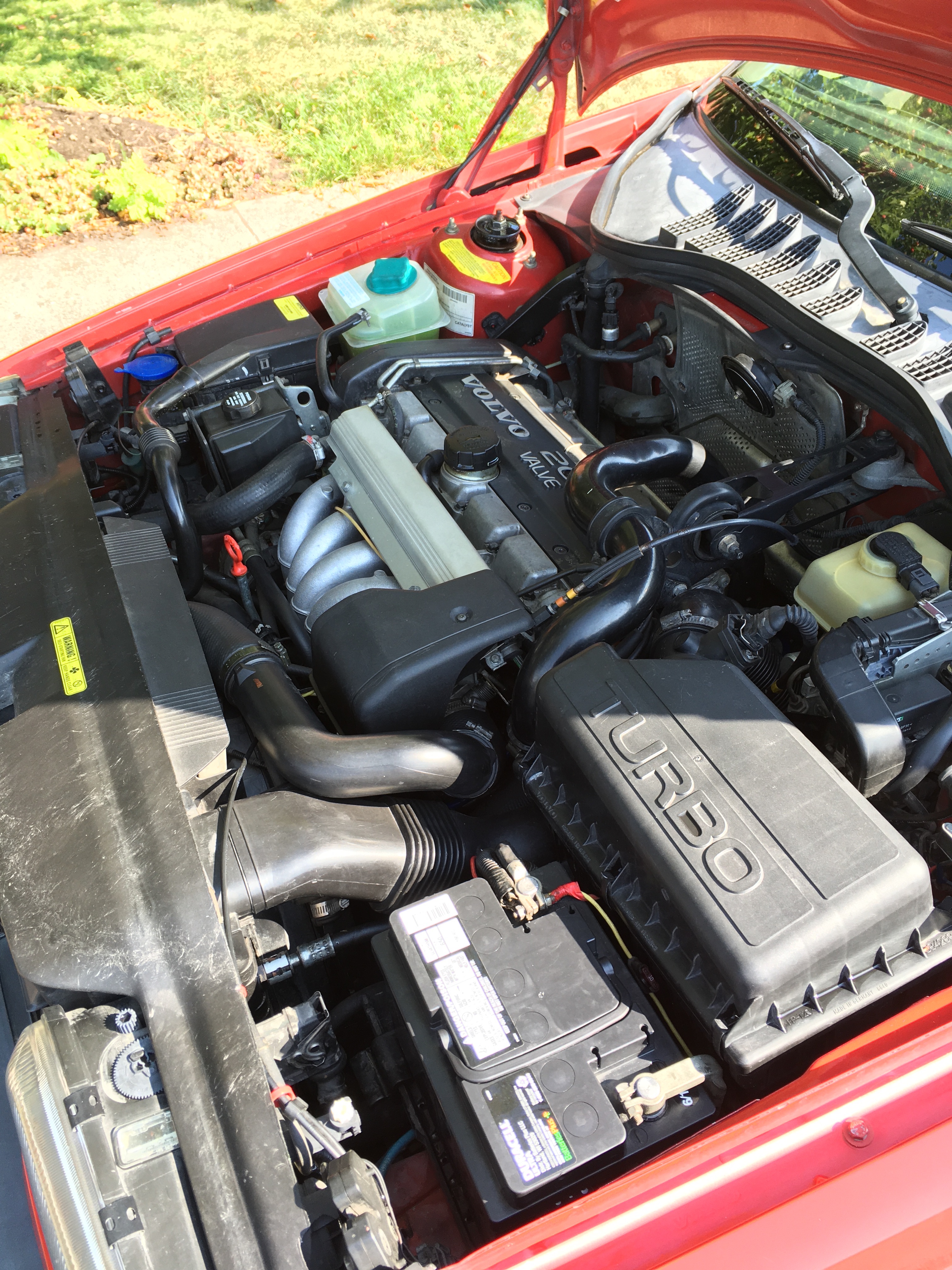

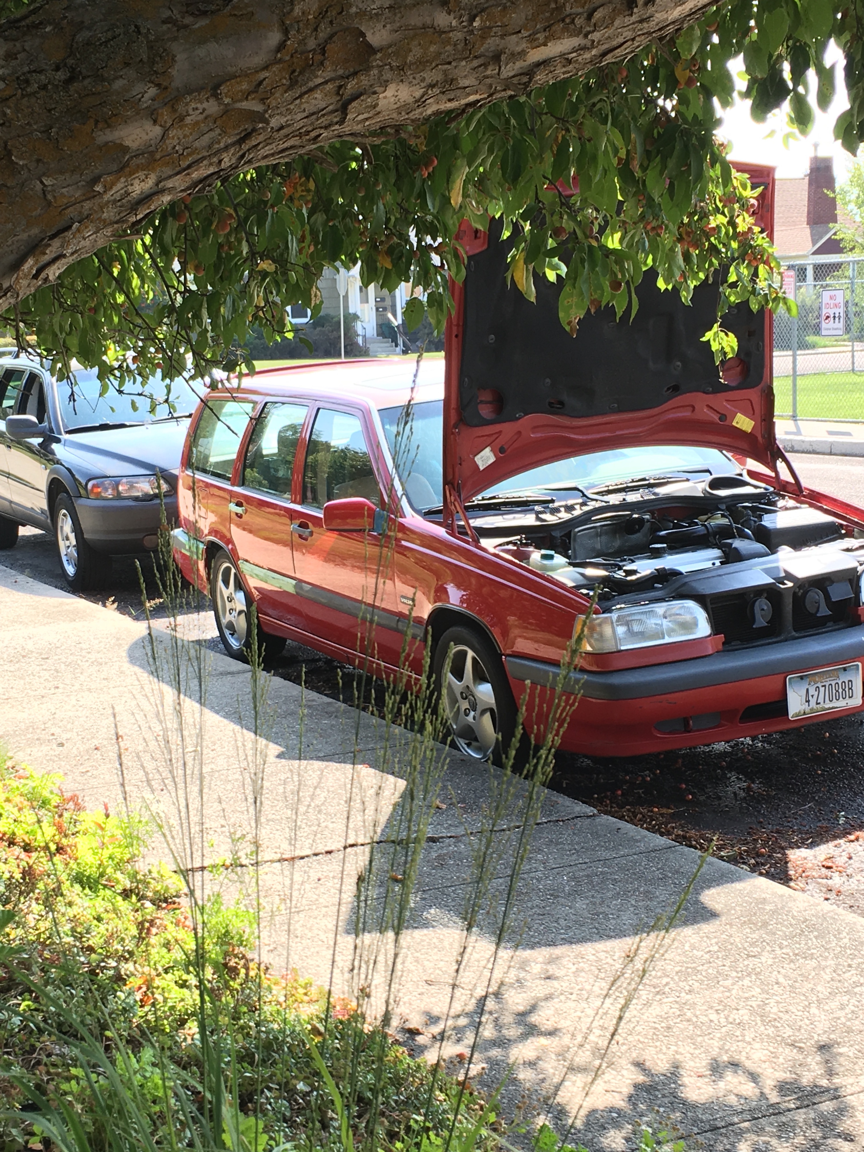

This weekend I finally got back to reviving the Red Sled, the 850 wagon. No one has driven it for many months. Gave him a good wash. Of course the battery is completely dead - only 3 years old. Read .4V...... point four.
Jumped it with Betty the P2, got him warm, smoothed out idle. Charging showed 14.4V. Pumped up a low tire with a bike pump. Idling for maybe a half hour. Headed to a local station with an air hose, topped off all tires, and headed for the freeway to give it a run and clean off the rotors. Made it to the stoplight next to the gas station and it died completely - no stumble, just OFF. Not even a click with the key. Not enough juice for the flashers even. Battery read 4.4V at that point.
Found the shift interlock to get it out of Park. Need to get out of traffic. A guy waiting in line at the corner restaurant jogged over and we pushed it into a parking area. My wife drove Betty down and we jumped it again. Headed right for the battery store and got a new one - I probably damaged this battery too much to have much life left.
So, good thing I never made it to the freeway!

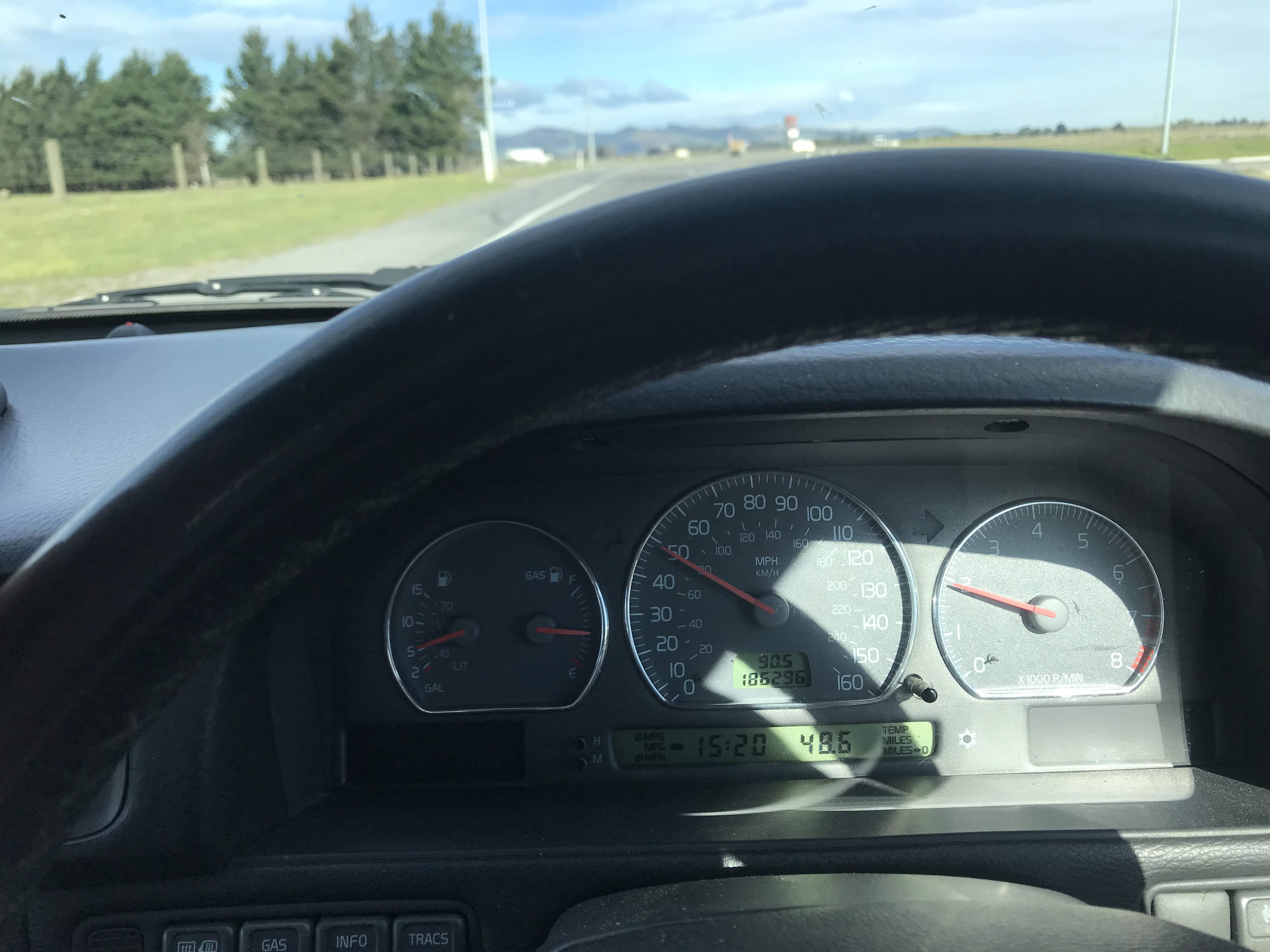

Stu, do you. Guys lose the coolant temperature gauge on the BiFuel?

Good spotting.
I imagine it to be a wonderful surprise to have no warning until the steam came out the front.
The coolant temp sensor still supply’s to the ecu, but the wiring to the cluster temp gauge is hijacked by the gas controller to show tank level. I have however (after a bit of head scratching) changed it to show temp. Also the gas switch (down to the left) used the connector usually used for the info Switch. So I had to source, from the US, a switch and connector and made up my own harness to the info socket on top of the cluster. As , in theory, you couldn’t have both.
It had other intricacies, like a proximity sensor on the petrol (gas) flap, that prevented the flap being opened when car was running, or the car starting if the flap was slightly ajar, or more annoyingly misaligned. The fill valve for the gas was beside the fuel filler.
The gas tank was removed before the car was imported, and, all the electronics and mechanicals I removed and sold back to a collector in the UK, as it was a ‘rare’ factory fit CNG as opposed to the normal LPG.
In short - yes , no temp gauge. As we bifuelers live life on the edge.

You could monitor coolant temp through obd with a Bluetooth link, too.
