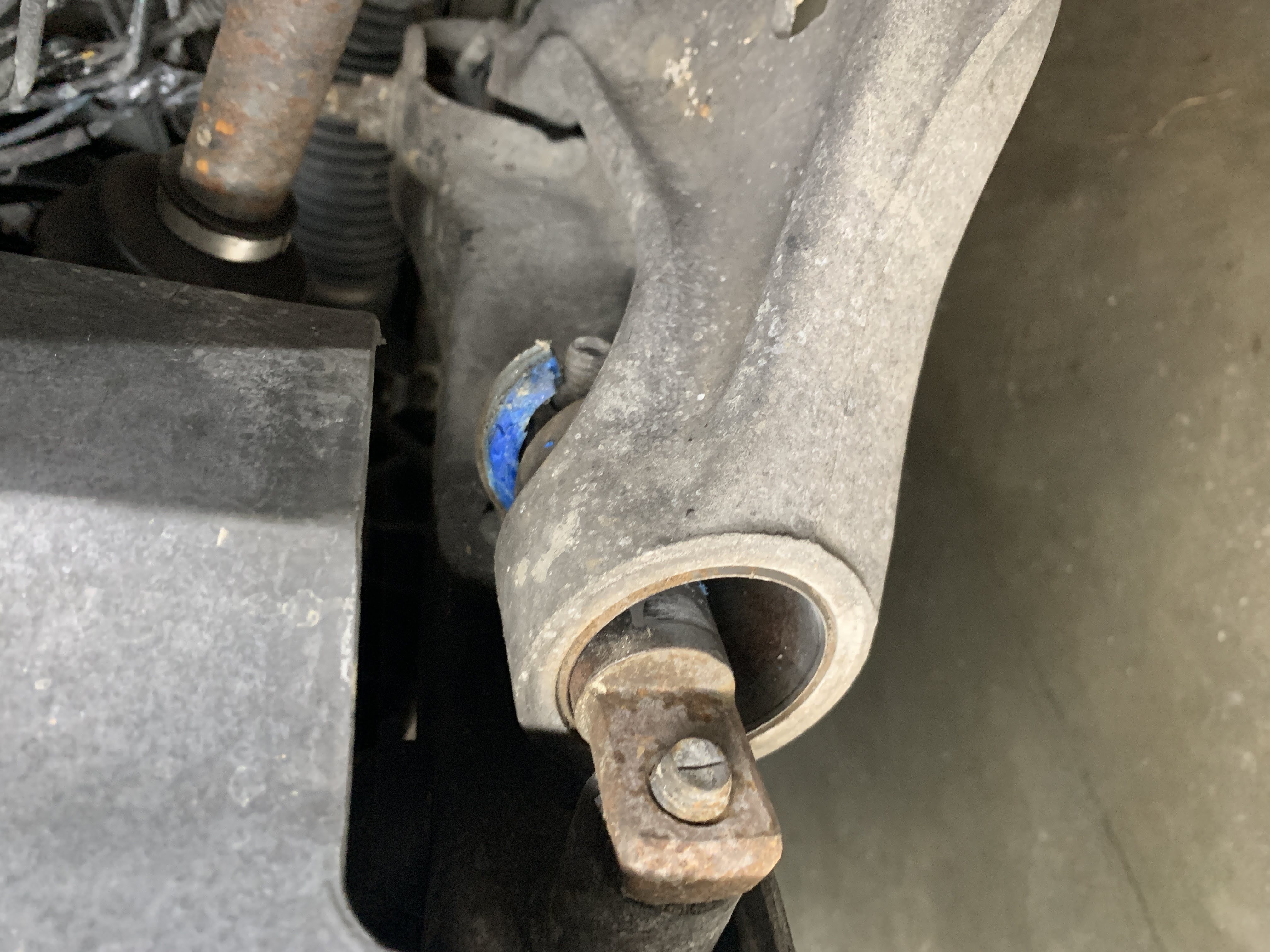

In other news, this appeared today. 400 hp M66 S60R! My buddy just bought it and dropped it off for some work. He drove it 4 hours up here from Georgia (where he bought it) with a totally missing control arm bushing. It was all over the road, but he made it safely!

Woof. Youth is wasted on the young.
(Seriously, that's a park, DO NOT DRIVE type issue. If that comes out of the control arm, life gets....interesting.

abscate wrote: 13 Sep 2020, 09:04 Woof. Youth is wasted on the young.
He had no idea, he was told it was the passenger CV axle by the previous owner. I drove it around the neighborhood and decided there's no way in hell that's the only problem. Jacked it up, and sure enough... no bushing! I wouldn't have let him drive it if I had known this was the problem. It seriously jerks all over the road.

That bushing looks less like it was worn away and more like it's a 4,000 year old Egyptian mummy, where soft tissue has disintegrated.

The bushing must have been degrading for a long time, I don't know how the guy let it get that bad. The interesting part is that the remnants you can see there are from a poly bushing... weird. The other arm has a standard rubber bushing.
