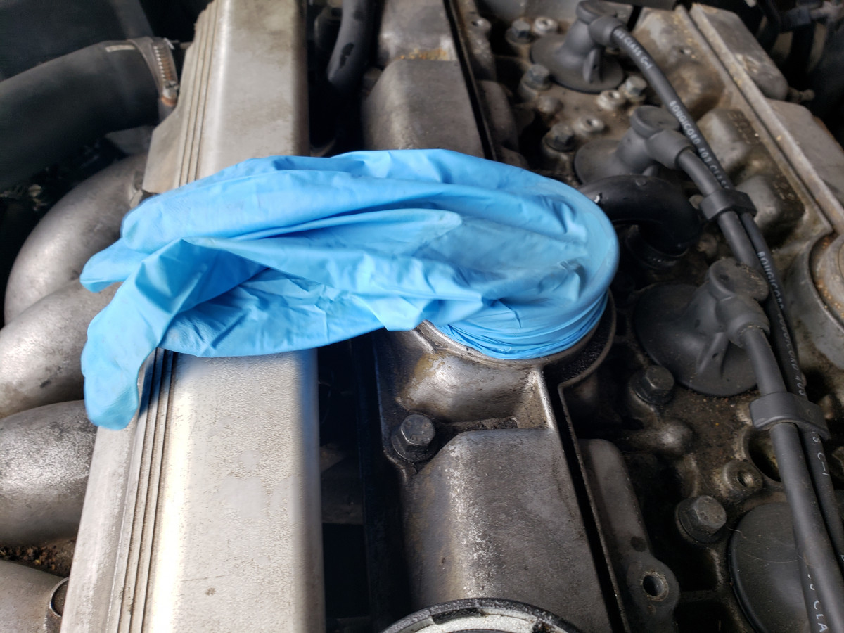

A few weeks ago I overhauled my PCV system and upgraded to the 5/8" hose with spring reinforcement. Despite cleaning all the block ports, ptc valve and the breather box that were super clean to begin with, I was still getting slightly positive pressure on the glove test. Someone suggested I replace the dipstick seal. I went ahead and replaced both the dipstick seal and the tube seal. Now I'm getting slightly negative pressure. I've never had a good glove test since the day I got her. The old dipstick seal was flat and so tough that I thought it was part of the plastic around it. What a difference.
- Posts: 14864
- Joined: 5 April 2010
- Has thanked: 1836 times
- Been thanked: 1709 times
Well that is a new one to me so thanks for sharing. I've had the reverse issue where the crank pressure was blowing the dipstick out as the seals were worn on the dipstick. This might be a good addendum to add to a PCV service to change these parts as part of the process. This might explain why some people say they still get positive pressure like you found.
