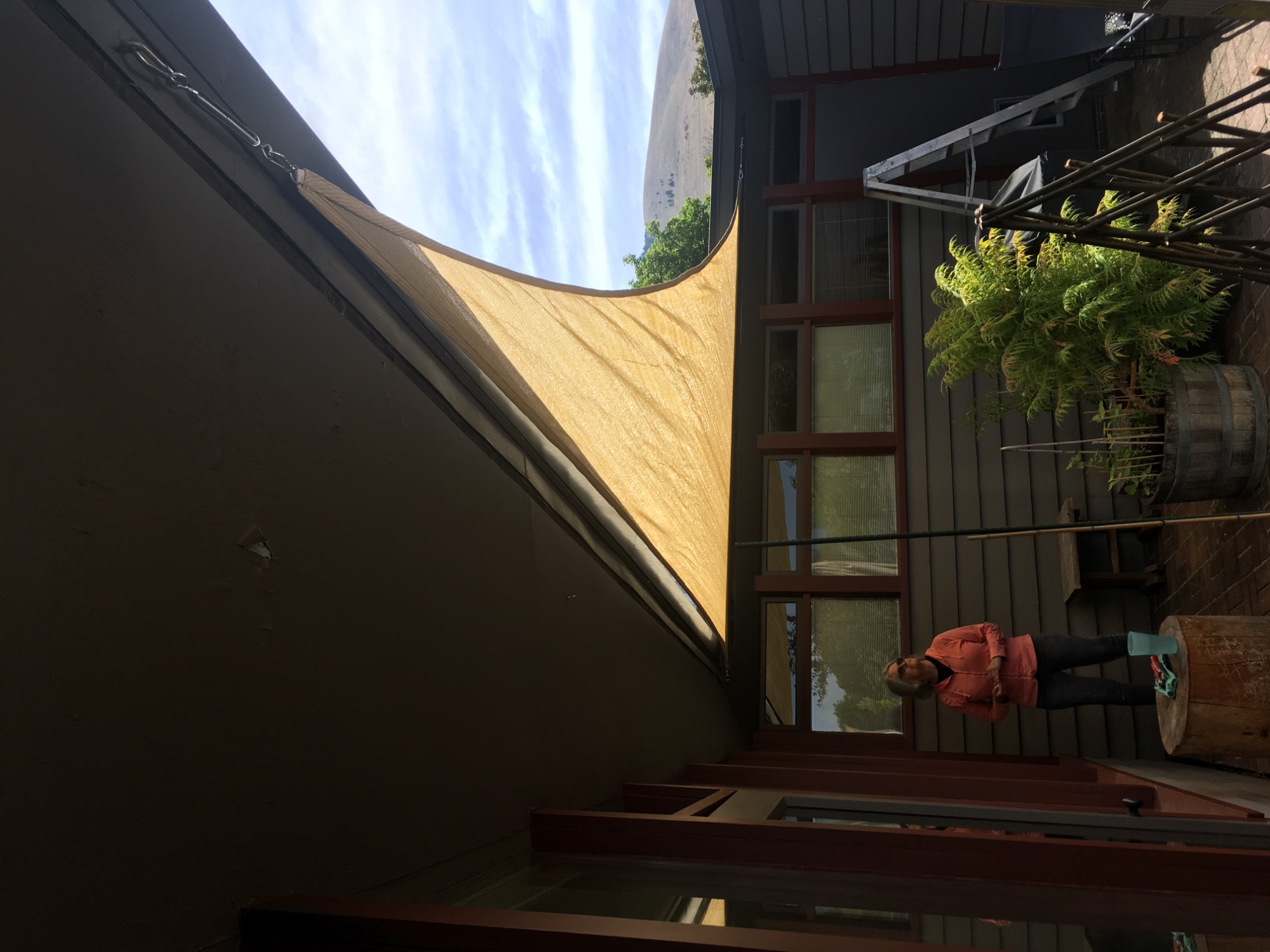

Last week (before the storm) I installed some shade! Made a real difference in temp in our courtyard, the whole NE corner is in shade. Kinda fun! I was going to figure out all the math to making the curves and the cable tension and all that, but here was this thing available for a bit over $100 - who's gonna make one from scratch for that? Right triangle, 15' x 22'.

Thank you! 1947. The architect built it for he and his wife and he lived in it until he was 85-ish.

He was obviously ahead of the curve. Looks prairie style. Reminds me of one of Wright's Usonian homes.
My personal favorite architectural style of building.

I really like the Usonians - small, simple, clean lines, good proportions, nice light.
This is a series of 1 1/2 in 12 sheds In a long thin house with a U shaped courtyard. Little BRs, nice open LR / DR on that glass courtyard. Kitchen with a curved sitting counter. Rarely need lights on in the daytime. LR shed is solar - no sun in the summer, sun 2/3 of the way across the room in winter. It’s so fun to live here. It was a lucky find.

The house is attractive and I like the shade/sail too.
