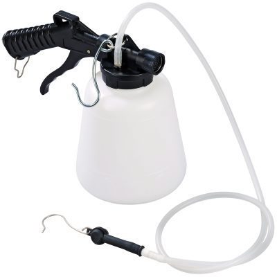

Found this tool to be the only way of me getting the air out of the clutch cylinders and piping, used it to swap out the brake fluid when I bought the car two years ago:

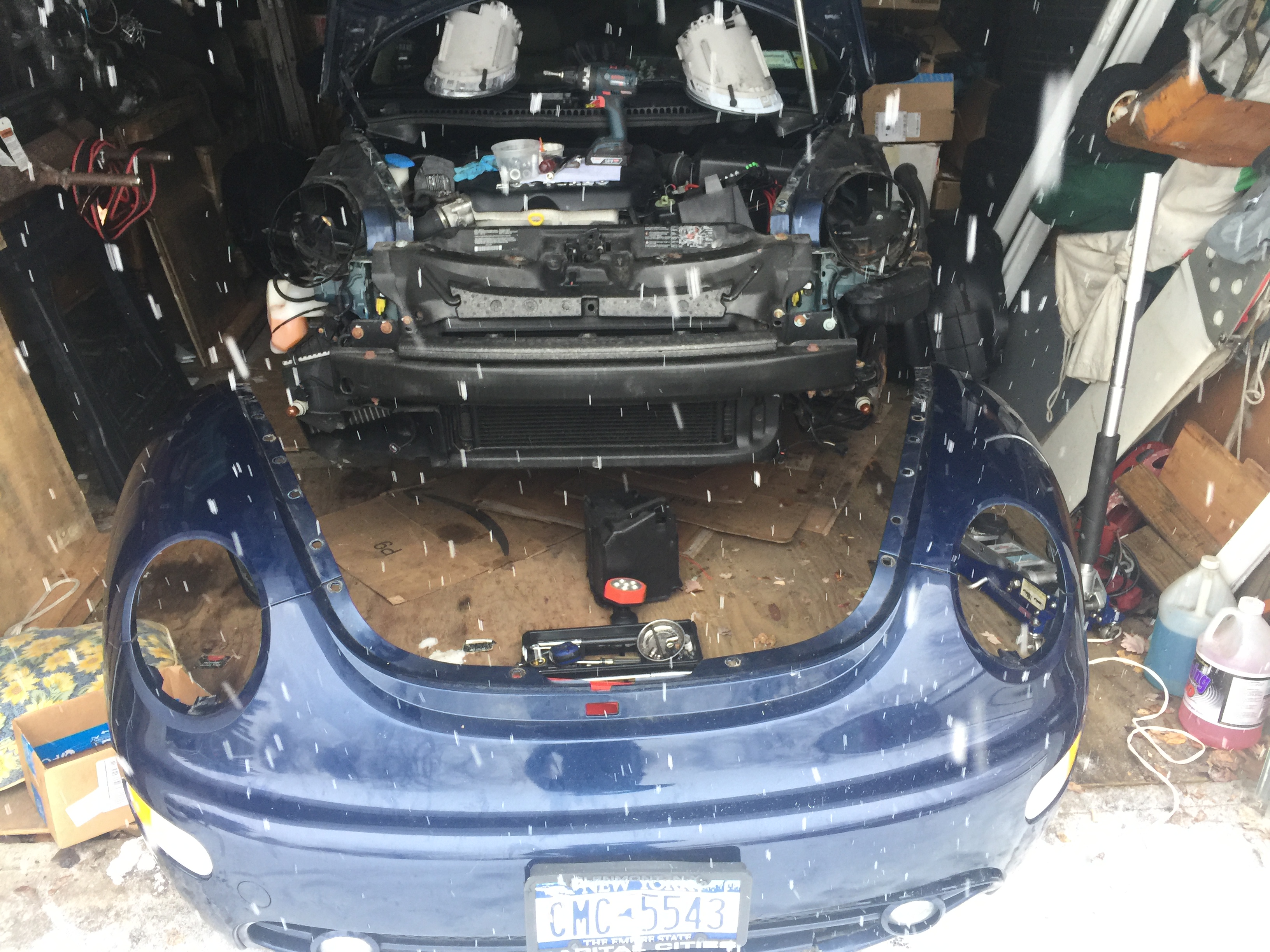

Used my 99 as a mobile garage to store tools fir my Beetle air bag sensor replacement
Step one. Remove entire front of car.
