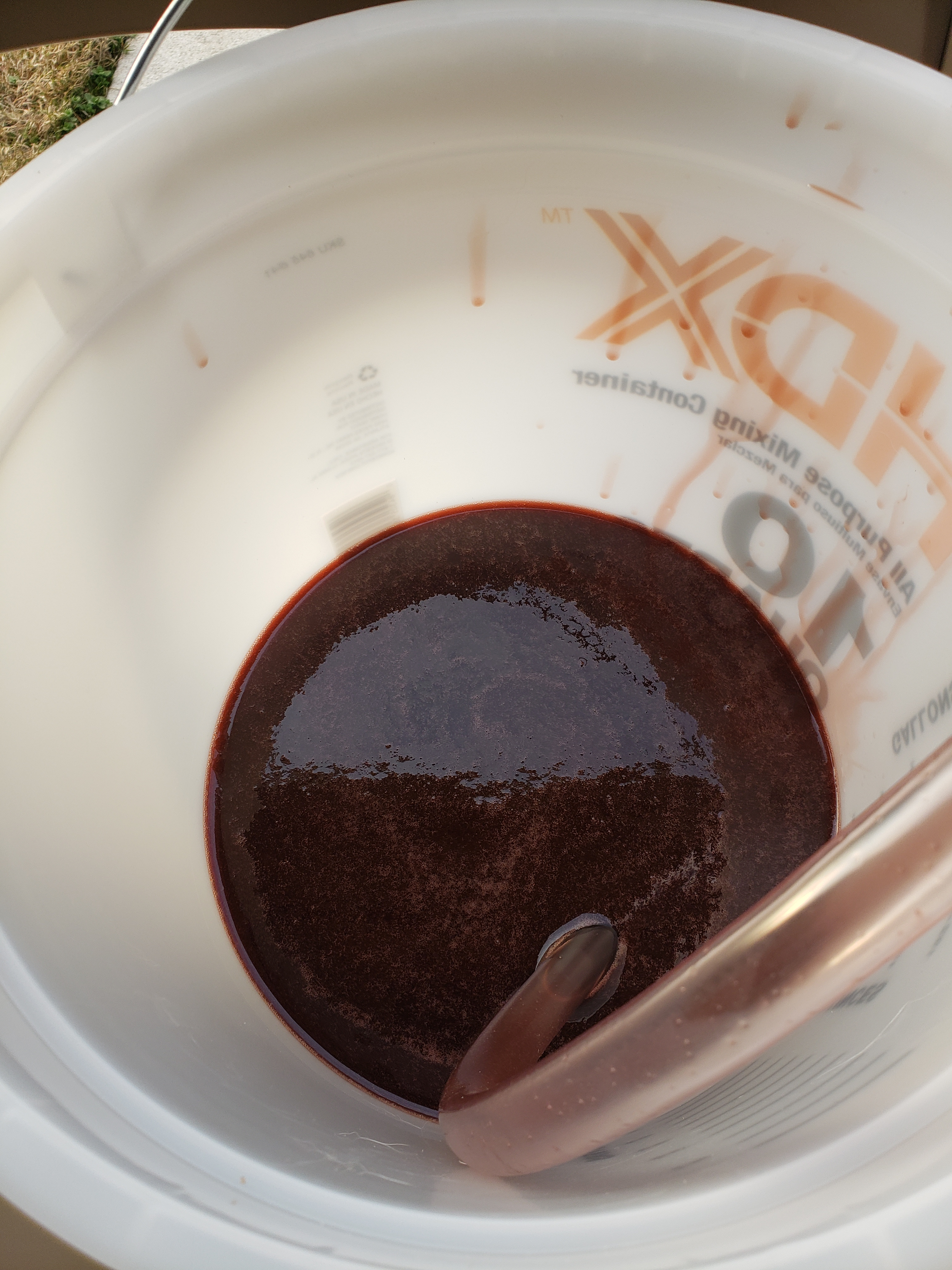

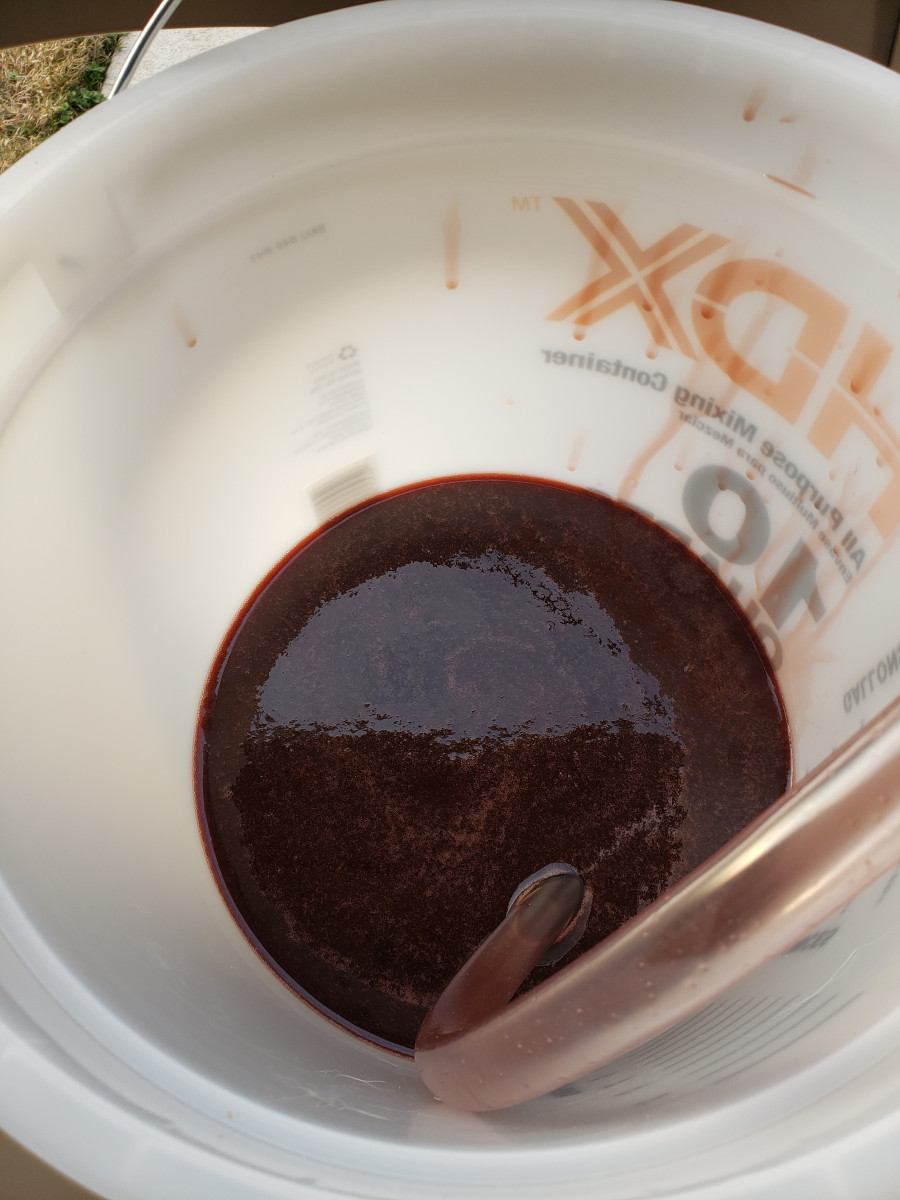

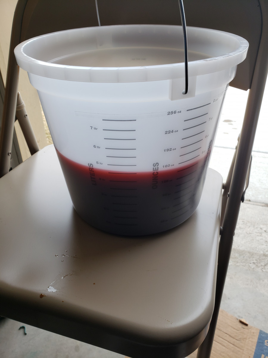

While researching my progressively worsening shudder problem, it was suggested to me to try changing the transmission fluid completely. I've done 2 drain and fills over the past year. The fluid always look nice and red on the dipstick. I was hesitant to do the complete exchange for fear of messing something up. I now feel stupid for not doing it sooner. It was surprisingly easy. Despite clean fluid on the dipstick, the fluid that came out was horrid.
So far today the shudder problem still exists. I read 2 posts on sweedspeed that said their shuddering improved over time after the fluid change. I suppose in the mean time I should start planning to pull the torque converter out of my parts car.

After this mornings transmission fluid exchange, the drive to work was filled with constant shuddering. However the drive home tonight was fantastic. Smooth shifting gears, excellent acceleration and only minor shuddering at idle. The problem still exists but I suppose the new fluid is lubricating things enough to compensate.
