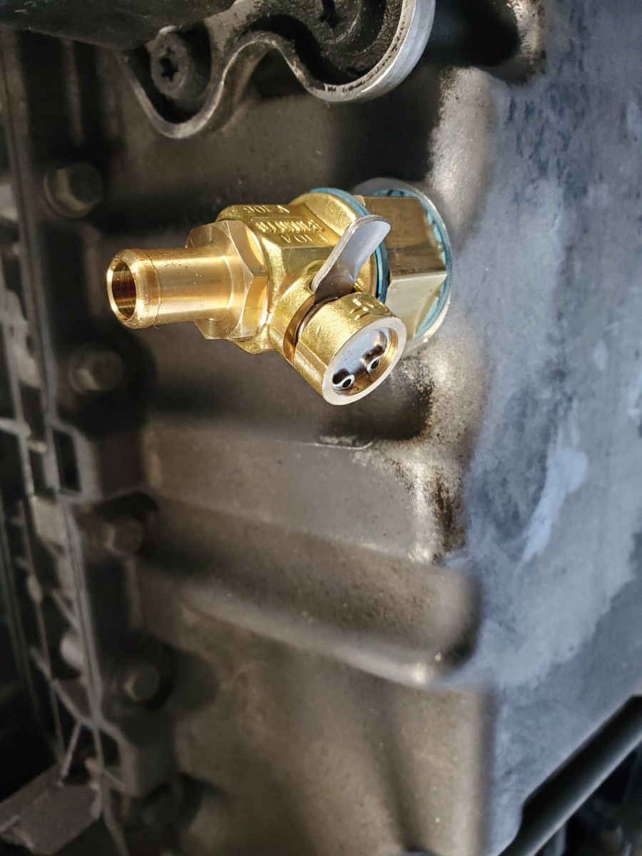

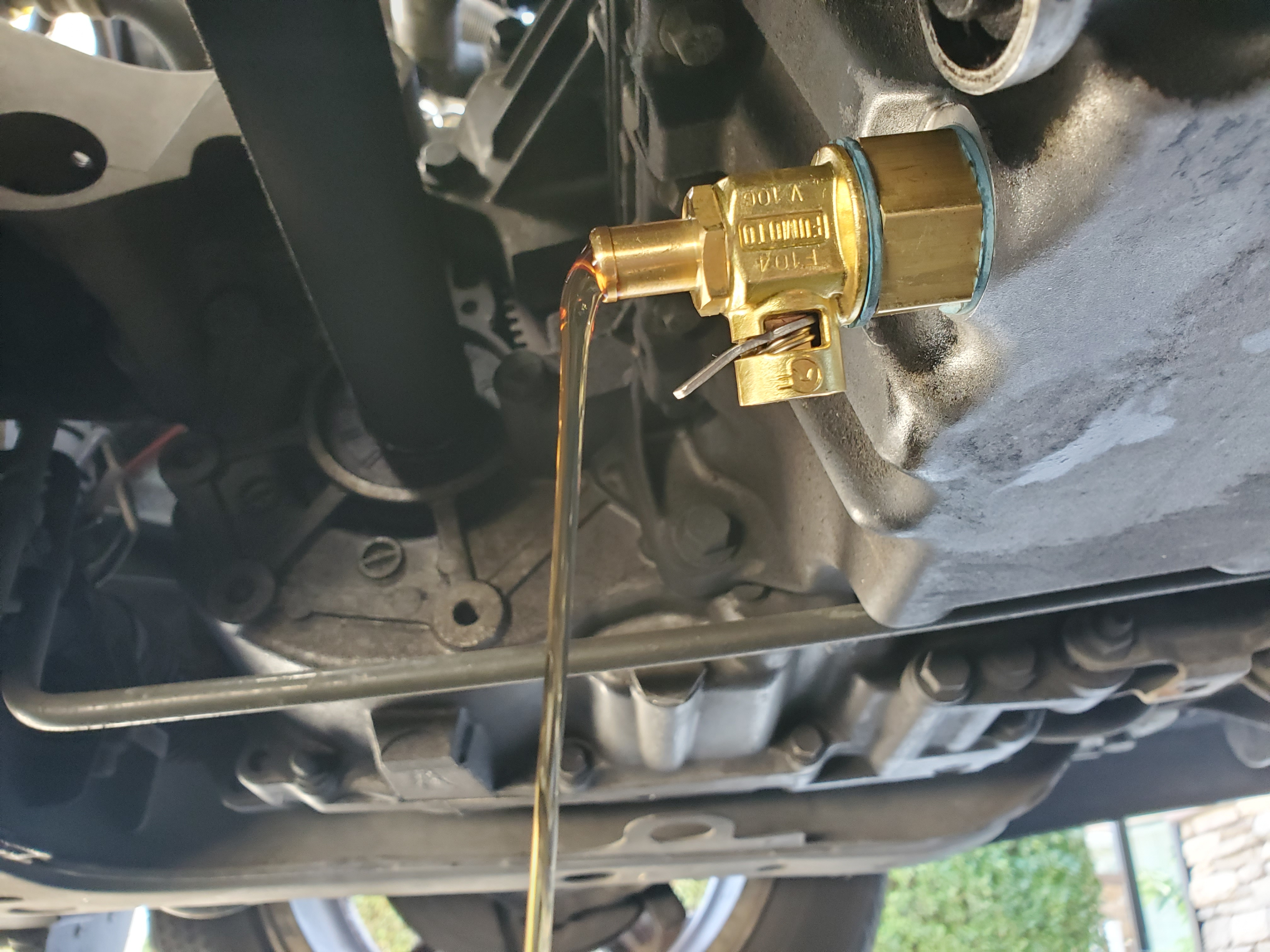

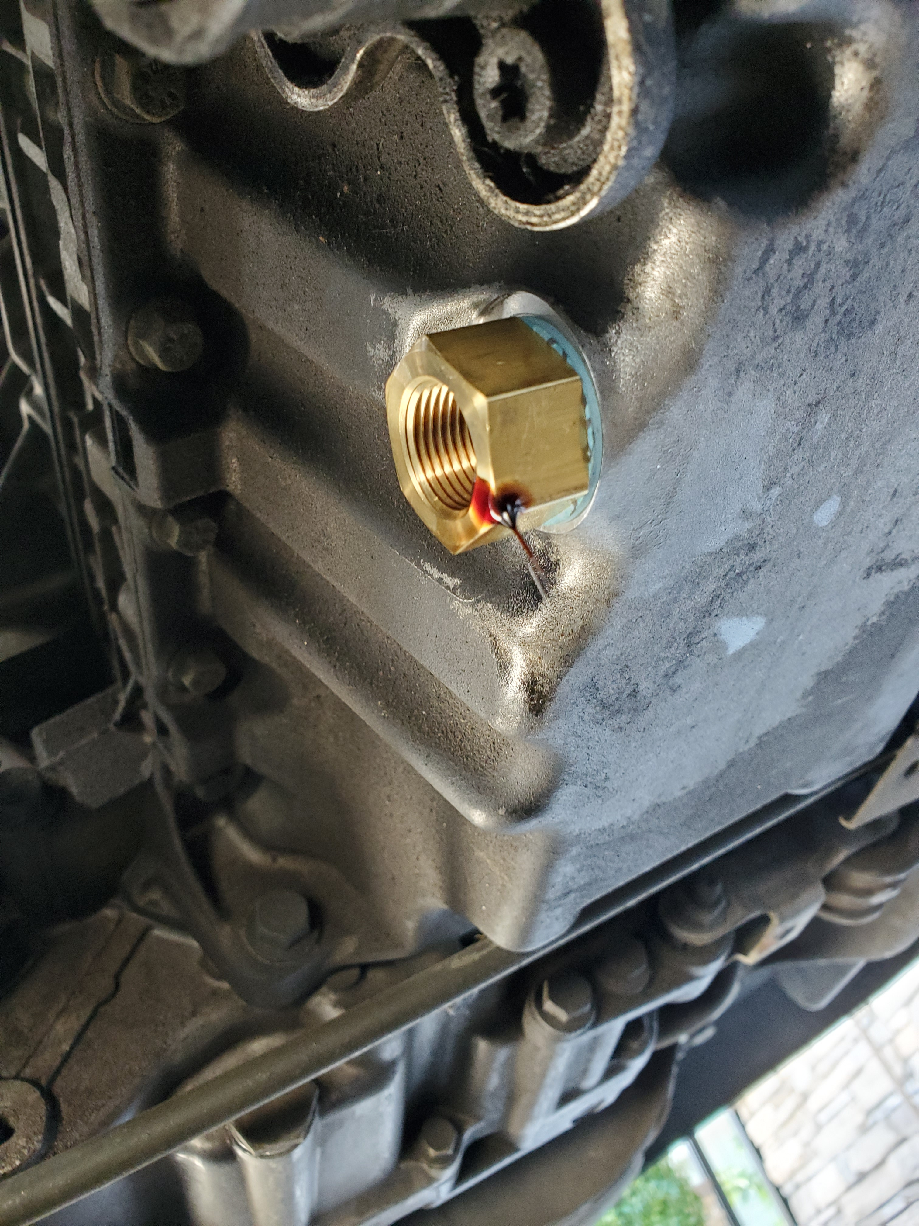

I had one of those on a car for a while I thought it worked well. It was well made and I never had an issue with it.
The only downside is that the oil drains a bit slower but the upside is it's a lot less messy.
I ordered mine with the locking clip so that the level couldn't accidentally move and drain your oil while you were driving. I quickly lost my clip, so I used a little zip tie in the groove as a security measure. Just find a zip tie skinny enough for the groove and it will prevent the lever from moving.
I honestly don't think there is much risk of the lever moving on it's own, but a zip tie was easy piece of mind.
I would just snip it and use a new one each oil change.
