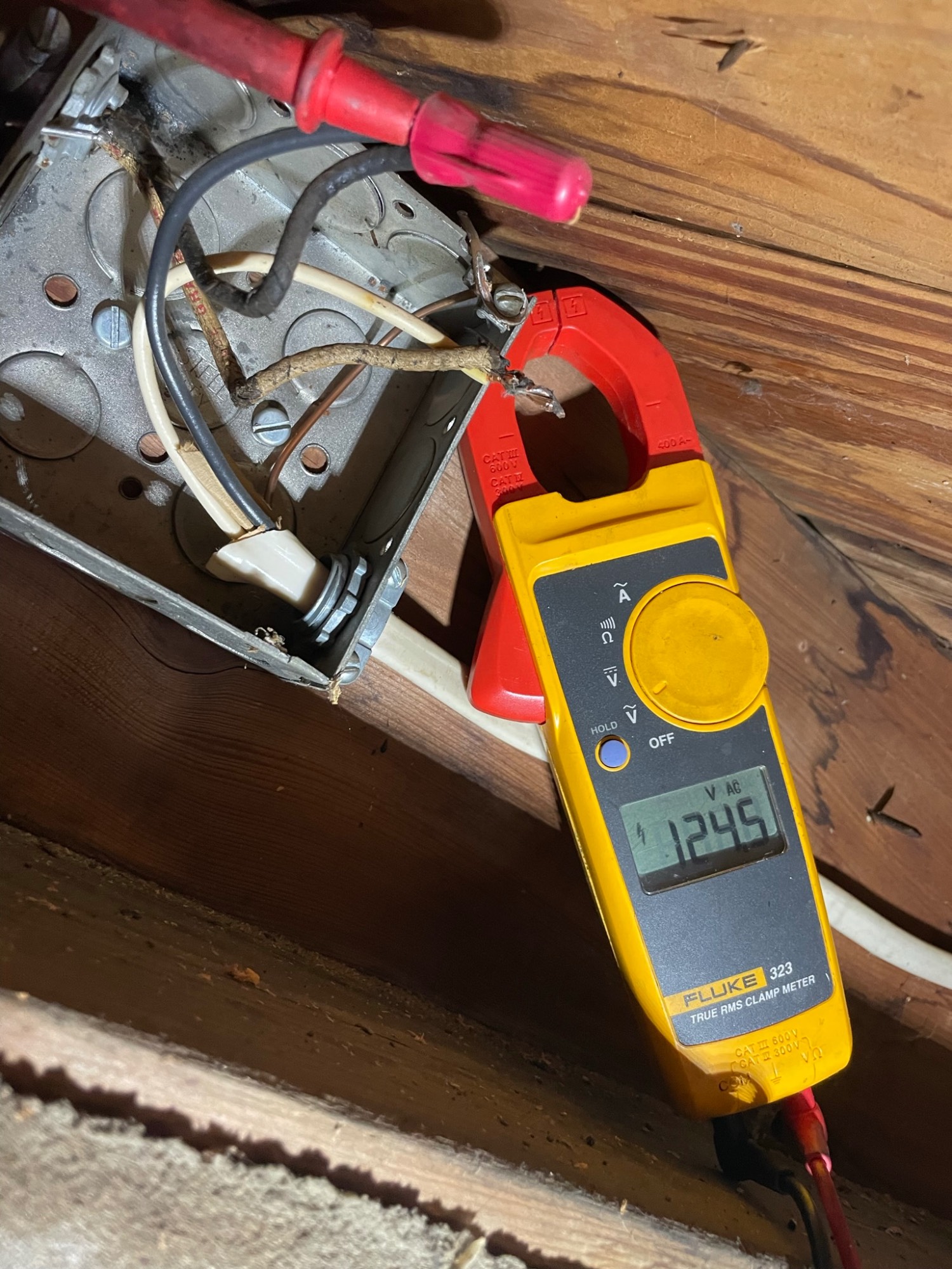

Interesting electrical fault. Stuff has always flickered on my circuit in the family room East wall,rarely used. Finally noticed a fan ran at reduced speed.
Good 120 ish volts AC to ground.
Hot to neutral, only 90 VAC!
Traced it back to resistance at the neutral bonded at the fuse box. I like electricaltroubleshooting because it follows simple rules.

I have found a couple outlets in our 40 year old home that had bad wire connections. They would occasionally trip the breaker. Tightening the wire screws fixed the problem. Worse part was finding the correct circuit on the electric panel. It was never completely labeled.
