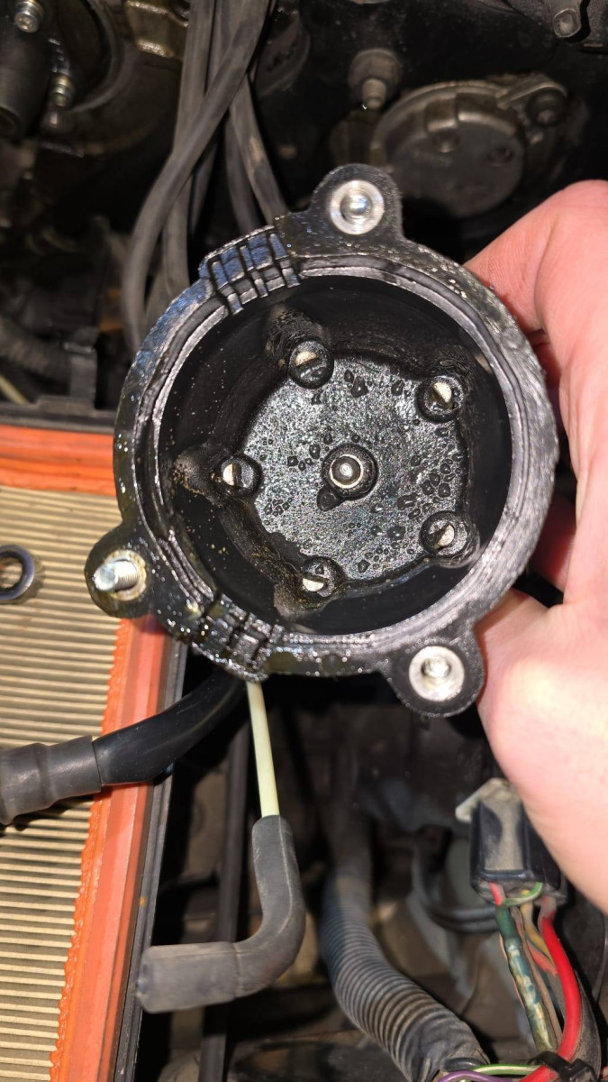

Thank you for your help. I did the fuel pump test today and could hear the buzzing sound for about 3 seconds, so I assume the fuel pump is working fine. I’ll perform additional tests tomorrow to confirm.
However, guess what? The car randomly experienced rough idling, misfires, and other symptoms again—just as I suspected. I opened the rotor cap, and it was the same as before: a lot of oil and condensation inside. (Attached is a picture I took a week ago, and it looked exactly the same today.)
My PCV kit and seals arrived today, and I’ll be replacing them soon. It seems that the root cause of all these issues is the oil and condensation leaking into the rotor cap. Hopefully, fixing the PCV system and seals will finally resolve this.
I cleaned the rotor cap, reinstalled it, and all the issues are gone. The car is back on the road and running smoothly!
Yes!
100% agree, no need to mess with anything else until that's fixed.
