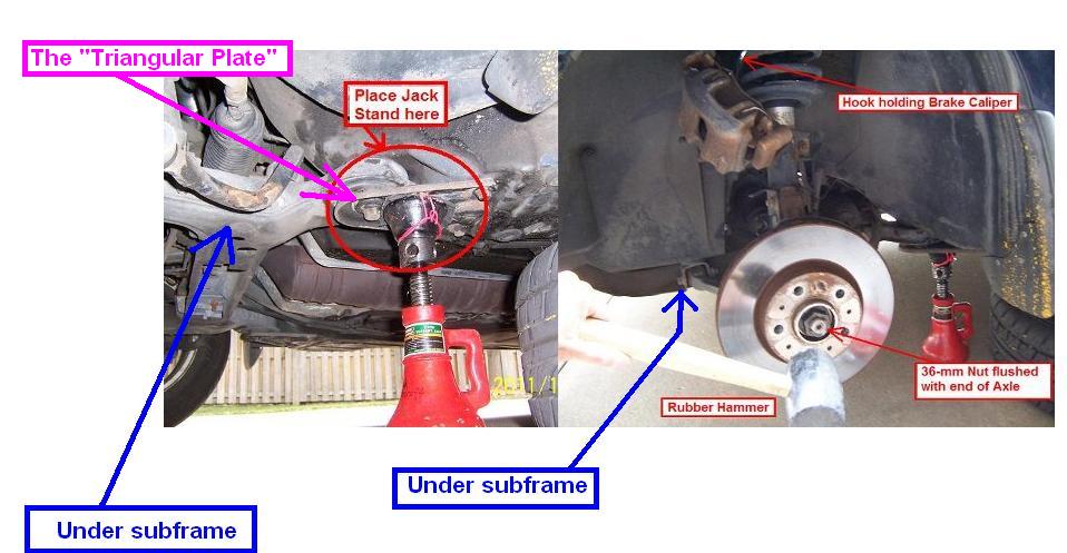

Yeah, the XC90 is heavier than the 850 for sure.
When dealing with any cars, especially SUV, I use 2 jack stands:
- The standard 4-leg jack stand has to be at least 3-ton type on the subframe.
- Then another screw-type jack stand and crank it up until it is snug against the subframe:
I don't have a photo for the XC90 but below is a photo from my 1998 S70 GLT to show you the "screw-type jack stand": this is the type people use to jack up a sagging floor joist in a house or railroad car etc. This jack stand is very strong but the base is small (don't forget to chock the diagonal tire). Then I add the standard 4-leg jack stand (not shown in photo) where the BLUE caption saying "Under Subframe".
Now I have 2 jack stands on the SAME side of the subframe.
- Just do a google search "Jack Stand failure" and look at some of the photos of death and injury from failed jack stand. Yes, jack stands do fail, if it cracks, it usually cracks at the weld. Your life is worth more than the weld. BTW, slide the tire (+ a few pieces of wood on top of the tire) under the car as an added safety net.
