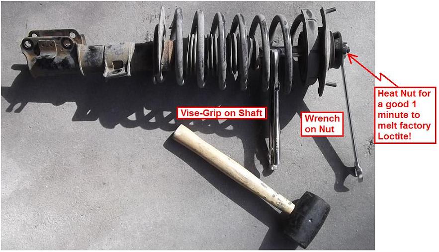

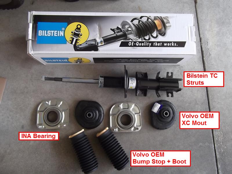

Update on tips/tricks, this is my other car 1998 S70 GLT with 150K. All suspension is stock.
- Again, I used Bilstein TC struts ($110/each online).
- For Mount, Bump Stop + Boot: Volvo OEM.
- The Strut Bearing: I bought INA brand online ($50/each).
After removing the factory bearing, it was clearly marked "INA" (OEM Supplier). At 150K, the bottom shield of bearing has cracked, the bearing has some play, not severe but time to go.
- One strut has a flat part at the top (to counter-hold while undoing the nut), the other has Allen hole!
- I stripped the Allen hole while counter-holding the shaft.
- The Vise-Grip on the shaft itself is not useful without heat!
- At factory, they used Loctite, so I heated the nut for a good minute to melt the factory Loctite, then the nut turned loose. Loosen the nut but do NOT completely remove this nut without first compressing the Spring!
So if you don't have air tool, a propane torch is a must when doing this job!
Good Luck!
DIY: 1998 Volvo V70 Front Bilstein TC Strut Tips/Tricks Topic is solved

With a broken mount (both of my mounts were broken), it is very dangerous to remove the big nut completely.
The full force of the Spring applies to the perimeter of the rubber mount.
This was why I said "loosen, but do not remove the big nut". Safety first!
