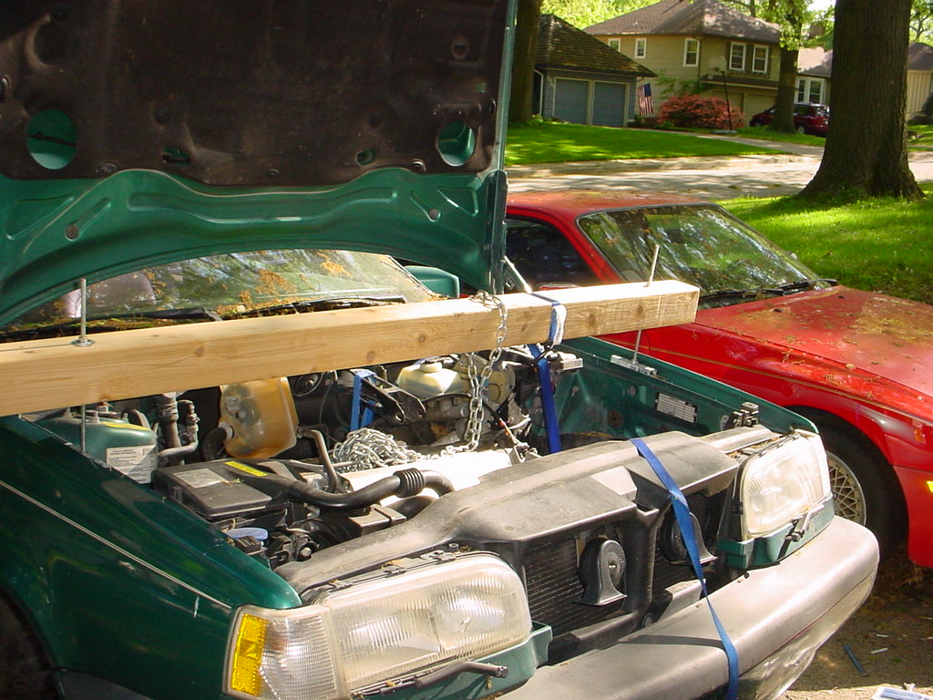

whoa wrote:
What point on the tranny side of the engine do you hook to--the eye on the torque bar bracket (like I've done in the picture)?
Dropping it out the bottom looks a lot easier than taking the whole thing out the top, I can't wait for your guys writeups/pictures.

On my M56 there was an eye on the transmission itself that I used a ratcheting tie down strap to secure it as I pulled the transmission. It is amazing how similar the Volvo part (tool) number 999-5006 looks when we all shade tree it.

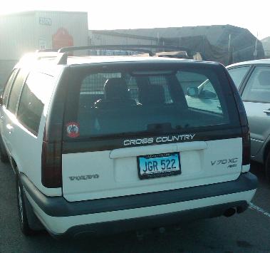

I smoked my tail lights today. It's phase 1 in reconditioning the outside of the car. Next week it's repaint the trim and roof rails to OEM black.
- tail1.JPG (19.81 KiB) Viewed 1829 times
