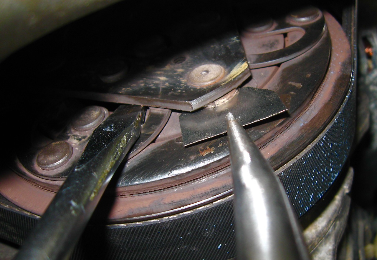

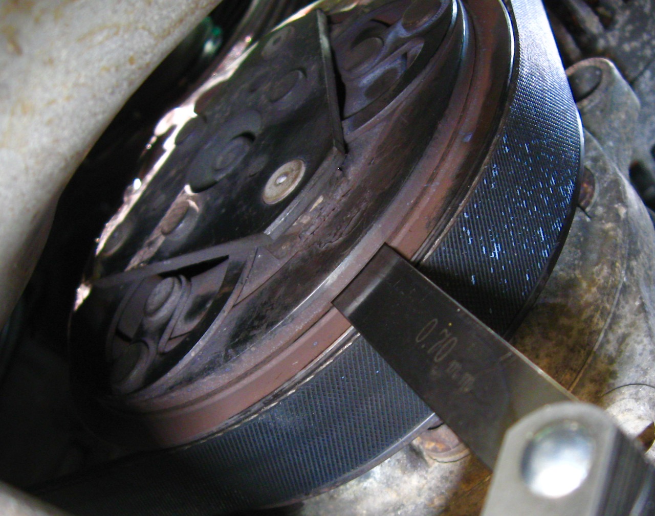

This is just a little update on re-shimming the AC clutch. I originally shimmed it in 2010 with thin brass shims and had been riding around for years with good AC and no problems. Last week it got unusually hot and the AC kicked off after working for a while -- a classic symptom of a clutch gap that has gotten too large over time and won't allow the clutch to engage when the clutch is very hot. I went off and reviewed the helpful videos made by Robert DIY over the years (rspi here) first. Then I checked the gap and found 0.7 to 0.9mm all around.

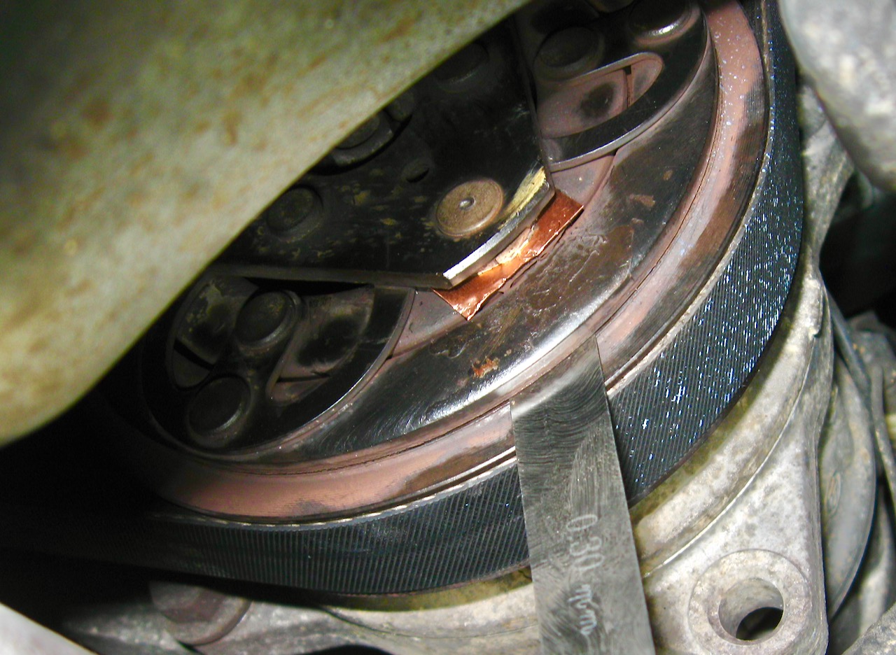

I installed new shims, using a stainless steel sheet that was 0.25mm thick and a copper sheet that was 0.15mm thick under the rubber bumpers as needed to get the gap back down below 0.5mm, but not tighter than 0.3mm.
I found that a 0.25mm thick shim reduced the gap by about 0.5mm and a 0.15mm thick shim reduced the gap by about 0.3mm, but your mileage may vary. After installing the shims, I measured all around with the feeler gauges and got gaps that ranged from 0.3mm to 0.5mm.
I added a little glue after installing the shims to keep them in place. I'm hoping for another decade of smooth running AC with this simple fix.
