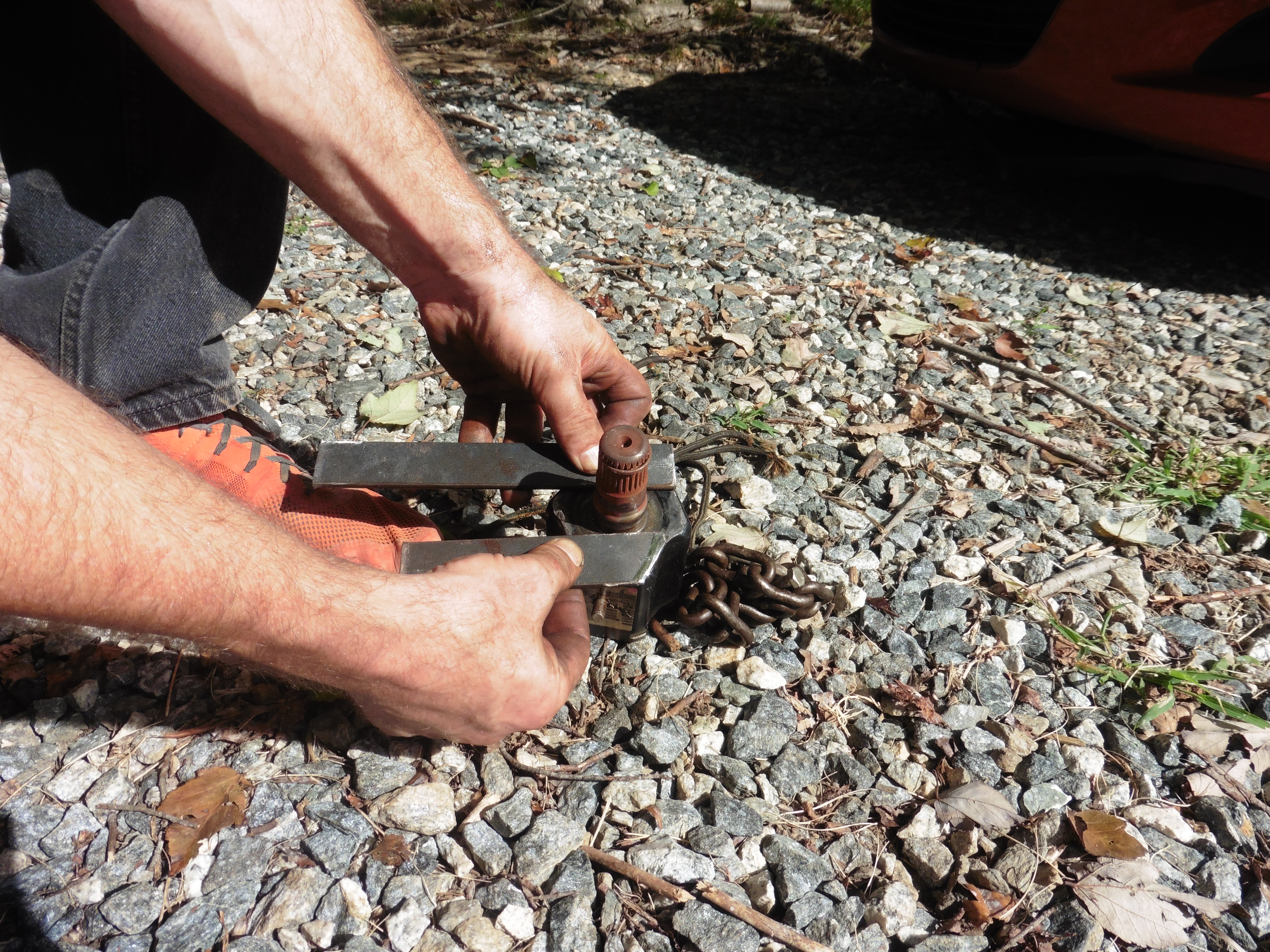

I spent a day and a half with various recommendations found on the internet; pry bars, chisels, slide hammer, bolt through housing hooked to slide hammer then to 2 ton winch, push in and rotate and try prying again to move retaining clip around to better spot. What finally worked was to cut two pieces of steel bar that are 3/16" thick by 1 1/4 " wide and maybe 6 to 8 " long. Cut the end of one of the bars at a slight angle so it won't hit a flange sticking out from the transmission on the front side of the axle. Taper the ends of both bars so they don't cut into the transmission housing. Drive the front bar in vertically from below and stop when the end of this bar is just to the top side of the axle or a bit further (the picture shows the angled bar driven further than what I actually did). Then, drive the second bar in until the axle comes loose.
Disclaimer: I am not a professional mechanic and this is the first time I have replaced and axle/cv on a Volvo.
