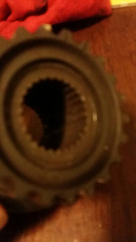

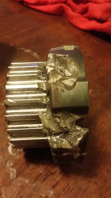

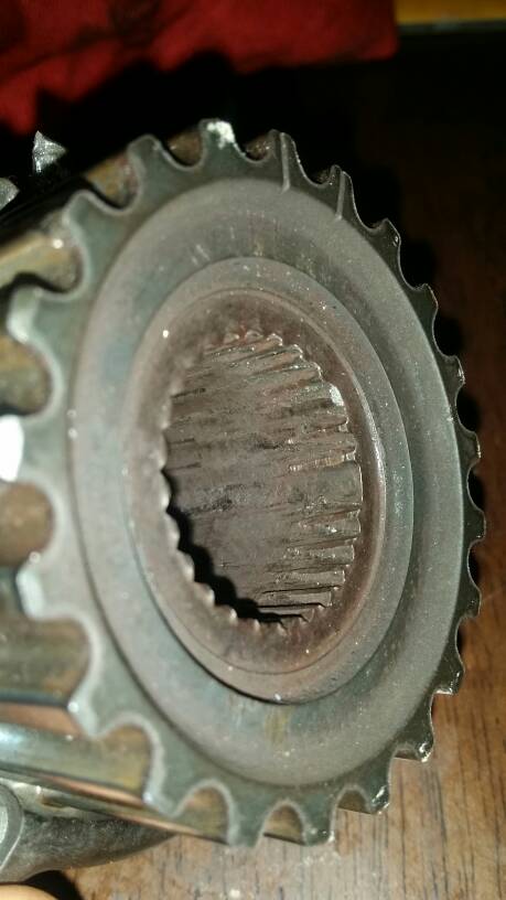

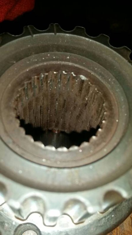

Redneck you are correct. I got a call today from the dealership giving me an ultimatum to either: 1. pay $3600 for a used 100k mile engine all labor included and keep loaner until work is done. Or 2 return the loan and go from their. After work I went up their to check out the car. I finally got them got an answer on the crankshaft pulley. It was the cause of my code. Dealer said that sine they didn't replace that part its not covered under any warranty. Although they had to remove it and didn't catch the wear of the teeth. Talked with a mechanic and he explained that the wear/corrosion should have been caught when they remove the pulley on the cranks seal repair. He said he would try and talk with the service manager on my behalf. We came to the conclusion the engine was torn down for no reason since the pulley was the problem all along.
Call volvo USA today filed a complaint and the area case manager supposed to contact me in a couple days. This leaves me in a bit of a dilemma, I have to give the dealership an answer tomorrow. Any thoughts?
I have attached pic's of the crankshaft pulley that is worn/corroded and the cause.

Looks like you're no. 2precopster wrote:There was one isolated incident posted here about a car (could have been a P2 series if memory serves me correctly) whose crankshaft slipped on the crank pulley. Very unusual and caused by isolated corrosion.
It's a very unusual fault

Crank Pulley slipping as in the photos, this is extremely rare, maybe one of these 1 in a million cases.

Look,
Whatever work they did originally (timing belt job), they screwed it up.
The only way to damage the pulley as in the photos is from incorrect installation, maybe the tech used the air gun to tighten the big bolt without first checking that splines matched. This will cause damage to the splines.
Anyway, you will have to take care of this issue yourself.
