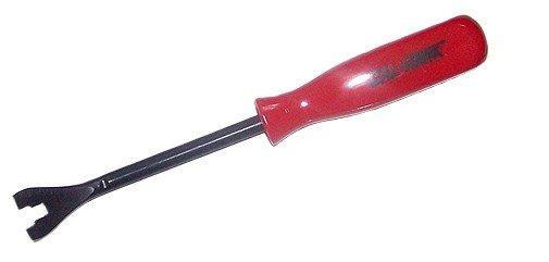

A trim removal tool works great when you need to disconnect the fuel line from the fuel pump.
An example of the the trim removal tool:
PeteB
