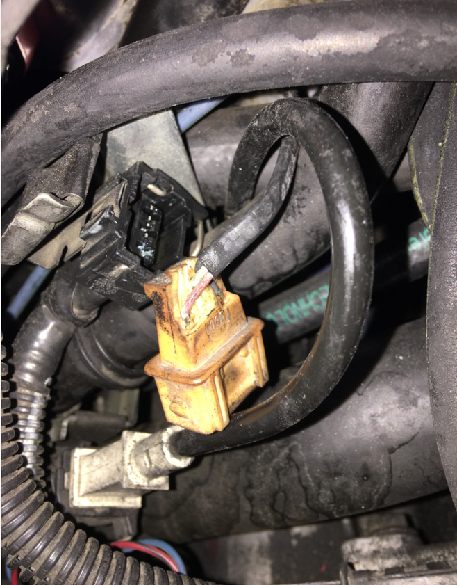

Checking on the various wires and connectors after the last post, I discovered that my CAM position sensor connector was in bad shape. If you see the photo below, the housing on the white connector basically crumbled when I was disconnecting it. I also saw a bit of corrosion on the blades of the connector. So I used a steel brush and a liberal blast from some electronics parts cleaner to remove the corrosion. I got some electrical tape and protected the exposed terminals and wiring and plugged it back in to check it out.
Well, it didn't fix the problem of the rough idling. However, I am sure that I could use a new CAM sensor at this point. That crumbling connector can't be a good thing, although I don't think it was preventing a signal from the sensor from reaching the ECU. The wires, although exposed, were still intact.
In any case, I have another CAM position sensor on order and the parts store said they'd have it this afternoon. The adventure continues.
The connector on my sensor has seen better days. It's getting replaced.
