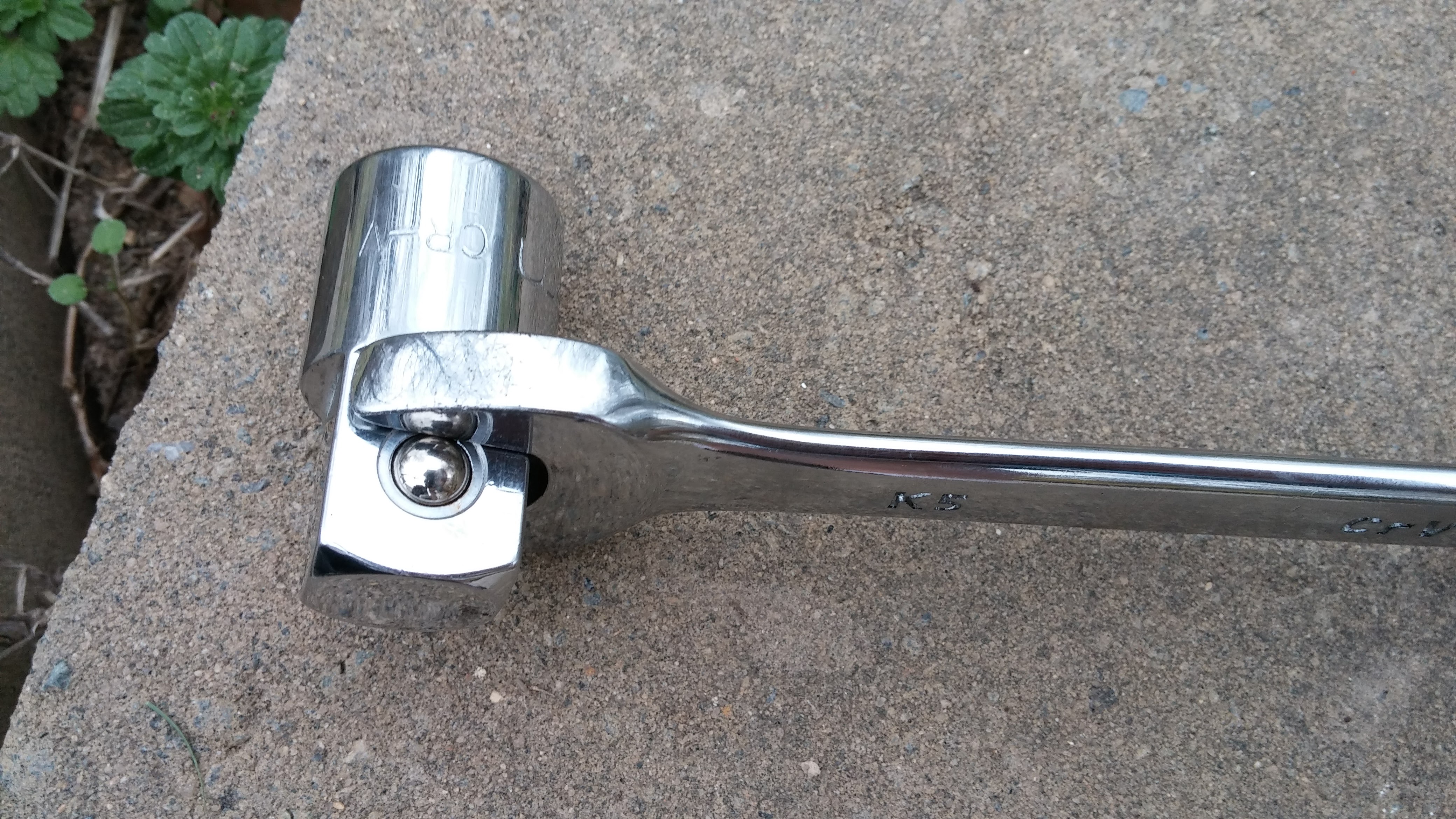

-1998 uses a 3/4" square hole. I've found a 1/2" drive to 3/4" drive adapter and a 19mm open end wrench work quite well to release the tensioner.
