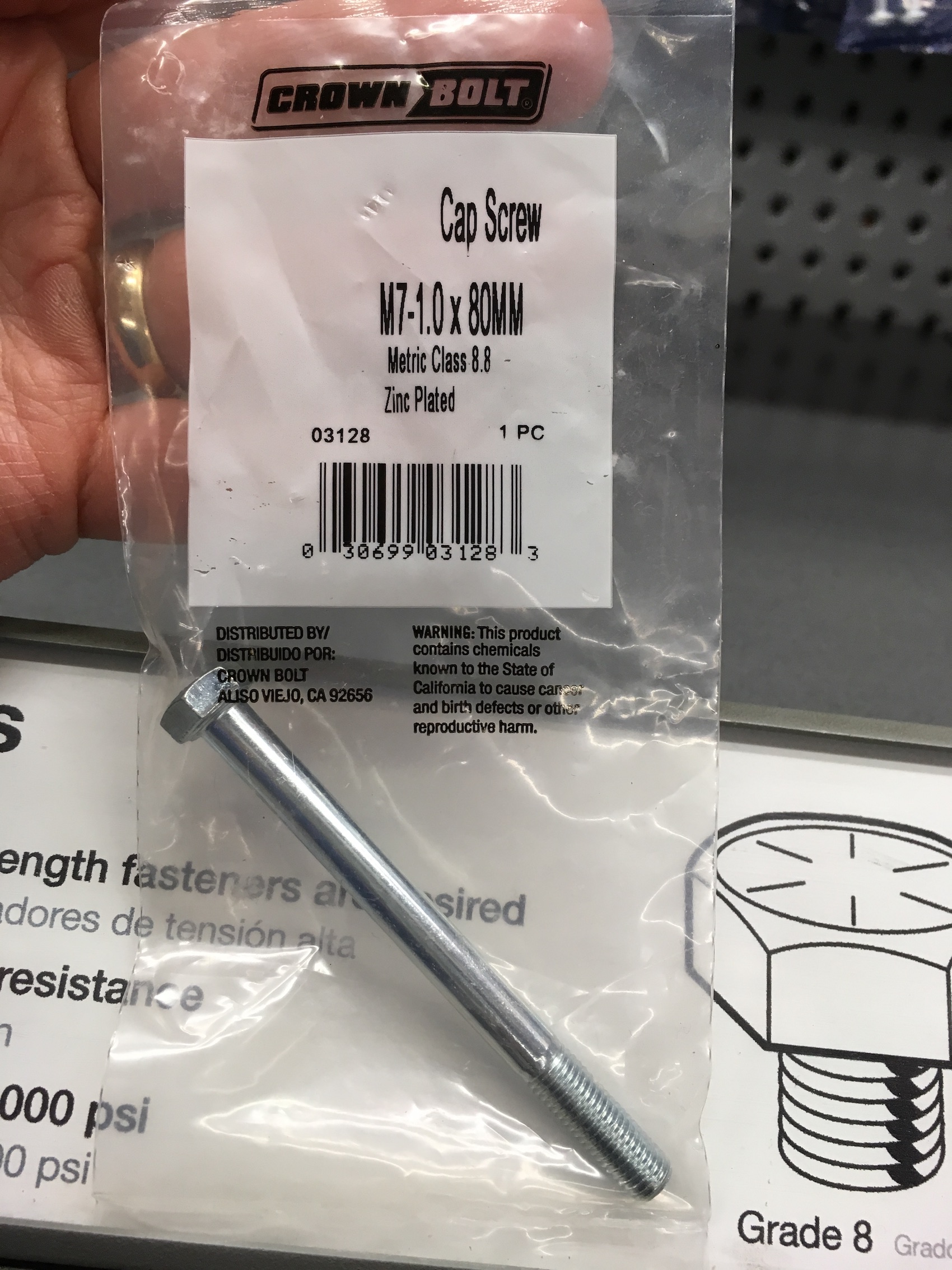

If you break one of these bolts, they are the holy grail to find. Fastenal, Grainger, all the normal bolt suppliers....it's an oddball size and too long and skinny (which is why it sheared).
It's an M7x80, pitch is the standard 1.0.
Found some in Germany....$45 to ship. Another German company will sell me 200 only. Found a titanium (?) in England for $12 each - they don't ship to the US. Just now I found a package of 100 at Grainger for $26. I suppose I could locate a hex bolt blank and a 7mm die and cut my own threads...for under $26?

I'm not sure why I hadn't seen this before, but it actually looks like Home Depot sells these bolts (and my local store seems to have them in stock for pickup):
https://www.homedepot.com/p/Everbilt-M7 ... /205037780
That's basically it, right? No idea about the quality, but it does appear to be the right size...

My Home Depot had seven in the drawer. I bought three to leave an even number for someone. Those bolts will sit in that drawer for years.
Thanks prwood! Who'd have thunk, Home Depot? Several washers and no more than 15 ft-lbs will be put on these.
December 2014 -
"HD Supply and The Home Depot today announced they have entered into an agreement for The Home Depot to purchase substantially all of the assets of HD Supply Hardware Solutions, formerly known as Crown Bolt, a leading supplier of fasteners and builders hardware to retailers in the United States."
Posts: 36145
Joined: 17 Feb 2013, 17:54
Has thanked: 1609 times
Been thanked: 4065 times
If those bolts are 8.8s I'll eat my bald spot
