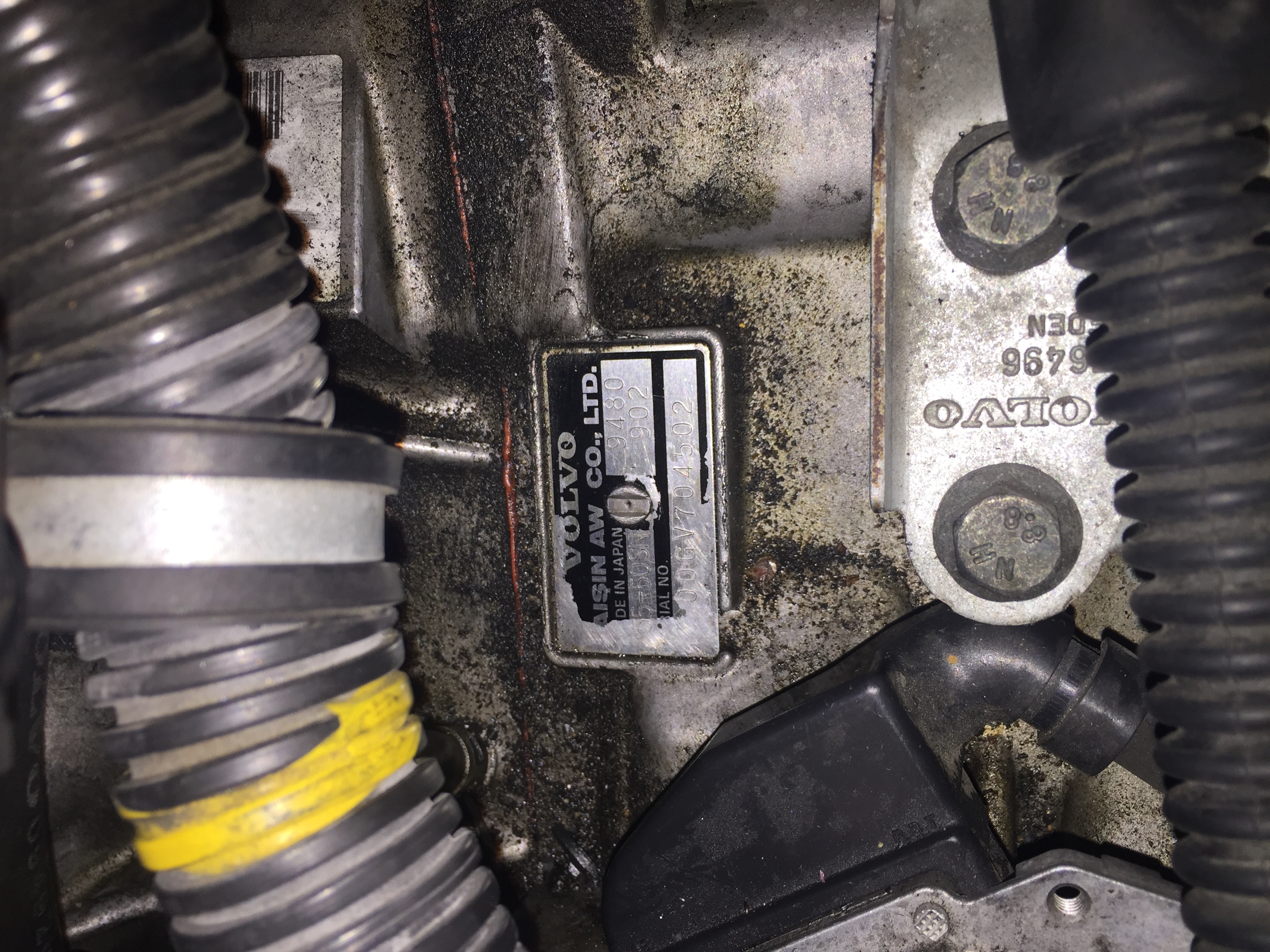

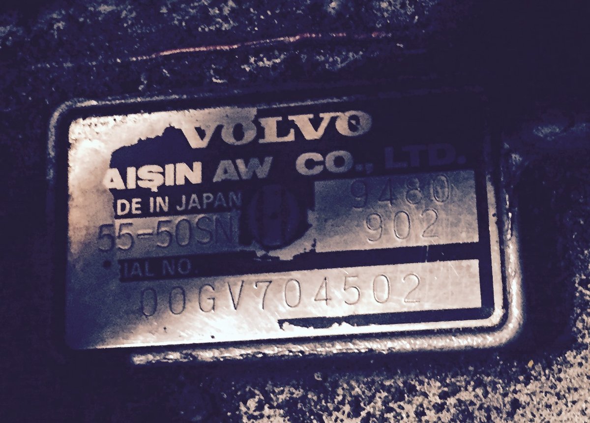

FYI, here's the (much dirtier) nameplate from the original transmission in my 2001 (early in the 01 model year based on the VIN). It's possible the P/N was changed as they changed the Rev on the valve body casting. I know that this transmission had a no-letter valve body in it. I did not open the 2002 transmission I put into the car, though it was almost certainly a Rev A based on date of manufacture.
