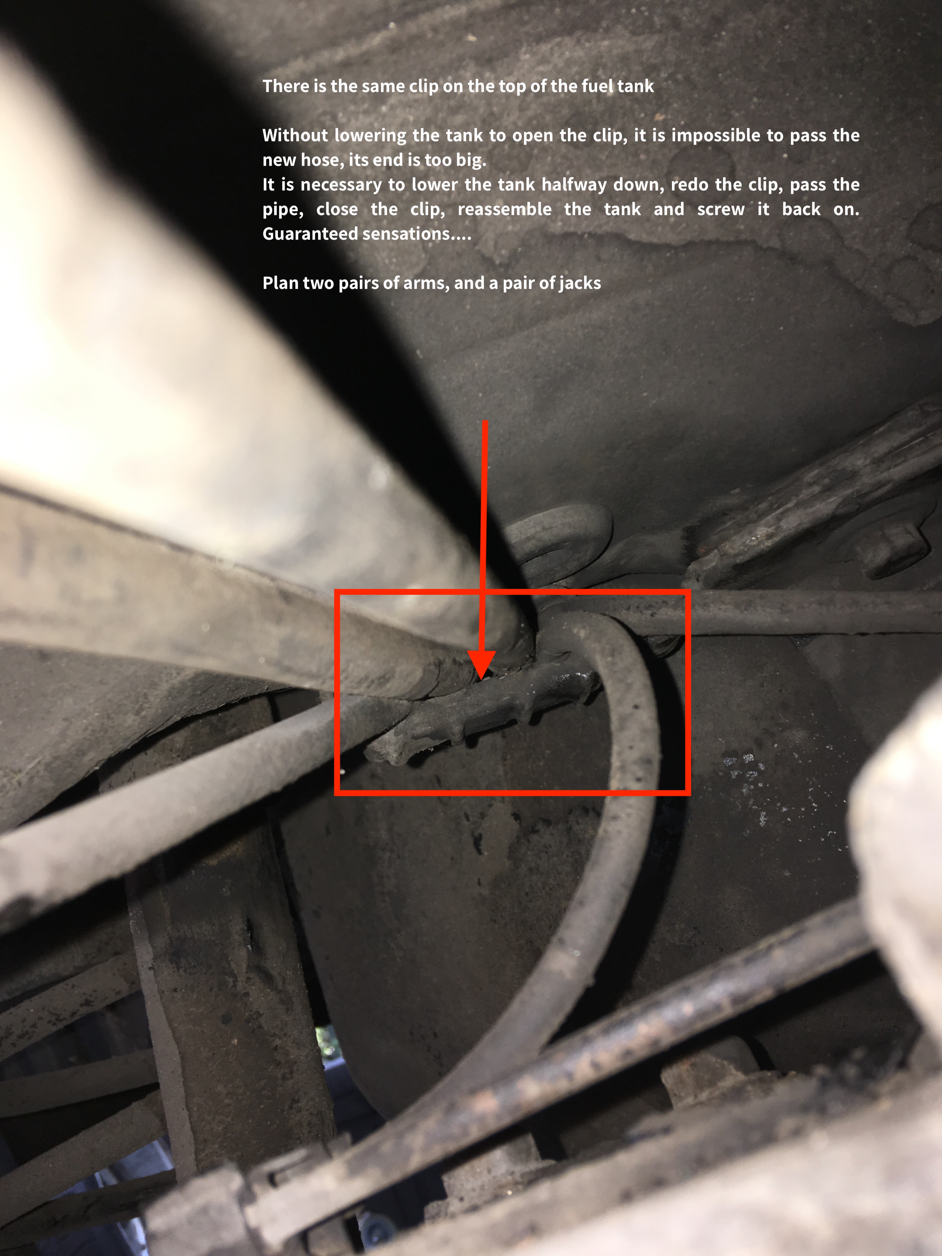

So, at the end, it's repaired. It's the misery to replace this damned pressure hose, but with a pair of arms and a jack, it's alright.
1.Free the fuel tank cap.
2.Jack the car safely,
3.Put a jack under the fuel tank with a large piece of wood,
4.Unbolt the three bolts that hold the fuel tank (12),
5.Open the clip behind the wheel backside of the rear wheel, backside of the fuel filter,
6.Lower the tank halfway,
7.Open the clip on the top of the fuel tank, by the inside of the car,
8.A buddy give you the pressure by under the car,
9.Put the hose correctly in the upper clip, close it.
10.Replace all the things as they were at the origin.
I definitely will invest in lifting ramps.

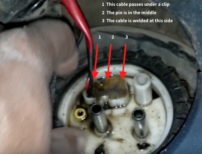

I learn from my mistakes...
Unfortunatly, while we were trying to screw up the tank, the wire of the fuel pump has been a little bit touched.
The cable has become bare and touched the clip that holds it to the pump weld. As a result, the gauge was only working intermittently. I think I need to take the pump out and try to do the welding again.
This means a new pump seal. Minimum breakage, actually.
I precise that the yellow "glue" you can see on the picture wasn't on my pump.
As I said, I learn from my mistakes.
I find this car extremely tolerant with newbies... :?
Volvo fuel pump.jpg (66.67 KiB) Viewed 693 times
Picture from Robert DYI 's video
Manov

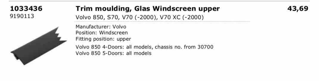

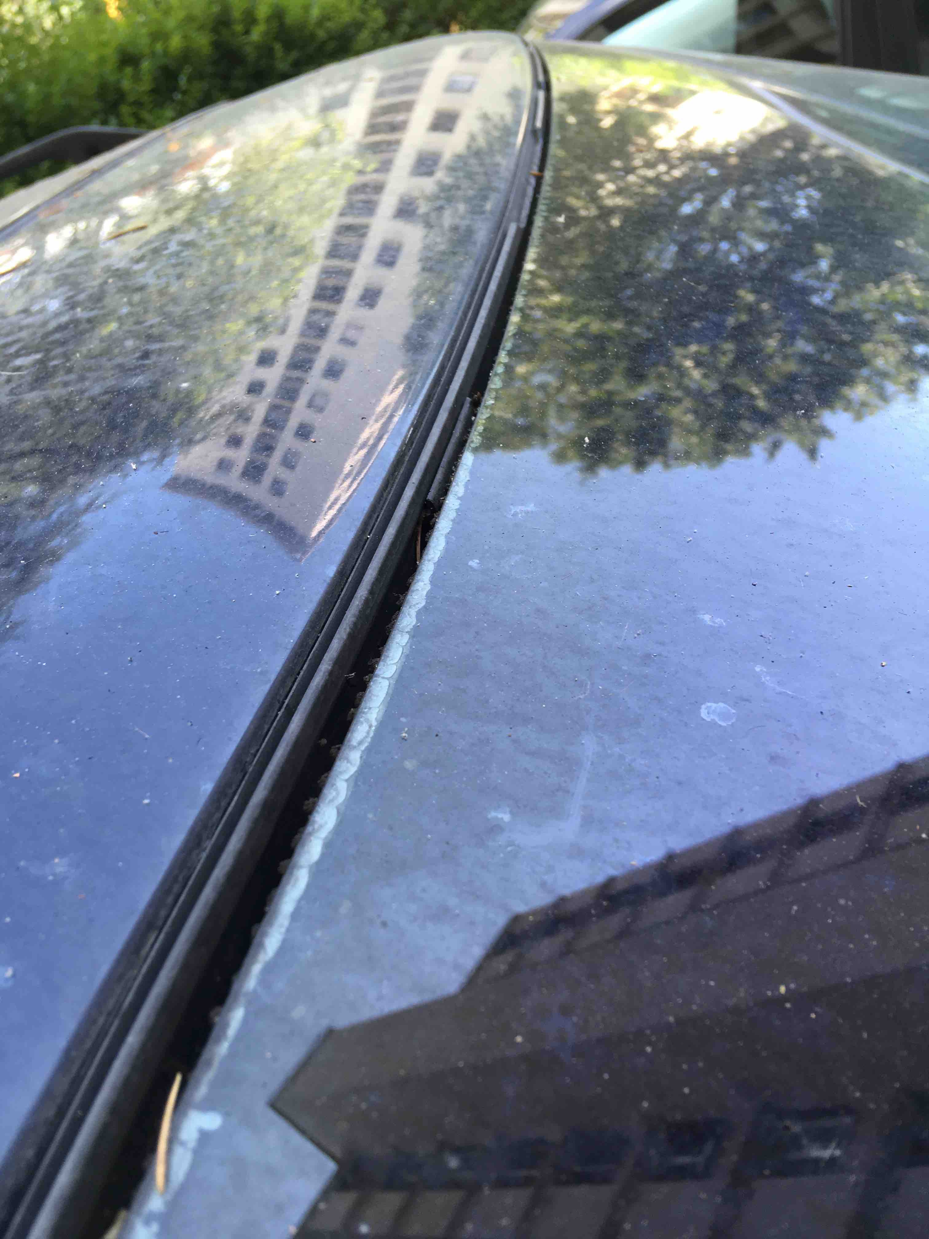

Post by manovlov »
Hy Guys,
I continue to repair Blue.
New question : Is this the correct part I have to buy to repair my windscreen ? and if so, is there a special thing to do to install thorium moulding ? Glue ? Or does it stand just by the action of installing it ?
Thanks for help .
Manov
Capture d’écran 3.jpg (44.36 KiB) Viewed 634 times
misha
Posts: 5379
Joined: 7 December 2008
Year and Model: '97 850 2.5 20v
Location: Serbia
Has thanked: 152 times
Been thanked: 402 times
Post by misha »
It should just pop right in.
It have inner lip which should be installed carefully in the groove.

manovlov
Posts: 1180
Joined: 6 July 2011
Location: Grenoble, France
Has thanked: 620 times
Been thanked: 143 times
Post by manovlov »
Thank for your answer. I will try to take the one on my V70. At least, it will a test to see how it goes.
Manov
Edit : the one I wanted to use is burn out . Let's order a new one.
