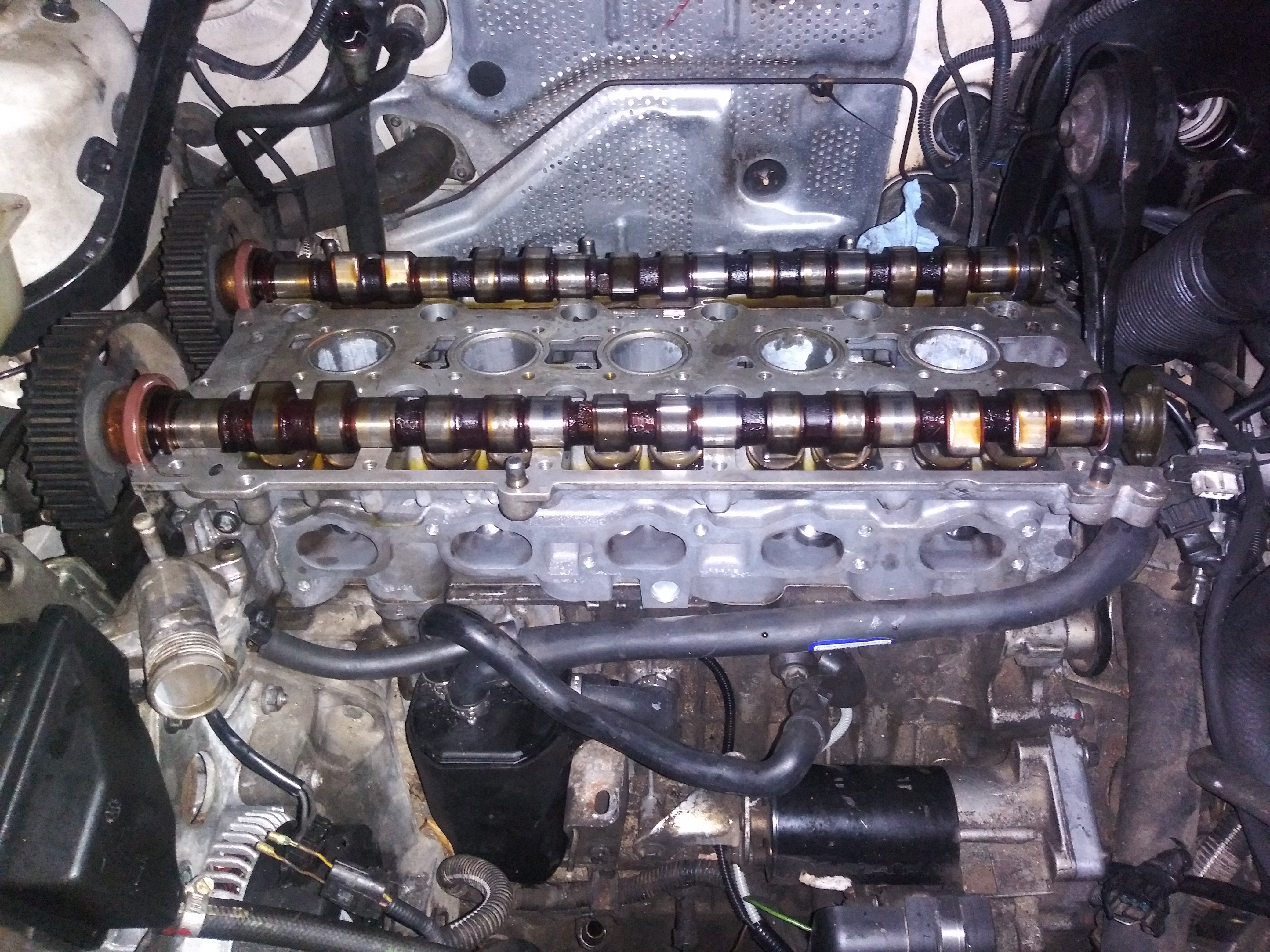

Finished rebuilding the head. All new volvo gaskets and stainless valves. Lapped and leak down tested. Spent the day putting it back on. Hopefully tomorrow intake and everything hooked up for a test run. On another note I ordered a reman master cylinder. I tried putting it on today and the rear line is too large if a fitting for the new one. The one ordered said it fit this model. Any thoughts?
Here's a pic of the newly rebuilt head installed.
Posts: 36162
Joined: 17 Feb 2013, 17:54
Has thanked: 1611 times
Been thanked: 4075 times
Good work. Put towels in every open port or hole until you are ready to cover up.
A m6 washer in the wrong place in the engine internals can undue all that work in 1 revolution.
