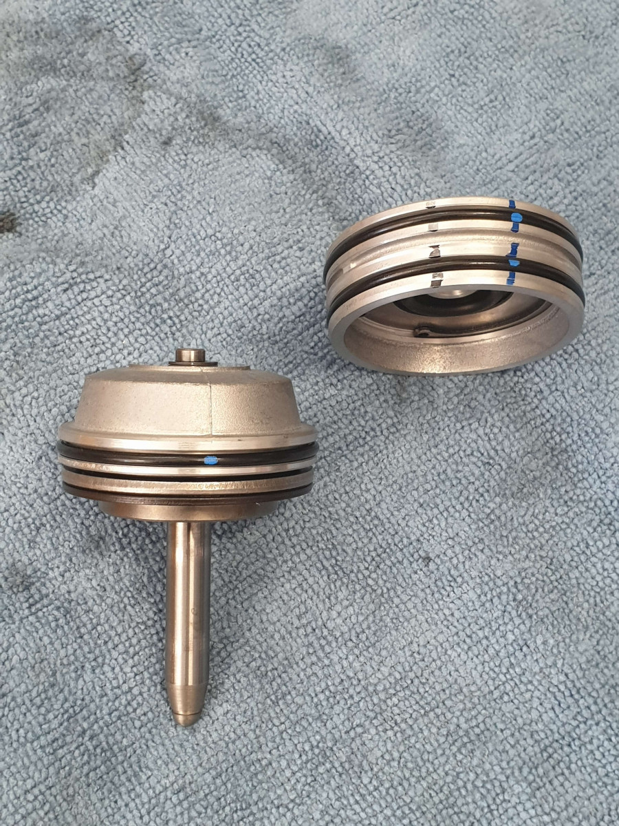

How's your B4 servo pin doing?
greffel
Posts: 126
Joined: 10 January 2020
Year and Model: 2003 S60
Location: Sweden
Has thanked: 11 times
Been thanked: 7 times
Post by greffel »
This is what it looked like 1 year ago when I changed the B4 servo cover.
The only thing I remember from that job is that the servo pin was hard to push in and I had to use a little bit of muscle power to get the servo cover all the way in.
What does the servo pin actually do ?
I cant remember that there was a spring inside or putting a spring back in while assembling :shock: :shock:
