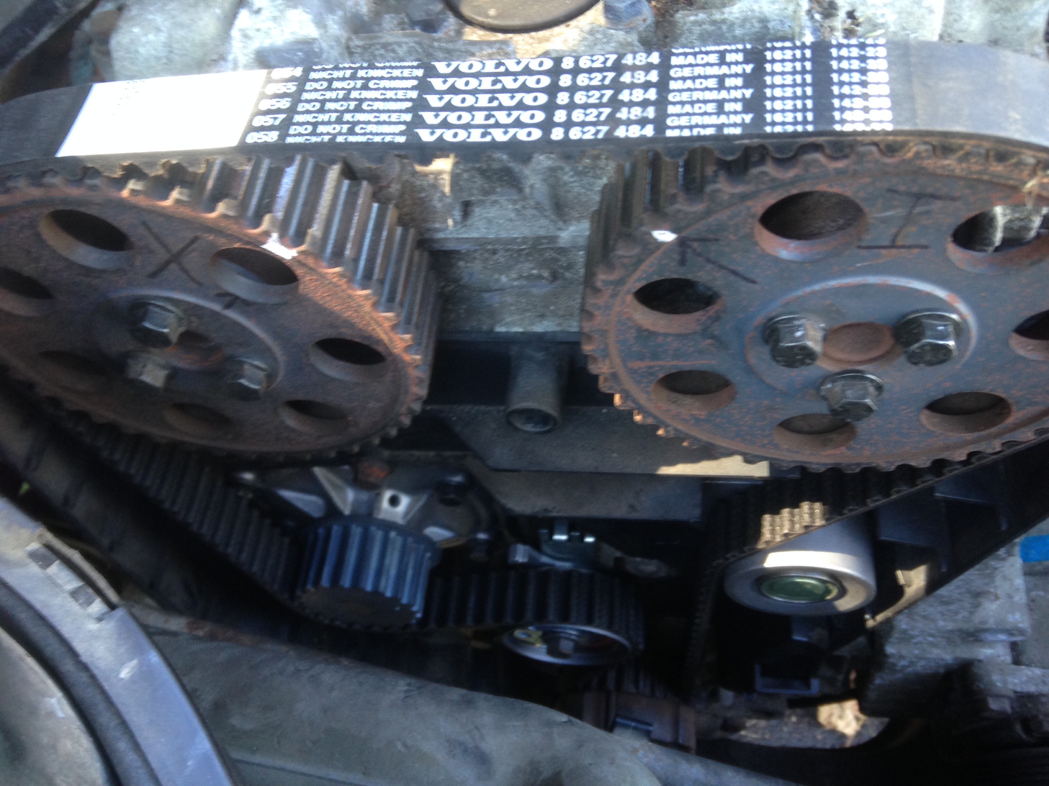

Grunhilde turned the corner of recovery today
New timing belt, tensioner, idler, AISIN water pump
Dropped a battery in her, fired her up and she purrs like a kitten. No codes.

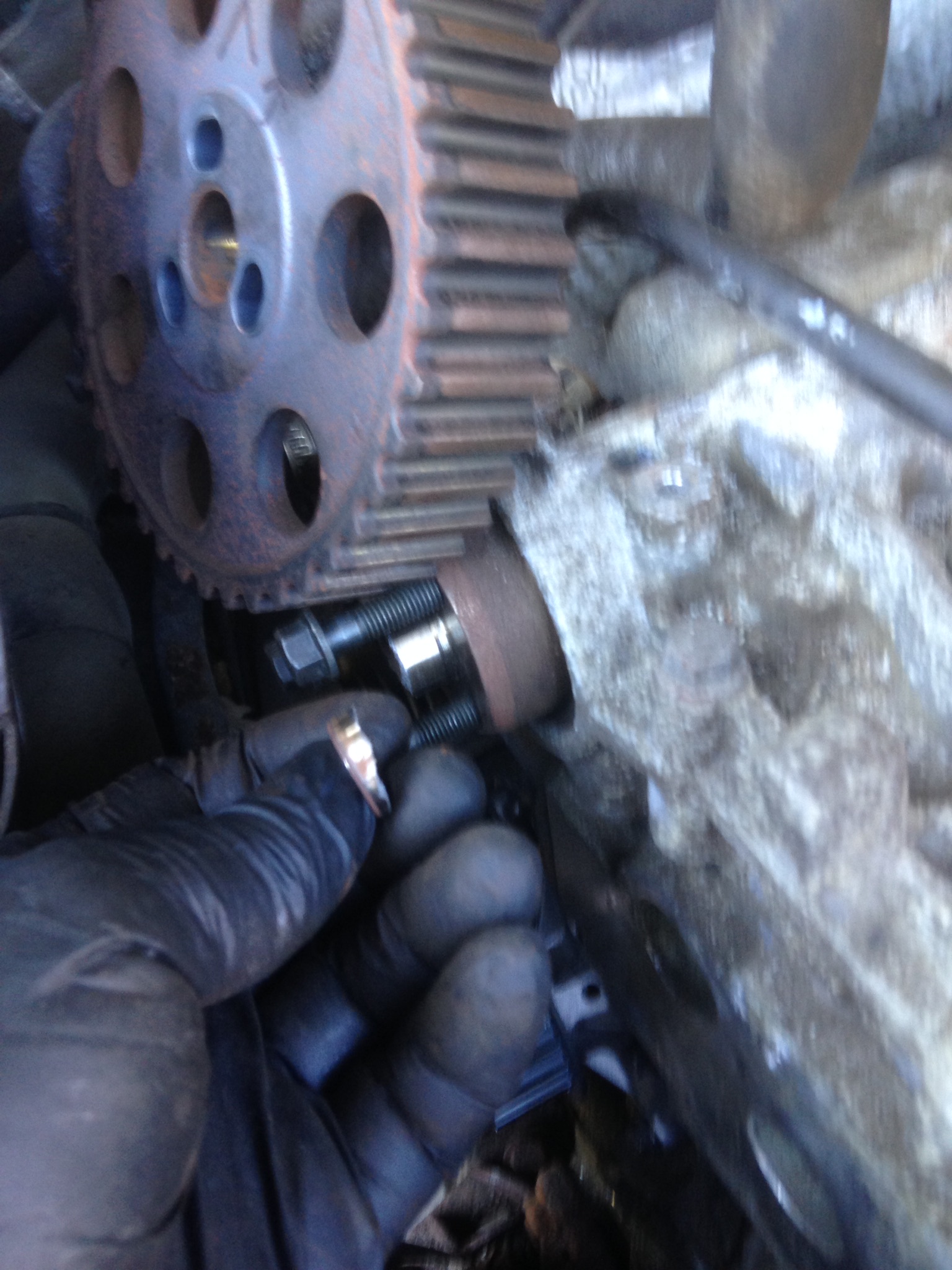

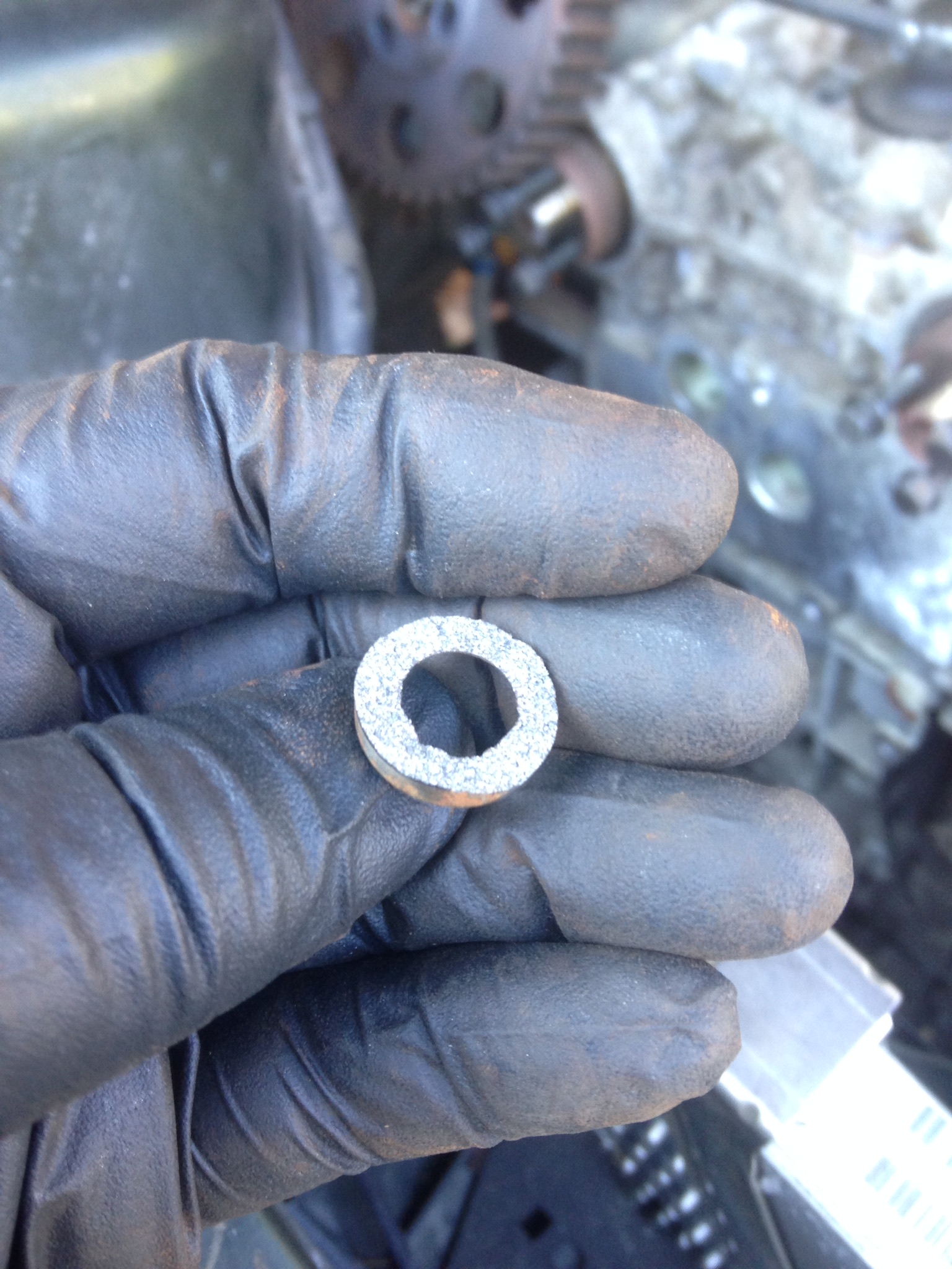

I did snap the end of the exhaust cam off though....no foul.

Deetz about cam breakage? Can fellow travelers avoid this fate?
- Posts: 6506
- Joined: 19 Jan 2014, 09:51
- Has thanked: 987 times
- Been thanked: 1075 times
Likely the rust weevils again.
