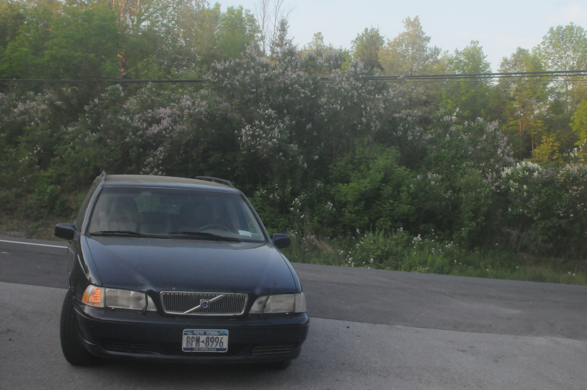

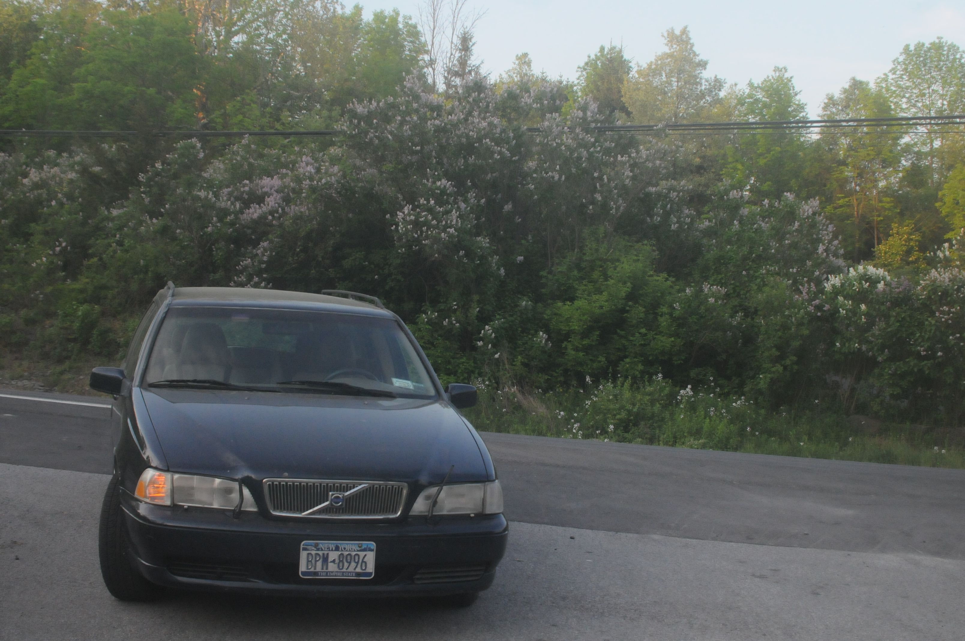

abscate wrote: 01 Jun 2021, 05:07 Threw the Battery switch on Shaggkira to mitigate current drain. I have a tailgate light that sticks on and runs the battery down, have to hunt down the switch or wiring fault.
It’s not the best solution because disconnecting the battery is runn8ng the fuel map cold but so goes the war.
And about those headlight wipers...
Gives the car that quizzical eyebrow look. (Or an evil frown.)
