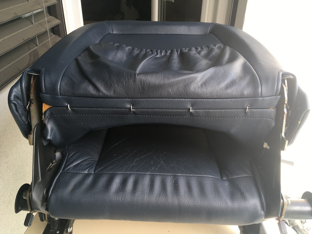

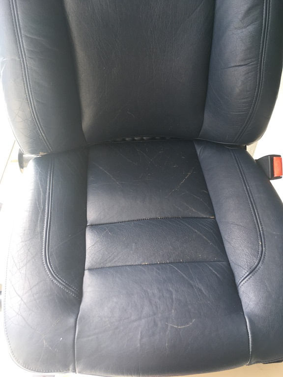

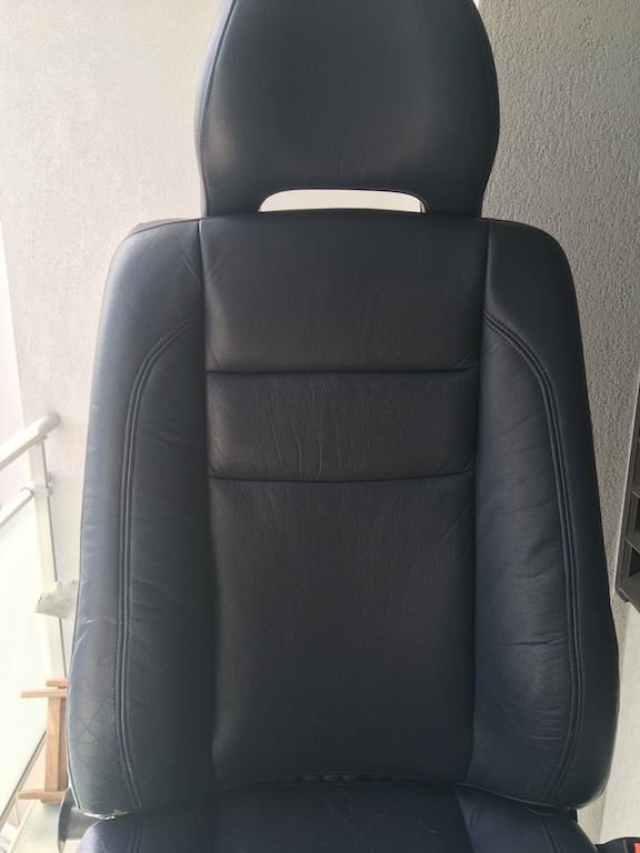

I extracted the passenger front seat, washed and let it dry. Rather in good shape. Here's the result.

Looks like it came out really nice!

Yes, the passenger side looks in general enough clean. The driver side, on the other hand...

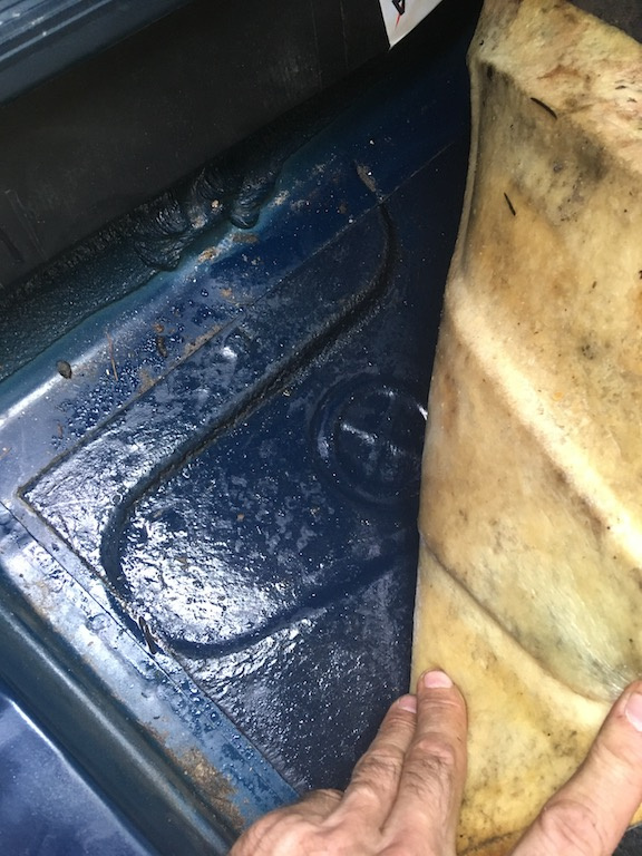

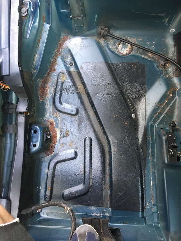

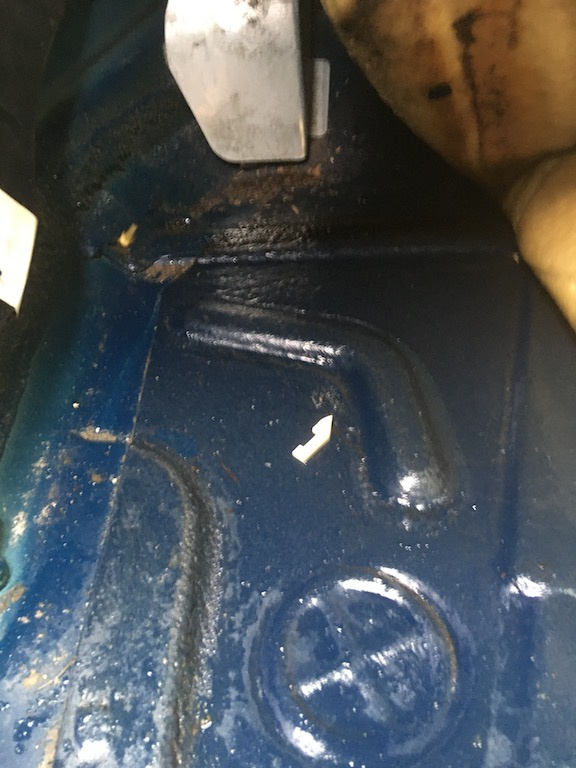

Today, I take out the mats, and everything is ok except under the feet of the conductive mat, water. The insulating foam is soaked, and the carpet too, but just a little, at the bottom in the lower corner. The nozzle that runs under the windshield was blocked by leaves and mud until Friday. Last Sunday it was a great storm. Could that explain this? Unless the windshield clown ran out of glue again?
The rest of the floor is dry and very healthy except for some non-piercing rust : What stuff do you recommend me to treat these rust points ?

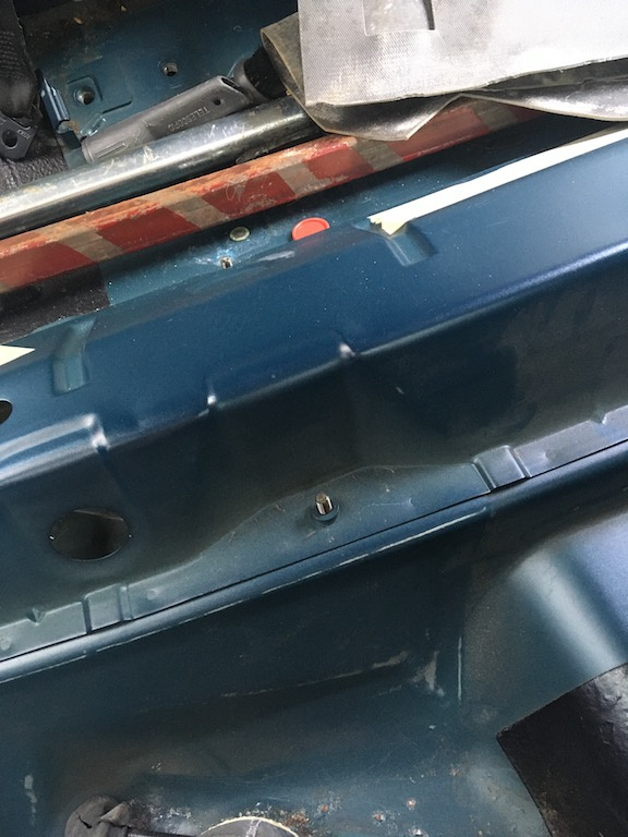

What is that bolt for ?

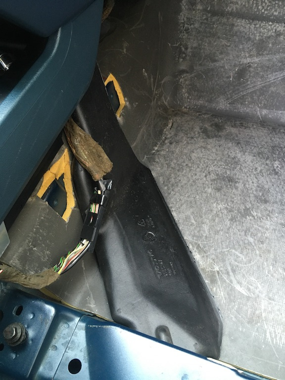

How do you get out this cable tunnel to extract the soundproofing mat? Do you have to remove the center console?

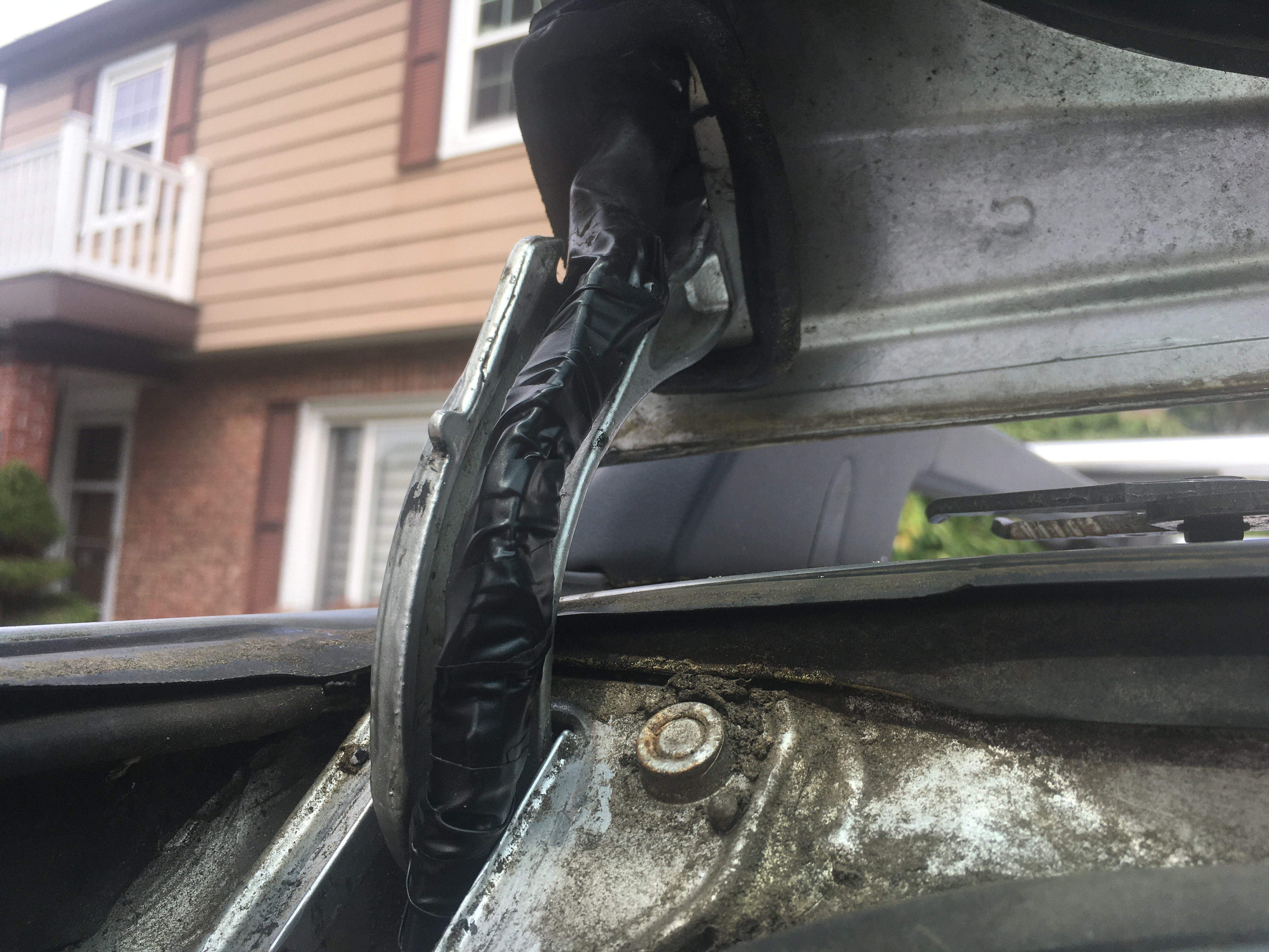

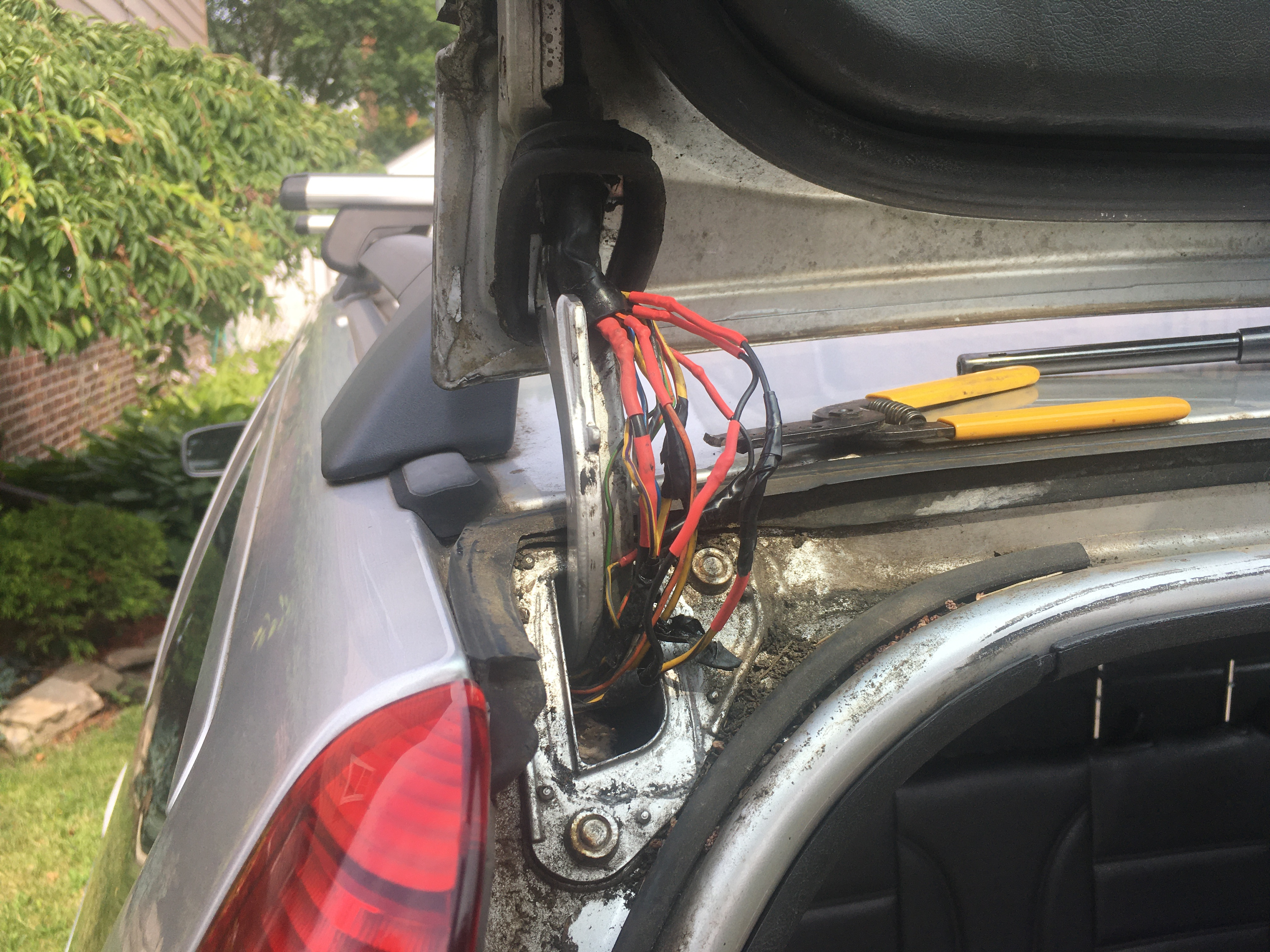

This week my rear wiper went out, and then the lightbulb indicator dash light began lighting up when braking. The bulbs were fine, but the several hatch wires had snapped.
I soldered and sealed them, then wrapped them in some electrical tape. Testing it out, the wires still had a tendency to bend into the path of the lift support. So I taped the whole thing down, and that seemed to do the trick.

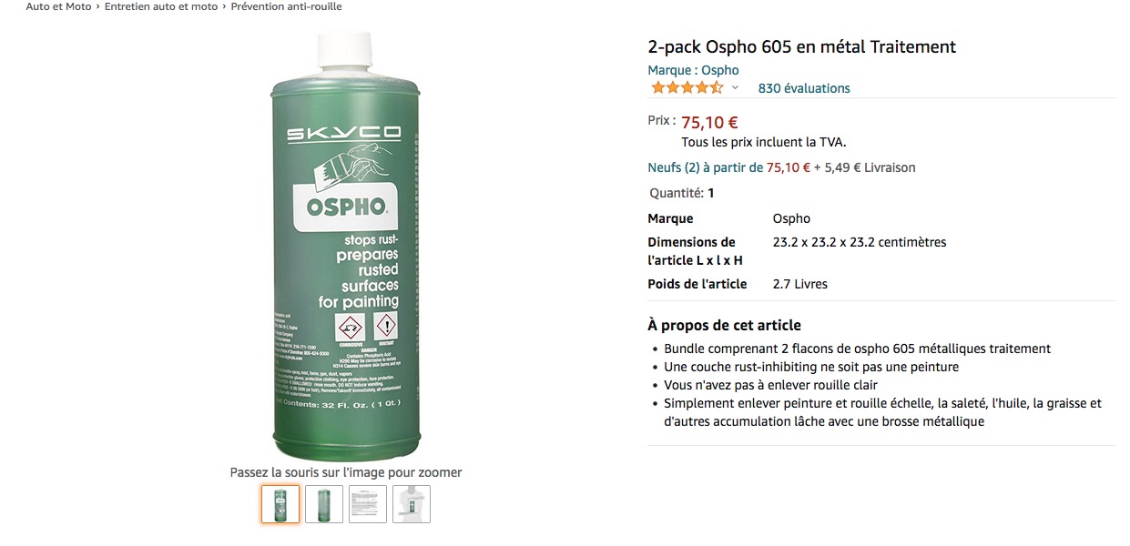

That bolt is for the carbon canister bracket, I believe. I just dealt with that on my car. As for repairing that rust, I would recommend a product like OSPHO, which is a rust inhibitor.manovlov wrote: 25 Jul 2021, 10:59 Yes, the passenger side looks in general enough clean. The driver side, on the other hand...

The good news is that the leaves built up in the drains will certainly cause water to get into the car. I've had that issue too, I was relieved when I didn't have to reseal anything!

Thanks a lot for your experience feedback. I don't really worry about the water, it was so few that it could be a leaves issue.bmdubya1198 wrote: 26 Jul 2021, 10:20
Ospho, i don't know that stuff... but as far as i can see, it's out of my budget. I will keep the RUSTOL idea. I will charge my Makita with a steel brush to clean the surface.

Phosphoric acid does some Magic conversion thing, I use this stuff. Don't know what is available over there.
