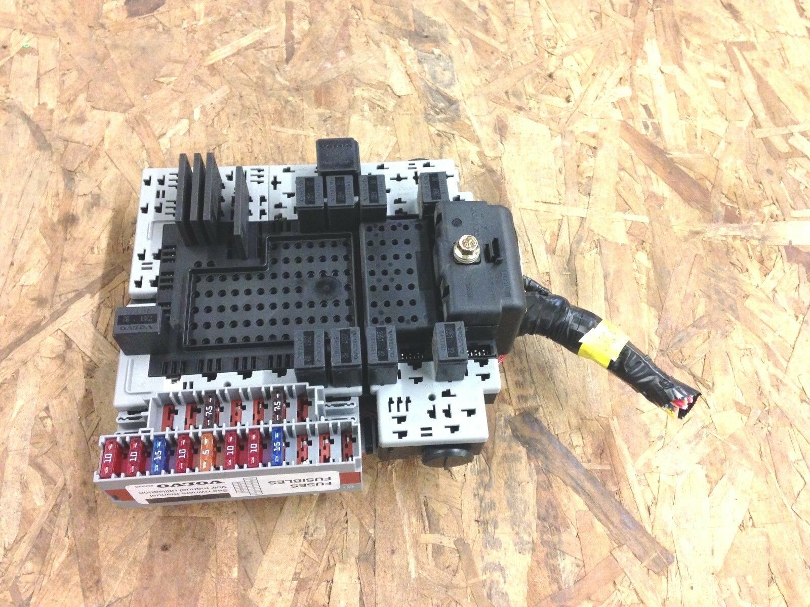

With K-Line chip the cracker is able to talk to donated (thanks!) CEM-H:

Thanks to a correction and a proof from T5Luke, Part Number: 000008688513 is what I am now calling a CEM-B for the lack of any better term. Pre-2005 P2 CEMs. CEM-B are Brick shaped not L shaped.vtl wrote: 18 Apr 2021, 23:05 With K-Line chip the cracker is able to talk to donated (thanks!) CEM-H:
The CEM-H is one of two hardware flavors of the L shaped CEMs use post-2004, 2005 - 2014 depending on model .
If anybody has another idea for terminology, speak up. What matters the most is that we have a consensus on what terminology is used.
P2 CEM-B P2 CEM-H P2 CEM-L
