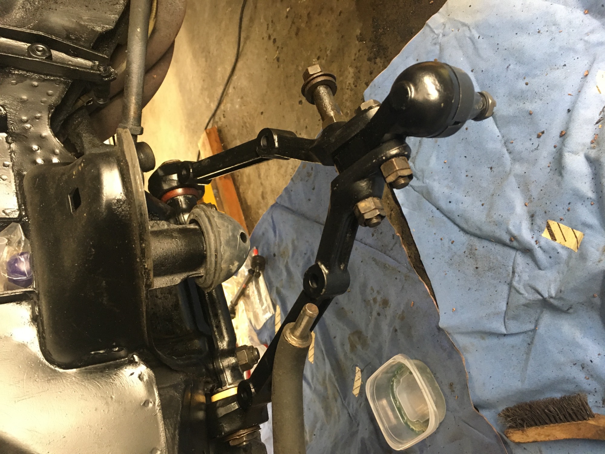

Making incremental progress on the Alfa suspension.

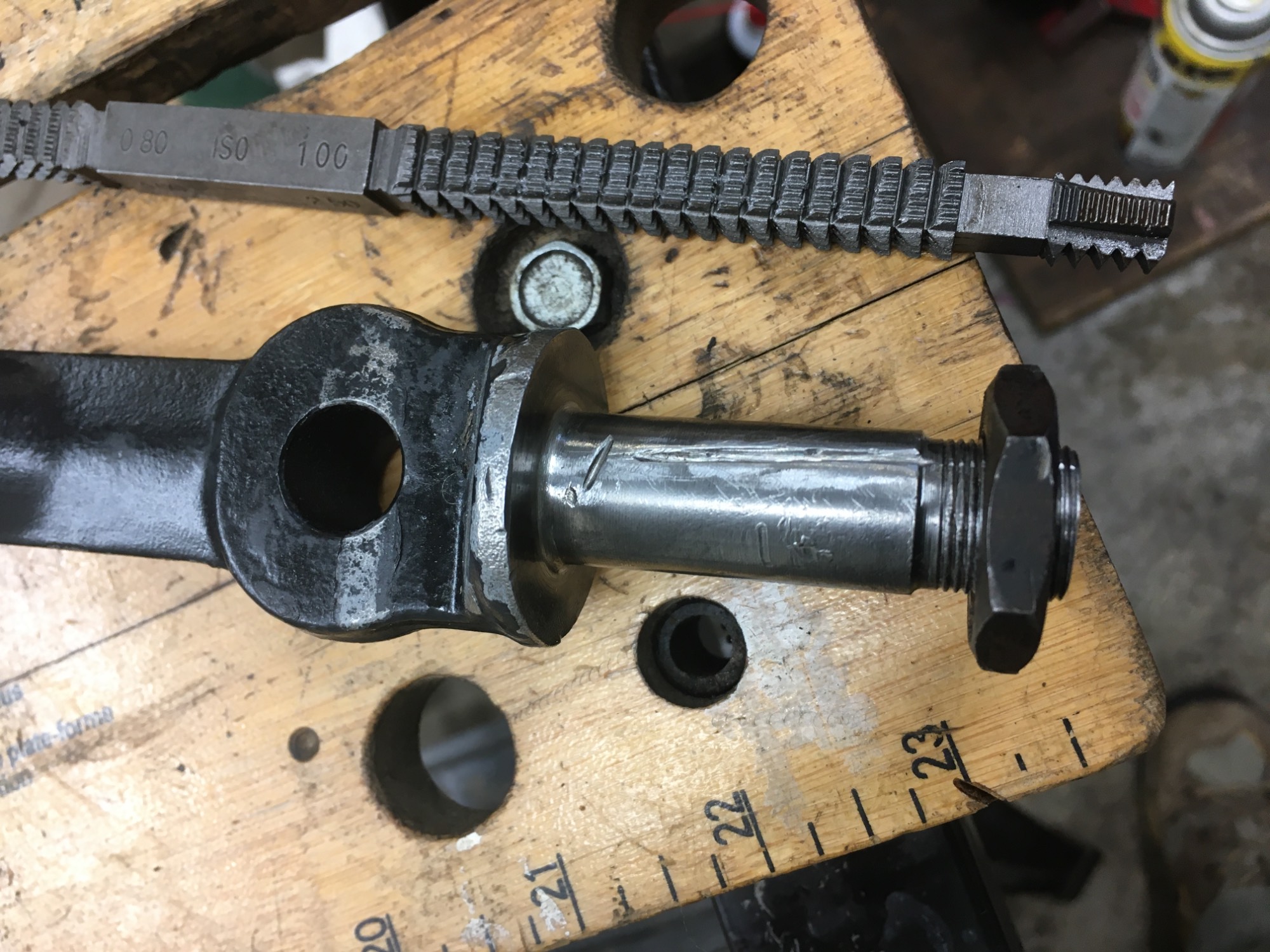

Pushed the lower control arm bushings (spherical bearing here) in with a big hammer and big sockets. Slow and careful.
This cool German thread file arrived, and I cleaned up the threads on the control arm spindle so the nut spins on. Cleaned up that dremel cut I made with a tiny fine file.
Lower wishbone together and installed. No cotter pins installed anywhere yet!

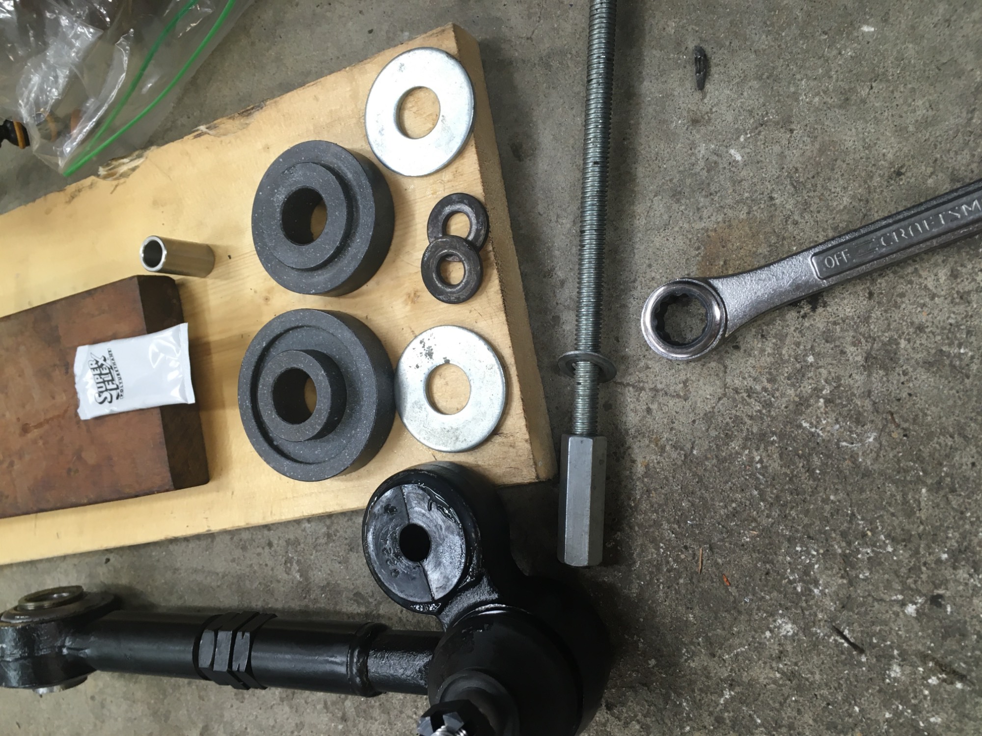

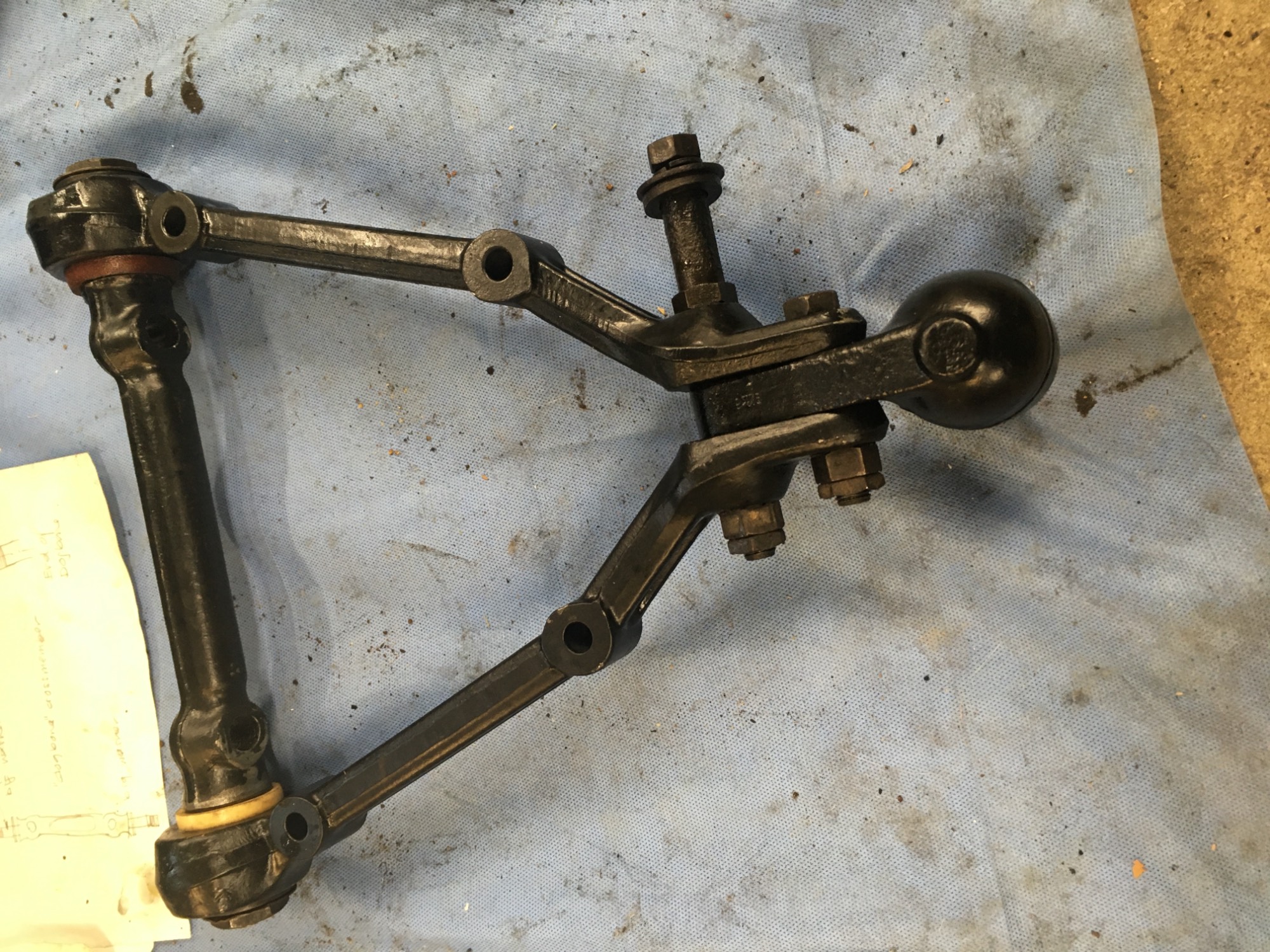

I did Ye Olde drill-out-the-rubber, hacksaw the outer shell, and chisel the bushing out of the upper control arm. These are new adjustable-camber arms I bought 20 years ago, but they come with lower quality rubber bushings. The Alfa trick is to put a spherical bearing (same as the lower control arm bushings) in.
Then push out the rubber caster bushing and put a poly bush there. I was thinking how I'd shove this greased poly bush in there with pliers and screwdrivers and end up cutting it.... So I looked around and ah ha, I used the threaded rods used to raise the spring pan, some random big washers, two of those round plates from a HF wheel bearing kit, and it just slipped right in. Then you tap in the steel center sleeve.

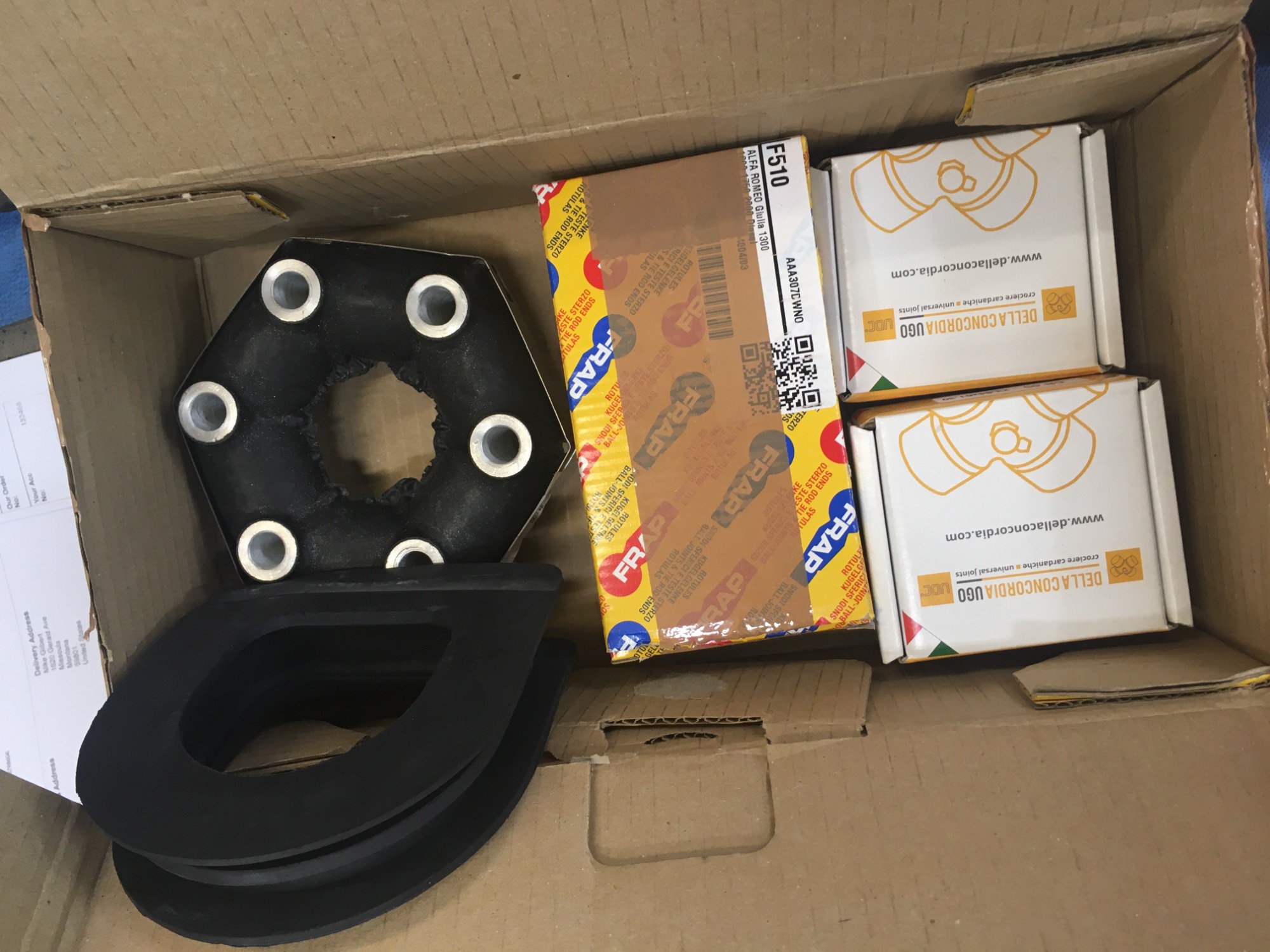

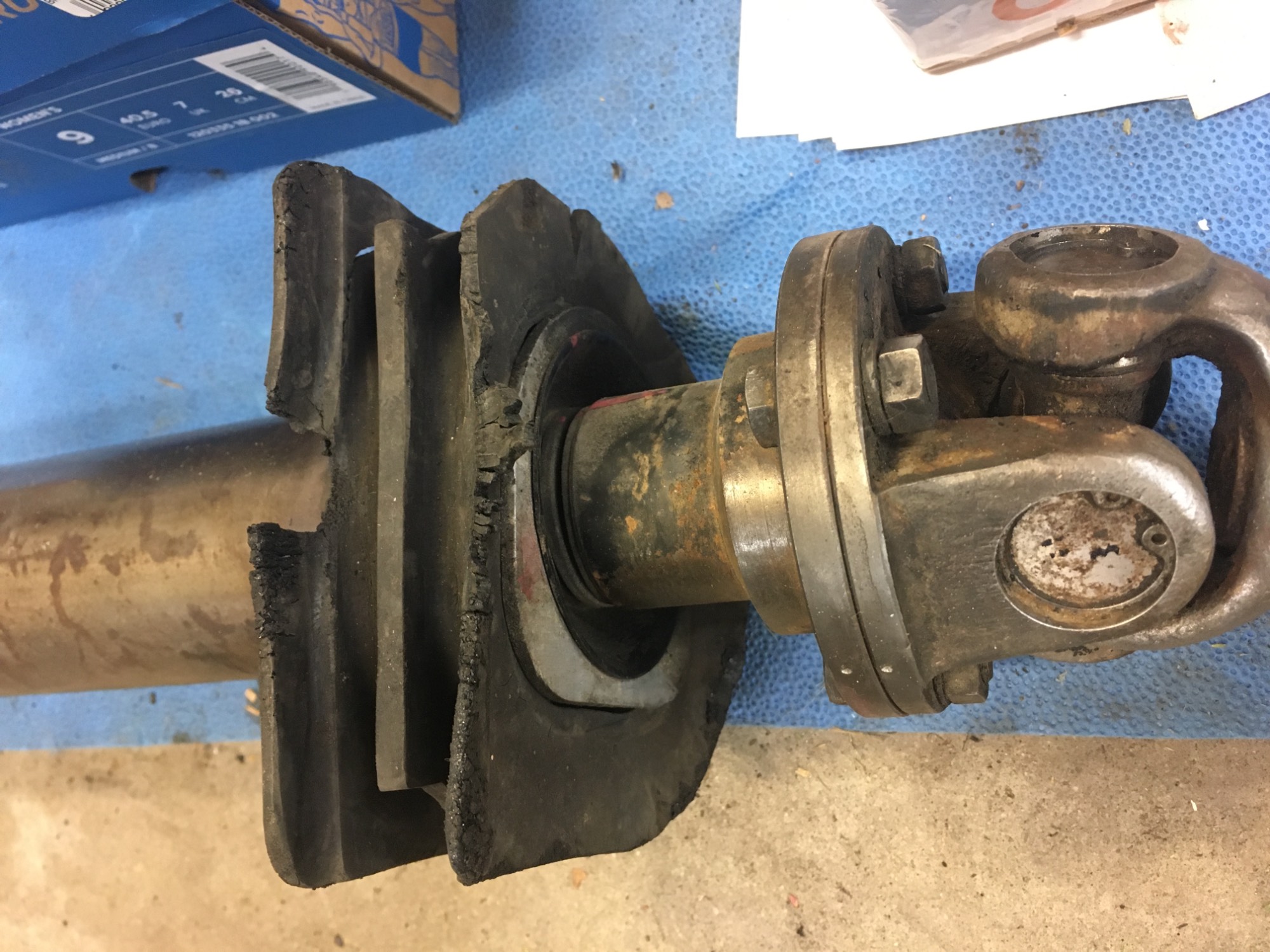

Got a new box of driveshaft goodies - U-joints, carrier bearing, support bushing, "Giubo" rubber donut, transmission tailshaft bushings.
Ya think this carrier bushing is done? You think it's original and lasted 55 years?
