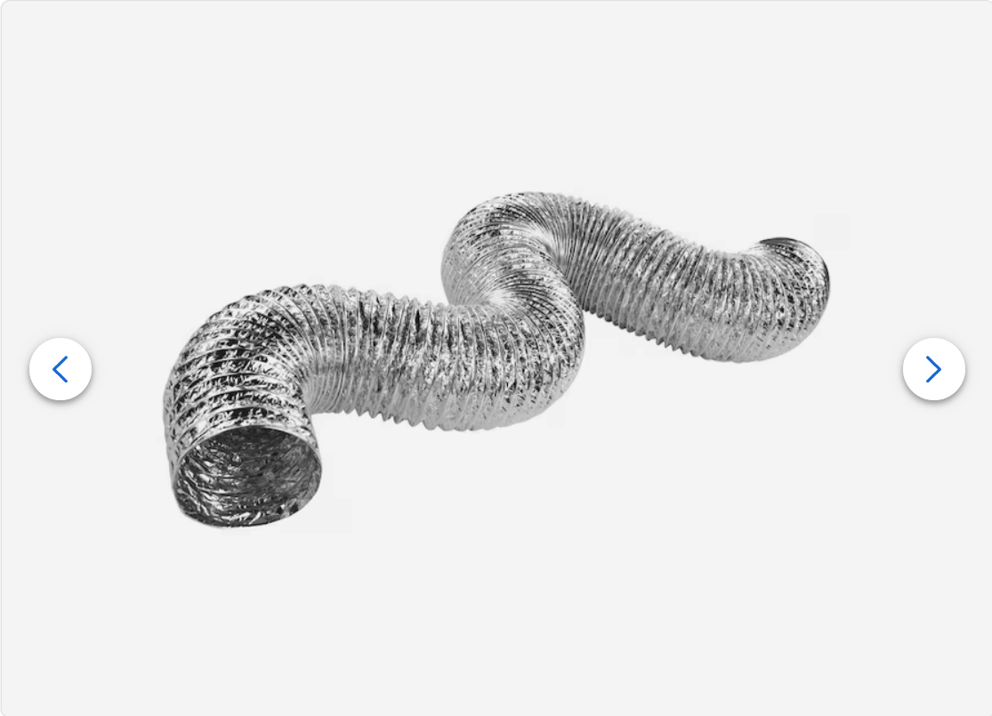

The gutters were overflowing again a week or so ago during the down pour. It's a continuous U shaped on the second story with 4 down spouts. Only one didn't go into the ground. Took an electric blower and blew air up the one above ground. Huge mistake as water and debris blew up and over then down all over me but there was good flow so for now at least one down spout is flowing.
Going to Lowe's tomorrow for a 16' dryer flex hose to attached between the blower and gutter cleaning kit. I'll be on a ladder while the person at ground level will turn the blower on and off.
Today, I cleaned a small section of gutter which I can reach half hanging out the second story window. Used a 5 foot 1 inch PVC pipe with a brush duct taped to the end to break loose, gather and pull the debris to my end near the window so I can physically remove them. The rest of the dust I used a blower. Was able to fill half a 5 gallon bucket with water and tossed it over on to the roof and drain down the gutter.

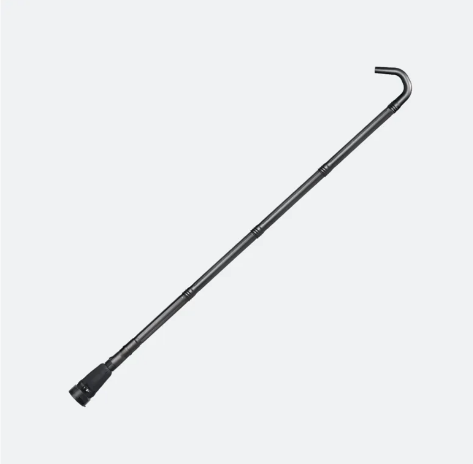

Had considered purchasing 2 - 10 foot sections of 3/4 PVC pipe with a U and reducer at the top and garden hose connection at the other end. The U shape would hook over the gutter as I drag it across with the water flowing to clean. If the dry cleaning doesn't work then will use this method.

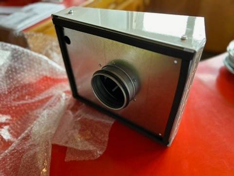

Amateur fan replacement - (Sveedy look away from non-professional construction!)
When I helped put a new roof on my nearly flat roof last summer, we discovered the bathroom fan blew up, not to a vent hood, but INTO THE ROOF VENT cavity! Smart! Someone on a previous re-roof must have capped off the outlet to make roofing easier. Crazy.
I tried to find a modern fan that would fit in the existing wall box and blow OUT. Couldn't find anything but impeller blades, nothing was compatible. So I bought this nice commercial grade Fantech brand exterior fan that sucks through the wall. I wanted to not take apart my interior wall and re-sheetrock, so I tried to use the existing box location, keep the inside grille.

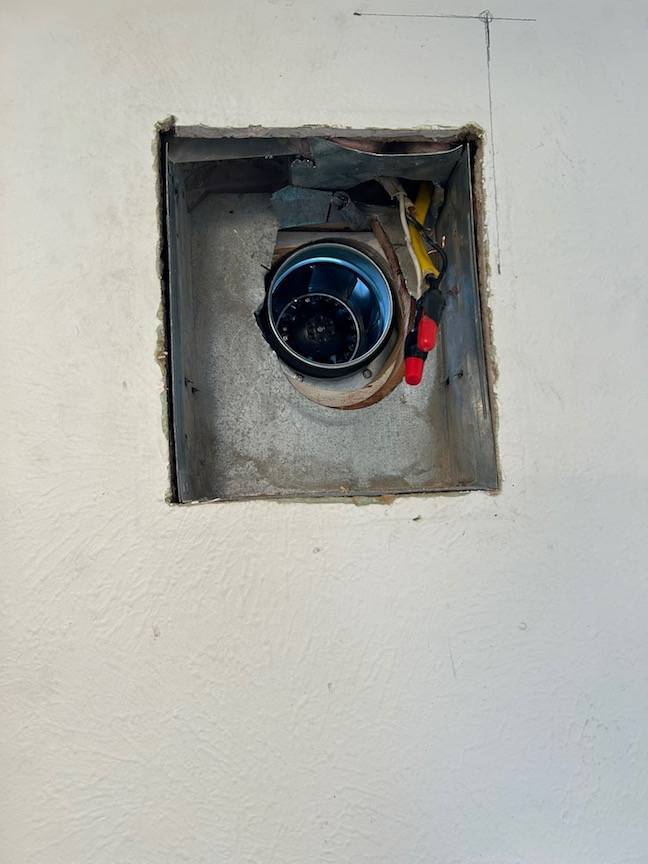

Cut up the box, remove the old fan.
Cut a hole through the back of the box and wall. Found the existing electrical. Then couldn't find a push-through fan that worked. Of course the new fan inlet hole is in a different spot.

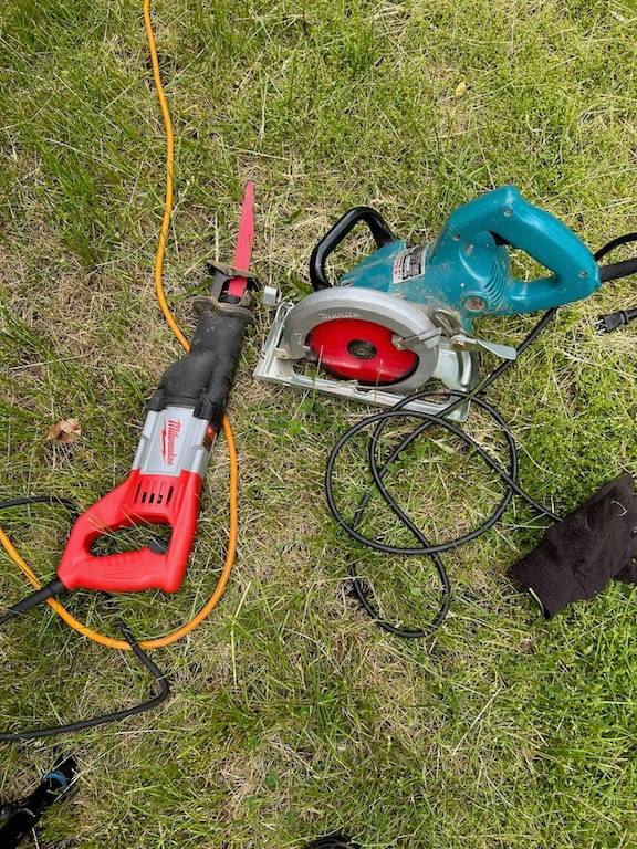

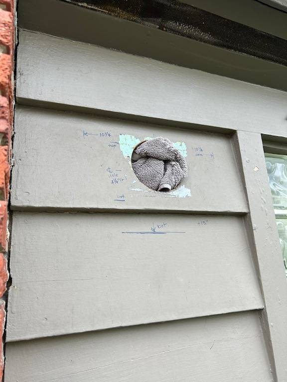

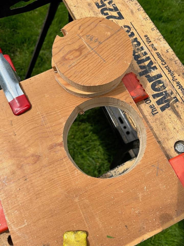

Cut the siding down to the sheathing with my friends Makita and Milwaukee....There are better tools for doing these cuts but these are what I have...and a wood chisel.

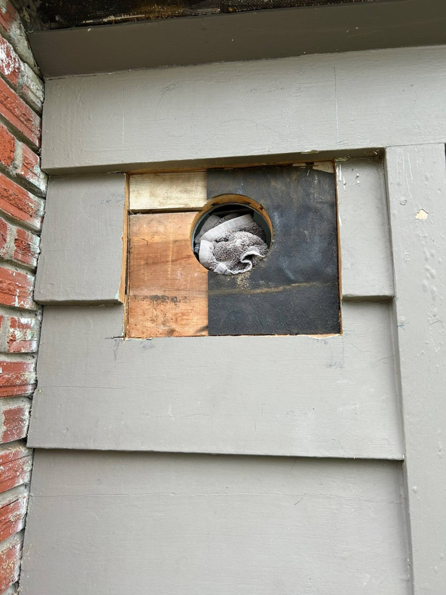

Cut holes through two layers of board to make 1 1/4" flush platform at the upper trim band.

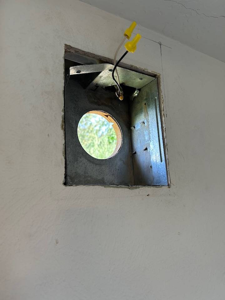

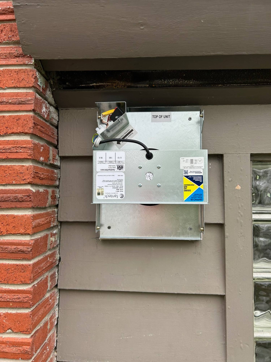

Test fit, raised the hole, did some truly ragged jigsawing of the metal. I don't need the box itself, but it goes upwards inside the wall. I just need the rim that holds the interior grille clips. The pencil centerline is where the power needs to feed at the outside wall, so I cut up the box lid so I could drill a diagonal hole through the framing for wiring.
Primered the boards, lined everything up, installed the fan housing and pulled the Romex wiring through the wall.
I'm not an electrician! But no smoke, no sparks, no one died!
Just needs some caulk and painting. I like it, it starts slow and winds up to full speed, it's quiet, it moves a lot of air. Finally, a dry bathroom!

Sounds like many of my projects - many surprises and changed project scope.
