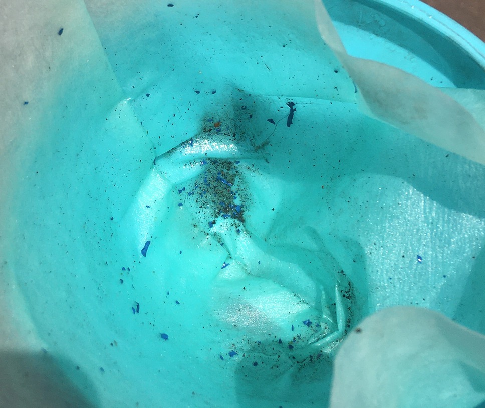

I replaced all cooling hoses. I think to be a good idea to replace also the tank...
I had the good idea to filter the coolant (less than 1000 kms), and here's waht i've found.Blue parts could come from an old gum seal on water pump ? or smal parts of blue silicon hoses ?

The blue could be bits of sealant if it was used anywhere like the water pump gasket, or it could be just general gunk. A new expansion tank would be a good idea, the plastic gets pretty weak over time.
