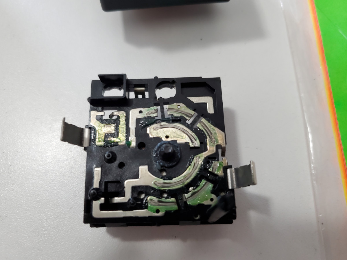

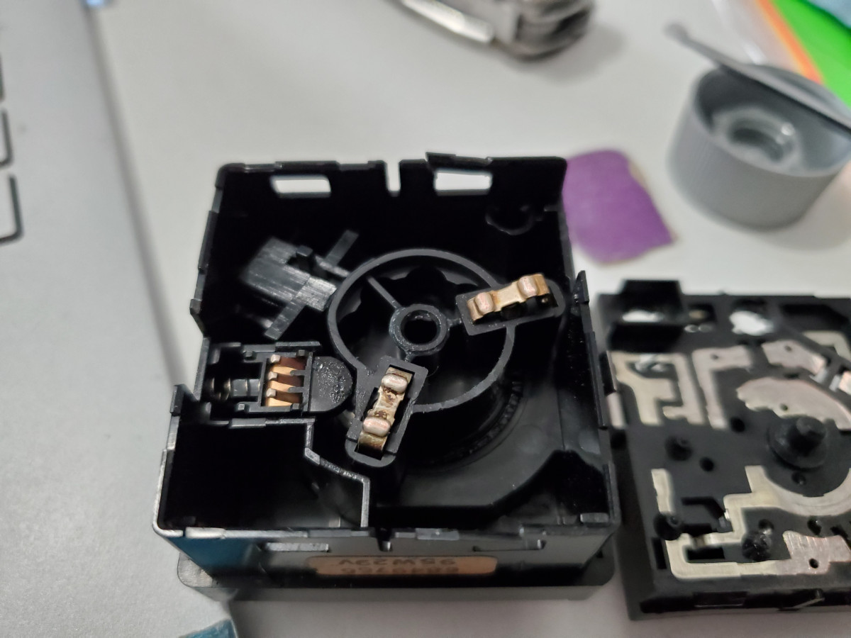

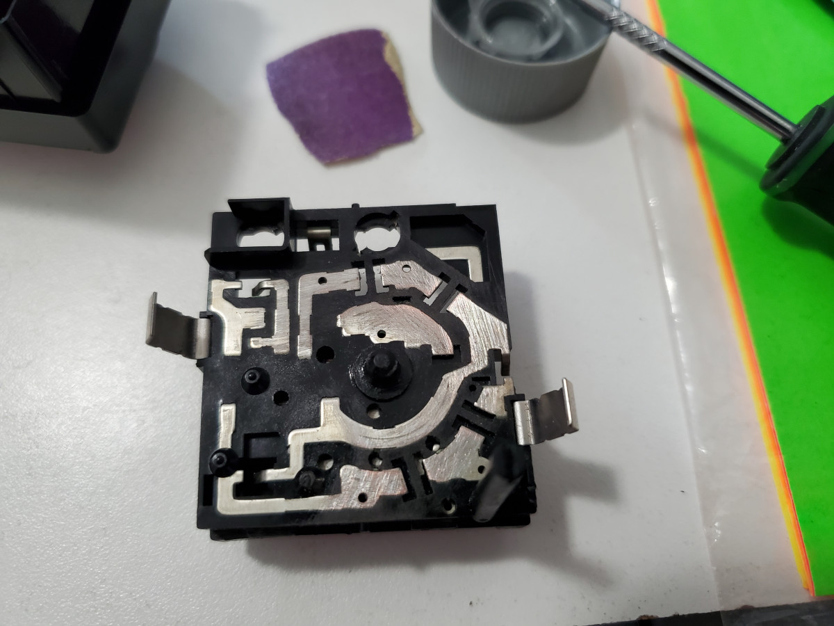

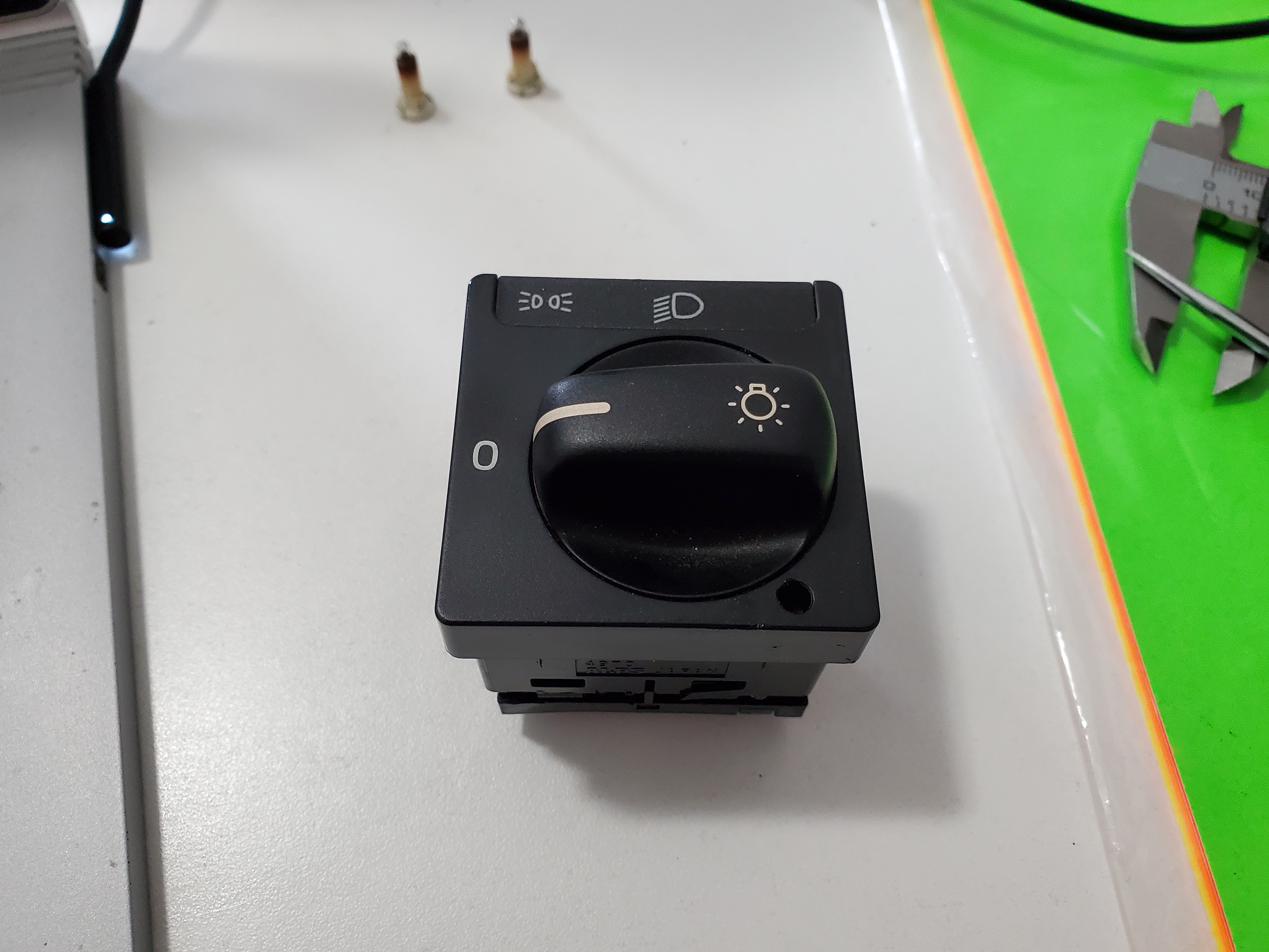

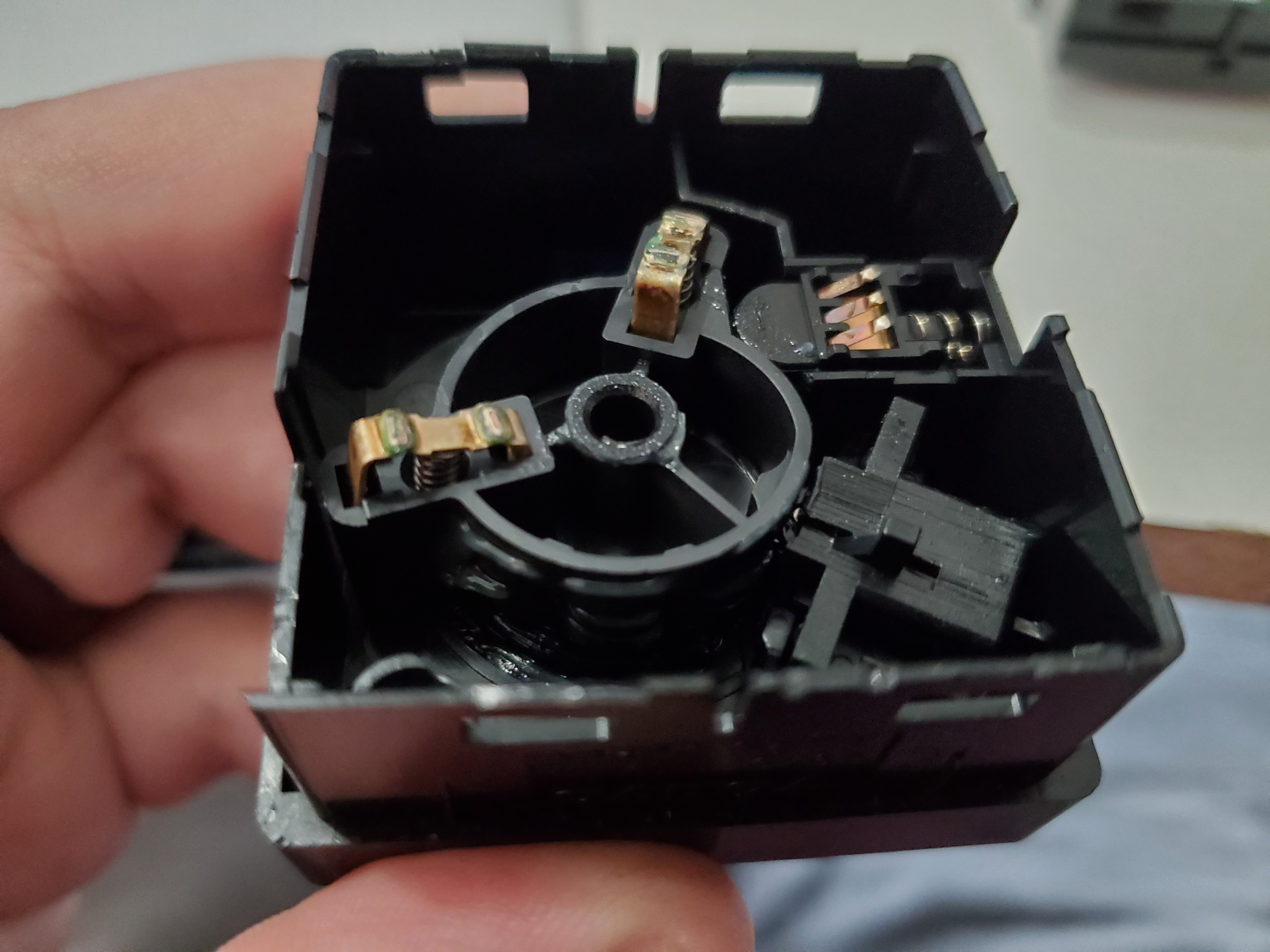

For the past few weeks my dashboard lights have not been working when the headlight switch is turned to the "on" position. So figuring out my speed at night has been super fun. Anyway I decided to tear apart the switch and clean it up. A little cleaning with light sanding and new dielectric grease has fixed the problem. Free fix if anyone needs it. Warning, the plastic housing will break when trying to free the tabs. Here are some pics of the before and after.

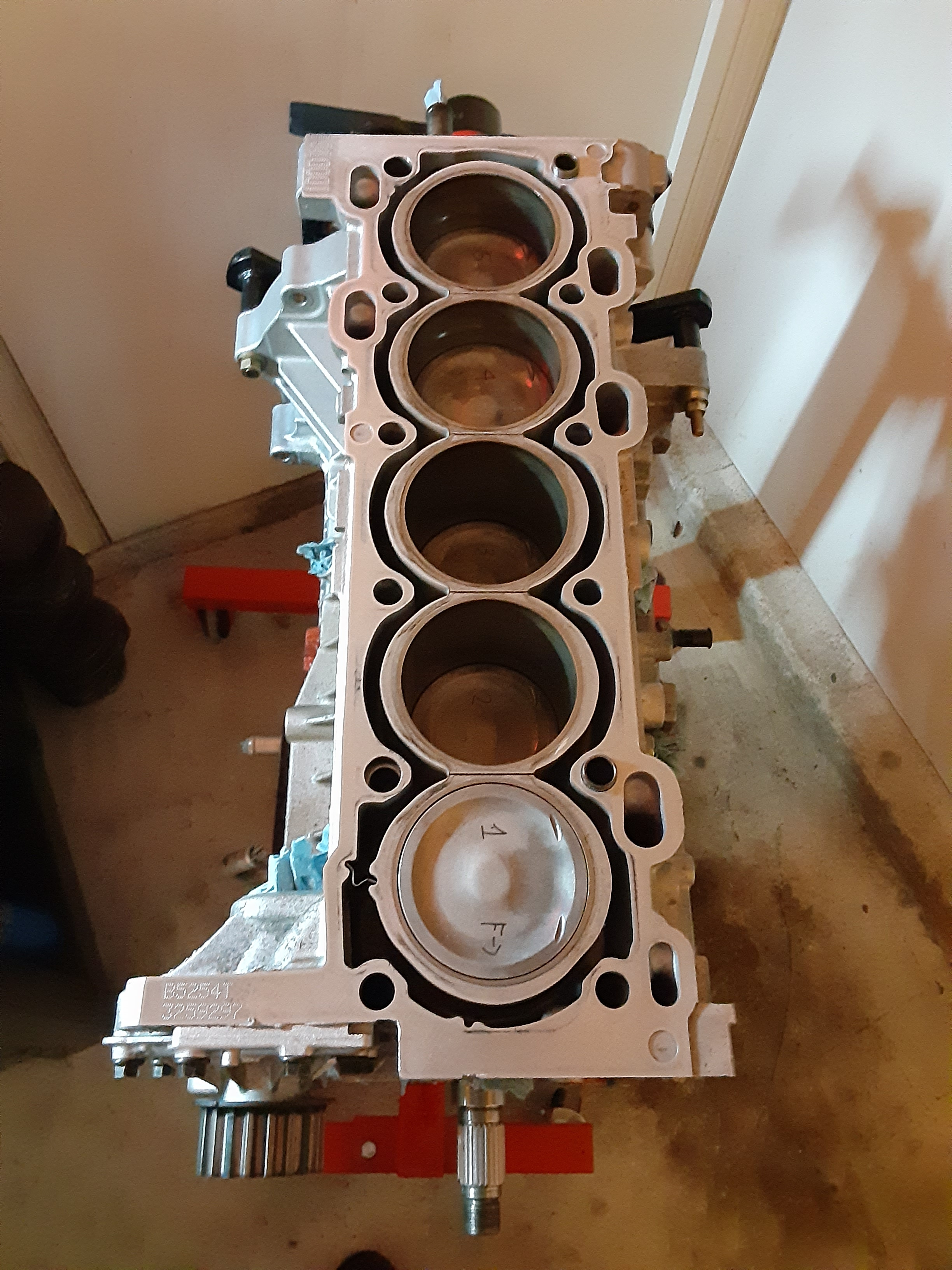

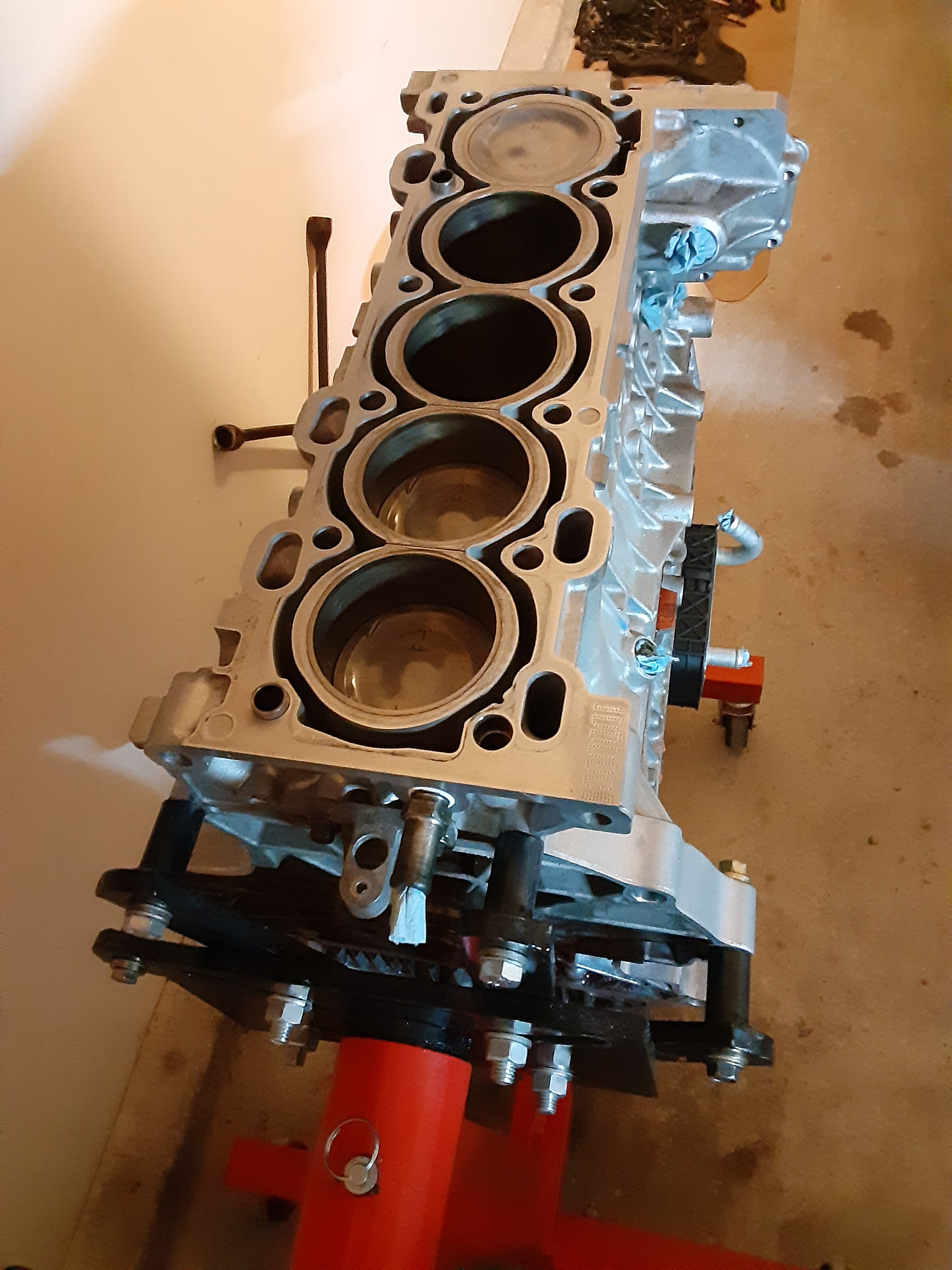

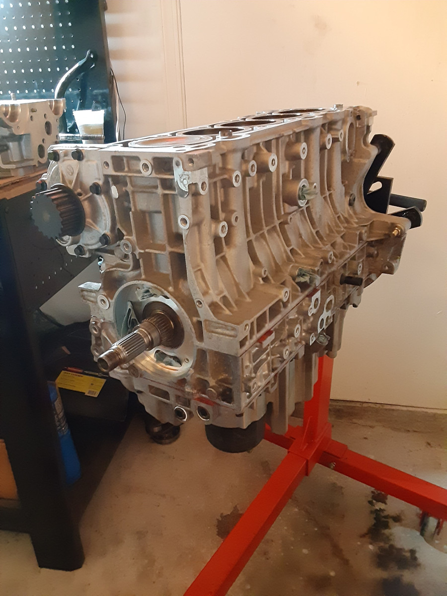

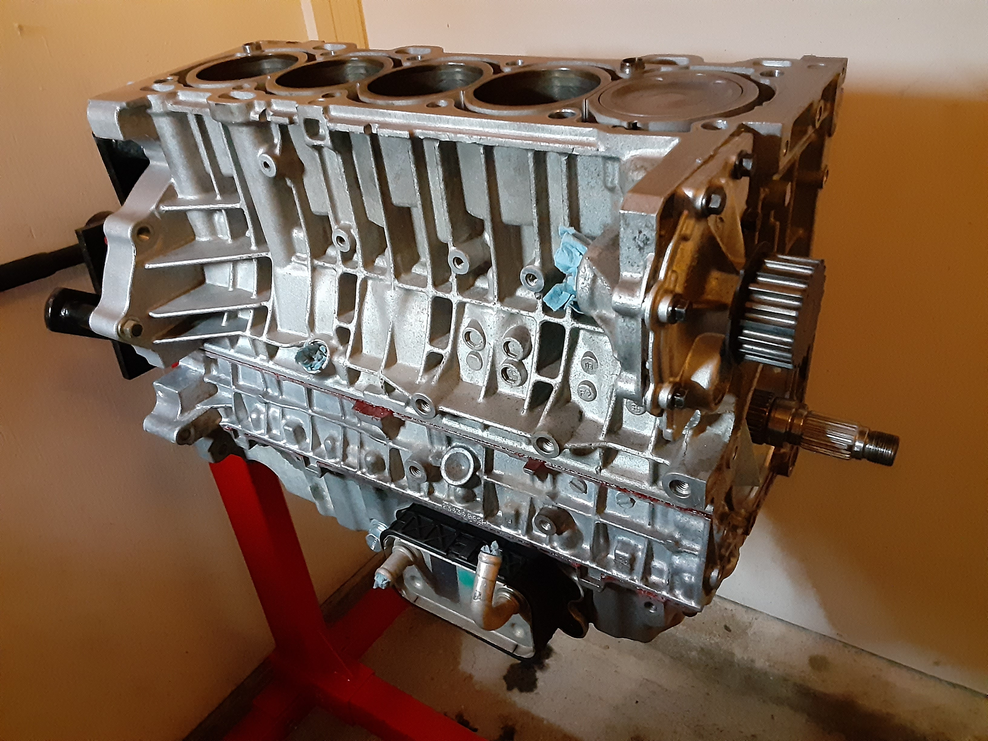

Added more stuff to the engine. Now just waiting for the head gasket and some miscellaneous other parts.
I'm getting closer. The anticipation is killing me.
