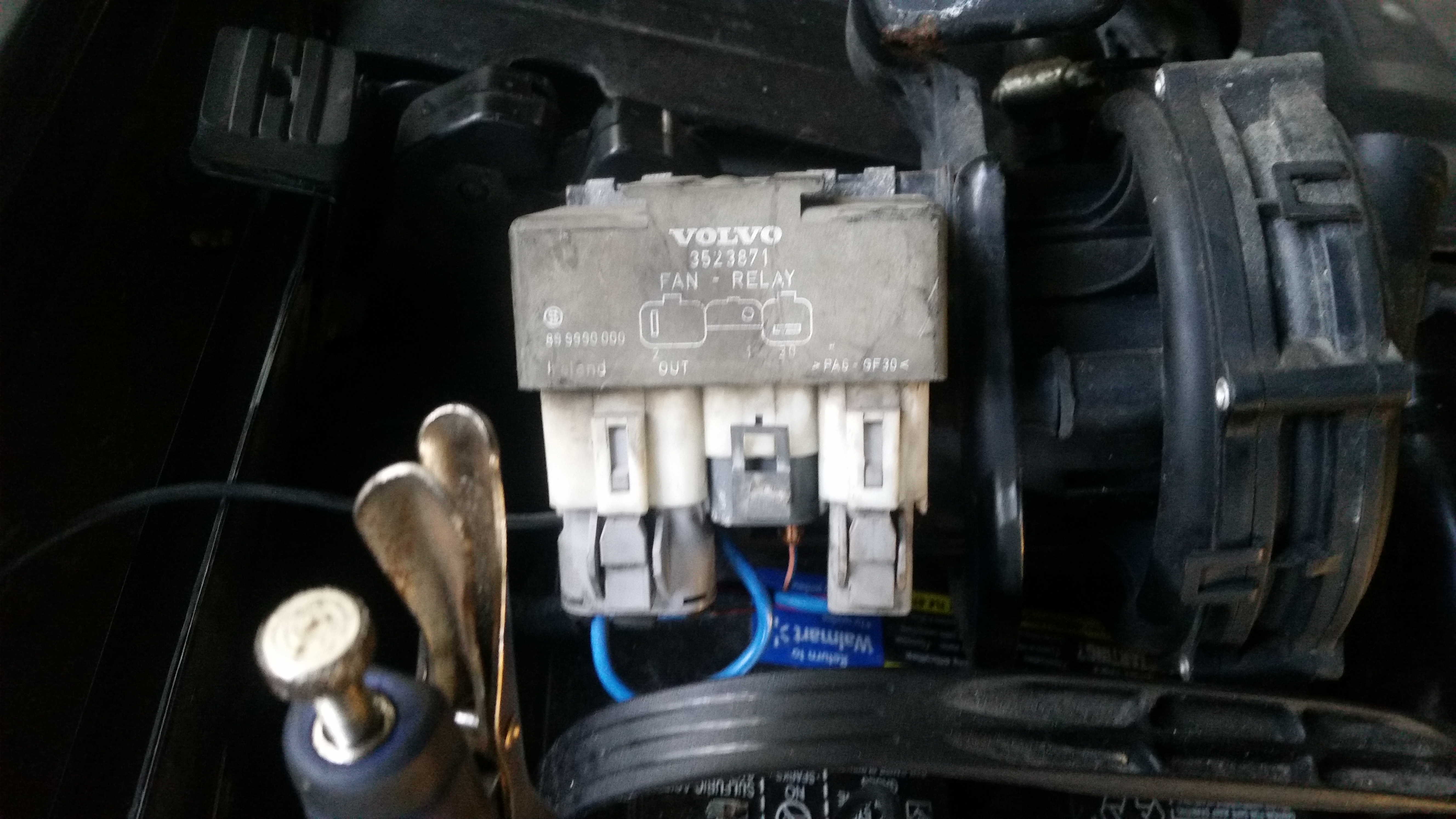

You bet! The car started and ran perfectly! At about 3000-3500 rpm it takes off like a jet. Either PM me or call me. I may just flash the the a/c on to it if its not to complex. I will be driving it with the OEM computer for now. Also I attached the fan relay from the air pump. I wasn't sure if it was for the air pump fan or the cooling fan.erikv11 wrote:I will make a longer reply either here or by PM but that is weird, the car is acting like it came from the factory with m4.3, not with m4.4.
Can you notice any difference between the original ECU and the T5 ECU? I thought I could but it was only moderate, however it has been a long time since I compared.
I ordered the OEM Volvo coolant cap and bottle. I have two days to wait. This car runs so smooth and guess what? That's right, no smoke on deceleration, its fixed. Now was it the radiator mixing oil and water or the turbo or the head? I'll never know.
