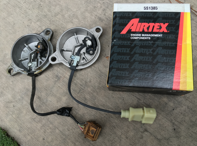

Sigh, today I changed out the camshaft sensor since my connector was in bad shape. This did not fix my misfire. While poking around in there, I noticed a hose that was in bad shape and had a crack in it. So I bought 4 feet of hose and replaced two hoses that were of the same vintage. Well, still misfiring.
I also routed all wires to make sure they are nowhere near the plug wires. I zip-tied various items to make sure they stayed in place. Still misfiring. It looks like a visit to the dealer is in my future.
