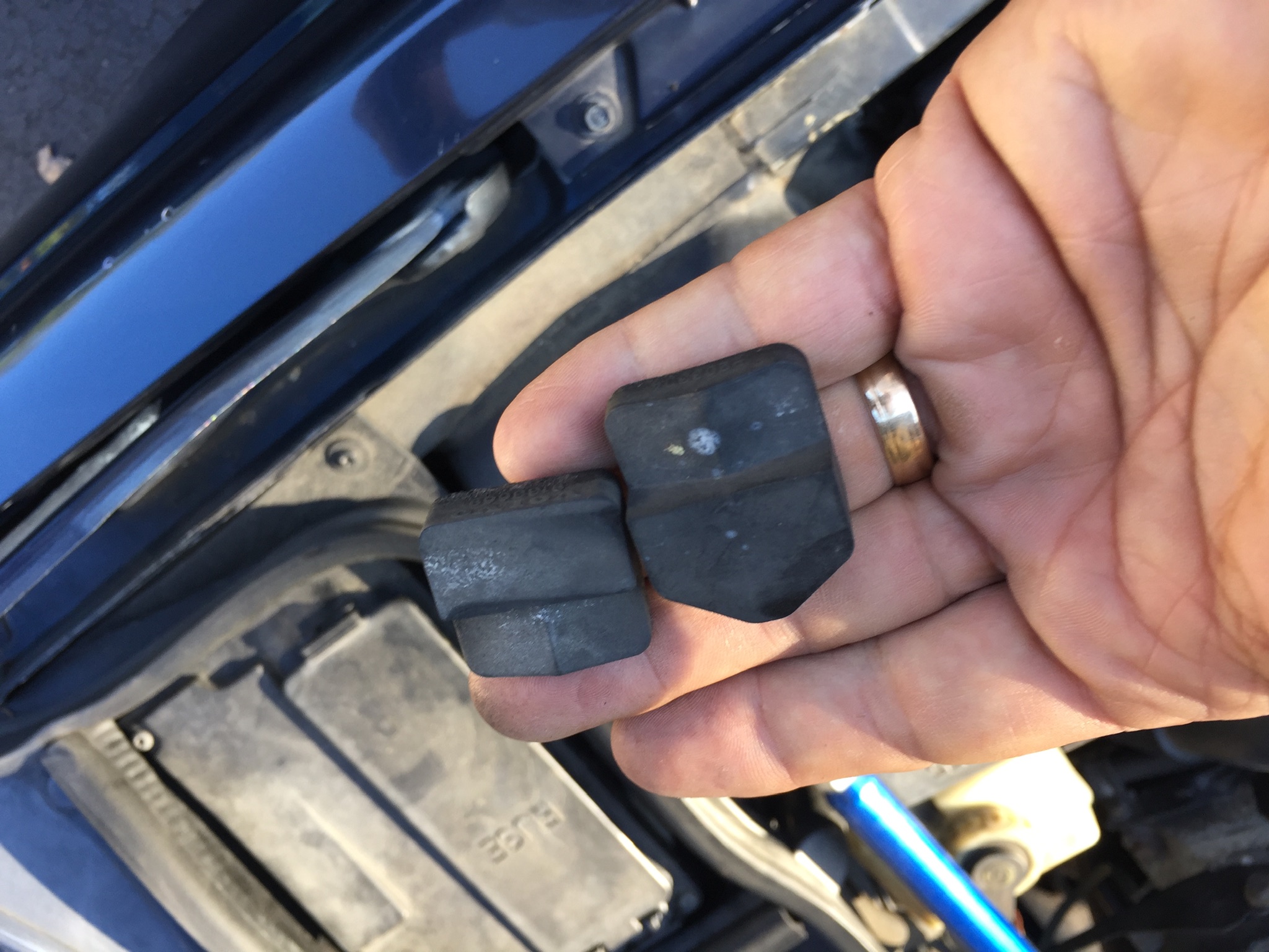

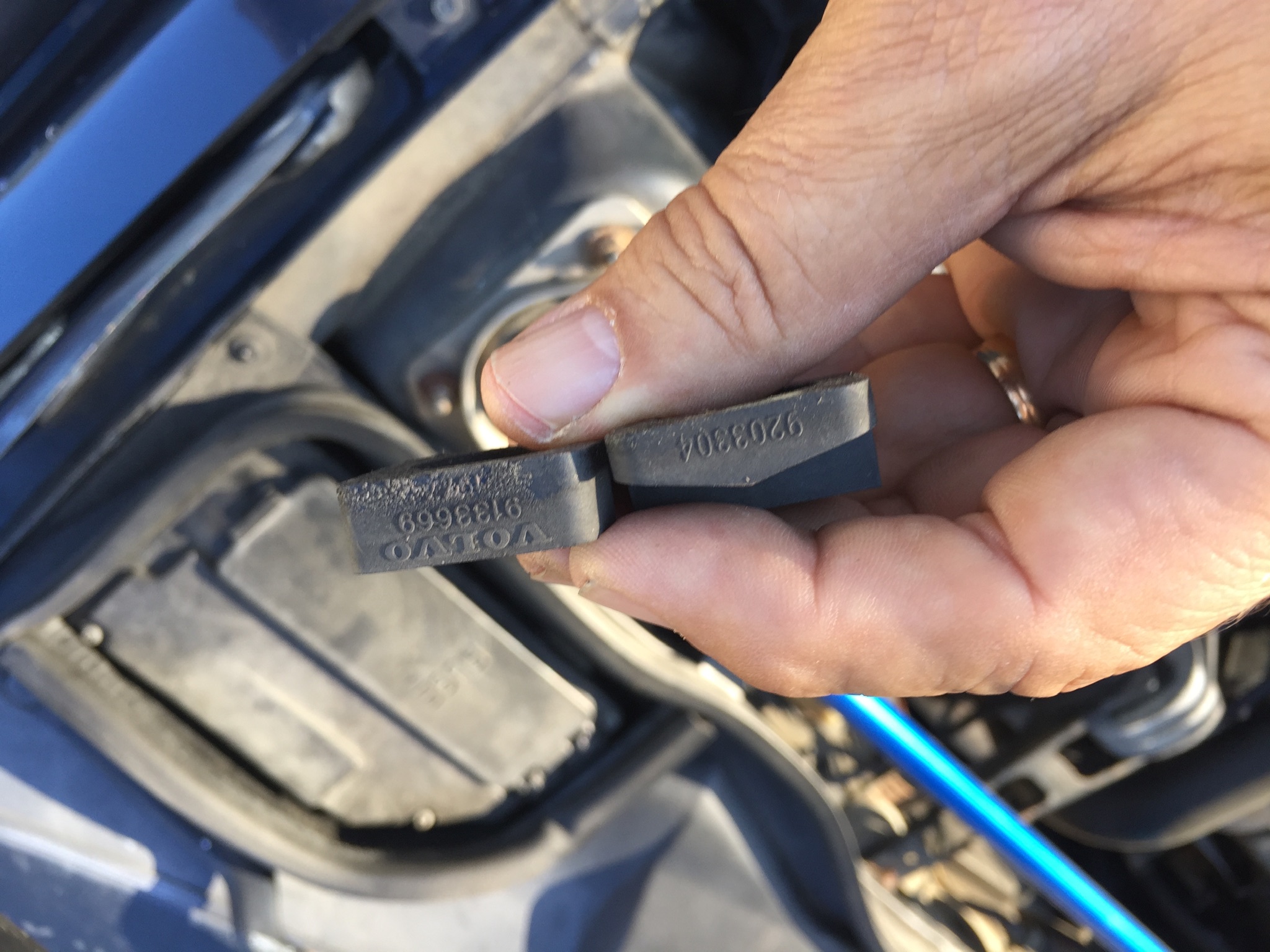

The rear hood pads change from 1998 to 1999
This has to be the most useless piece of information on the web
