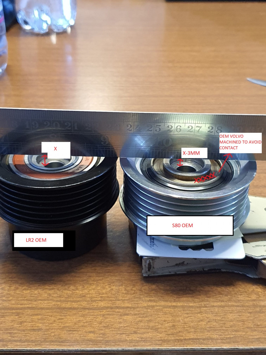

The matter is that mine 2 engines have from the factory two different pulley, in the FL2 i've found the regular black OAD pulley, in the S80 i find a metal finished OAP, BUT there's a more important difference between these pulleys, for some reason the shaft on the S80 is 3mm shorter than expected, so there is no pulley on the market that i can buy and and simply fit, i have to make a 3mm metal shim in order to fit a new pulley on the S80.
I will buy a new OAP like your Proparts, and than add the 3mm shim.
Thank you !

I think the machining mark you identified is used to press the pulley together not as a clearance for the engine.
Looking at the INA website shows the same part number for a 2008 LR2 and 2010 S80
https://webcat.schaeffler.com/web/schae ... owResult=1
https://webcat.schaeffler.com/web/schae ... 4227&csc=1
The drawing is a bit confusing because its a generic drawing
For the part that I removed from my S80 the measurement that you are making is 10.5 mm
This is exactly the center of the third valley that holds the belt.
If you are at the third valley then you are good
I modified the sketch to show what the part actually looks like
Thanks
Paul

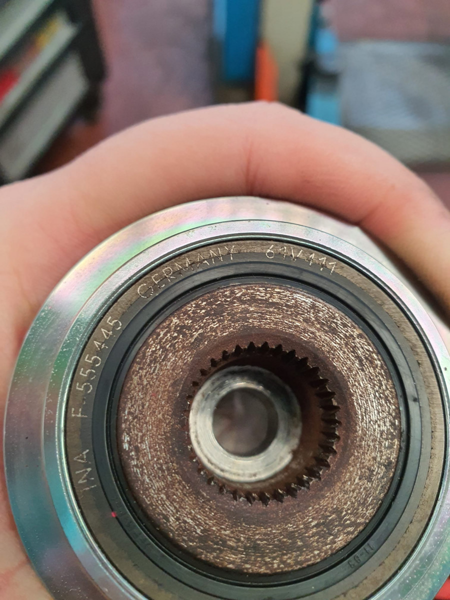

The pulley on my LR2 measure 10.5mm, the same of your measurement, but for some strange reason the pulley on my S80 measure 7.5mm :shock: :shock: :shock:
If i try to fit the LR2 pulley on S80 it crash on the timing cover and it can't spin at all.
It seems that my particular engine has a 3mm shorter shaft, maybe a factory problem, solved with a pulley that is made and properly machined just for my engine !
I've measure even the shaft from the oil seal to the end and i've 3mm missing material.
I know that it's completely non sense, i own both engines from new, unfortunately the pulley that i need doesn't exist on the market, i've called INA and they confirm that my pulley is unique and not supply.
So i think that the only way is a new ProParts pulley with a 3mm shim on the back.
Attached you can find my strange pulley in comparison with the pulley that came from LR2.
Thank you very much
