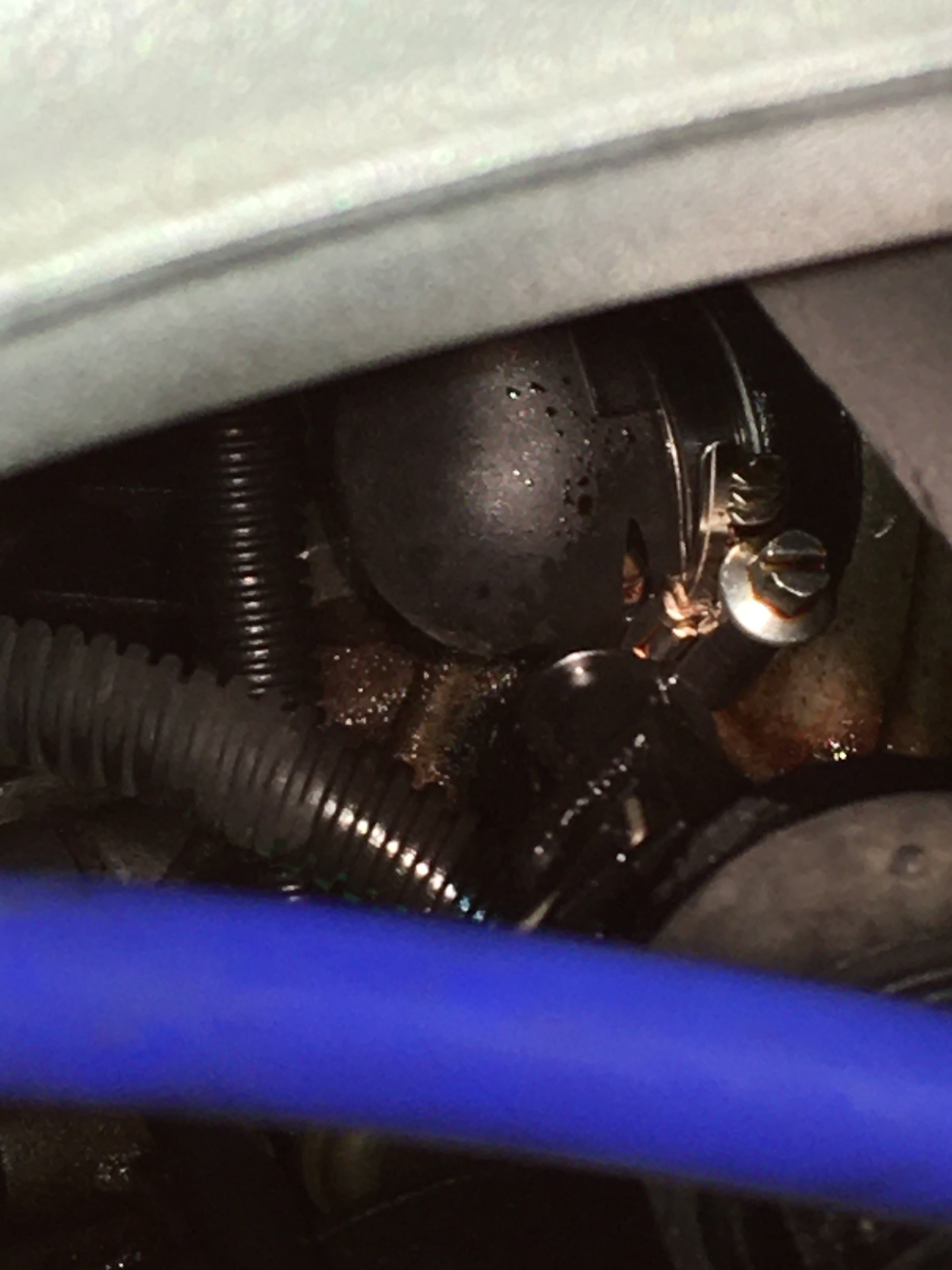

Terrible zoomed phone flash pic, but can you see the vertical split here parallel to the clamp? Maybe I caused it? Maybe the clamp is on too tight? Bad hose?

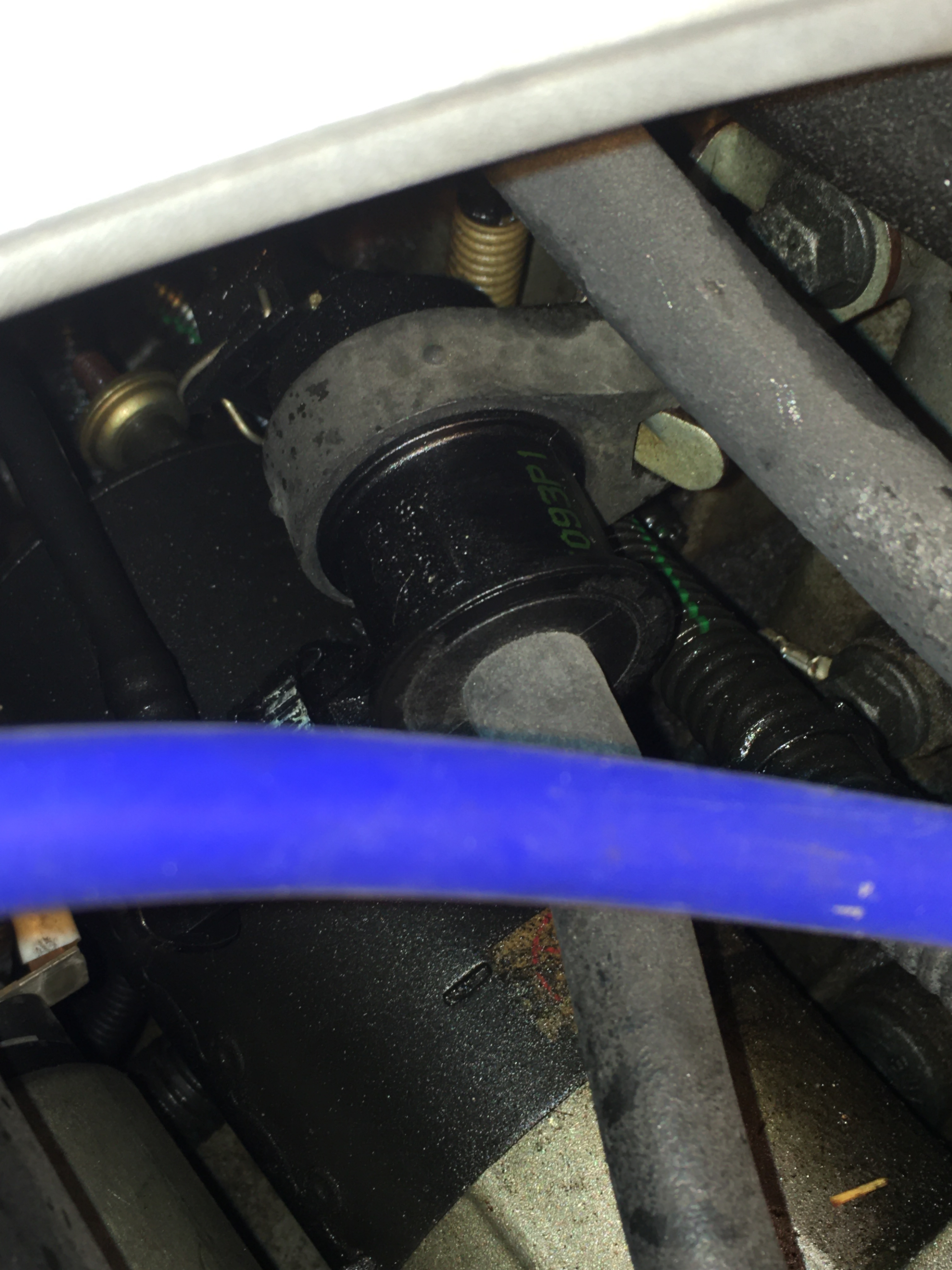

Also - anyone know what this fitting or valve is near there under the intake? It's held on to the block with a bracket near the knock sensor. The green printed number is 5093P1.
Those clamps look good. Hard to get decent clamps at auto parts stores these days.
