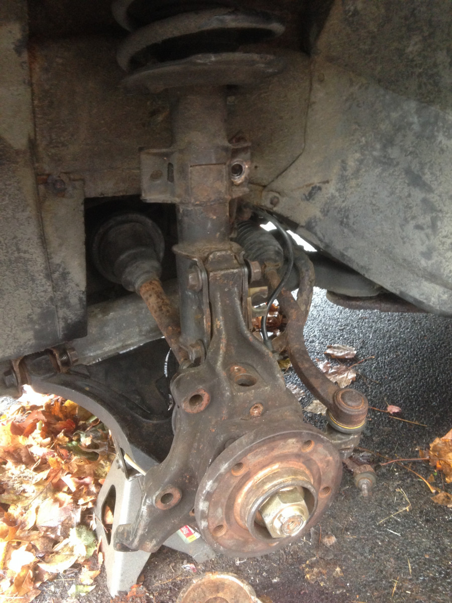

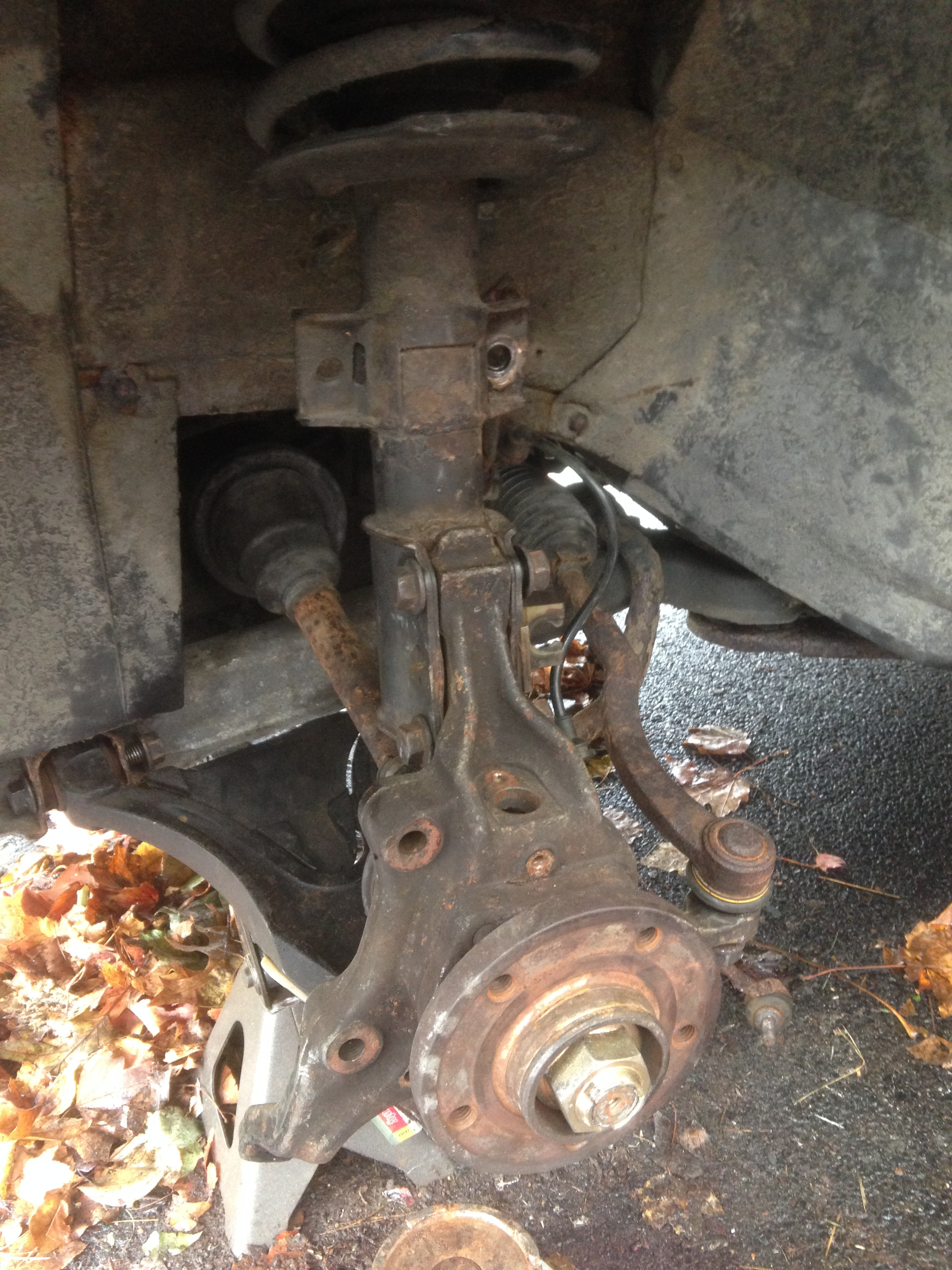

Well got Grunhilde back on her feet tonight , after fighting the worst Turd of car repair I think I have ever dealt with.
Right side is done except for a CV boot

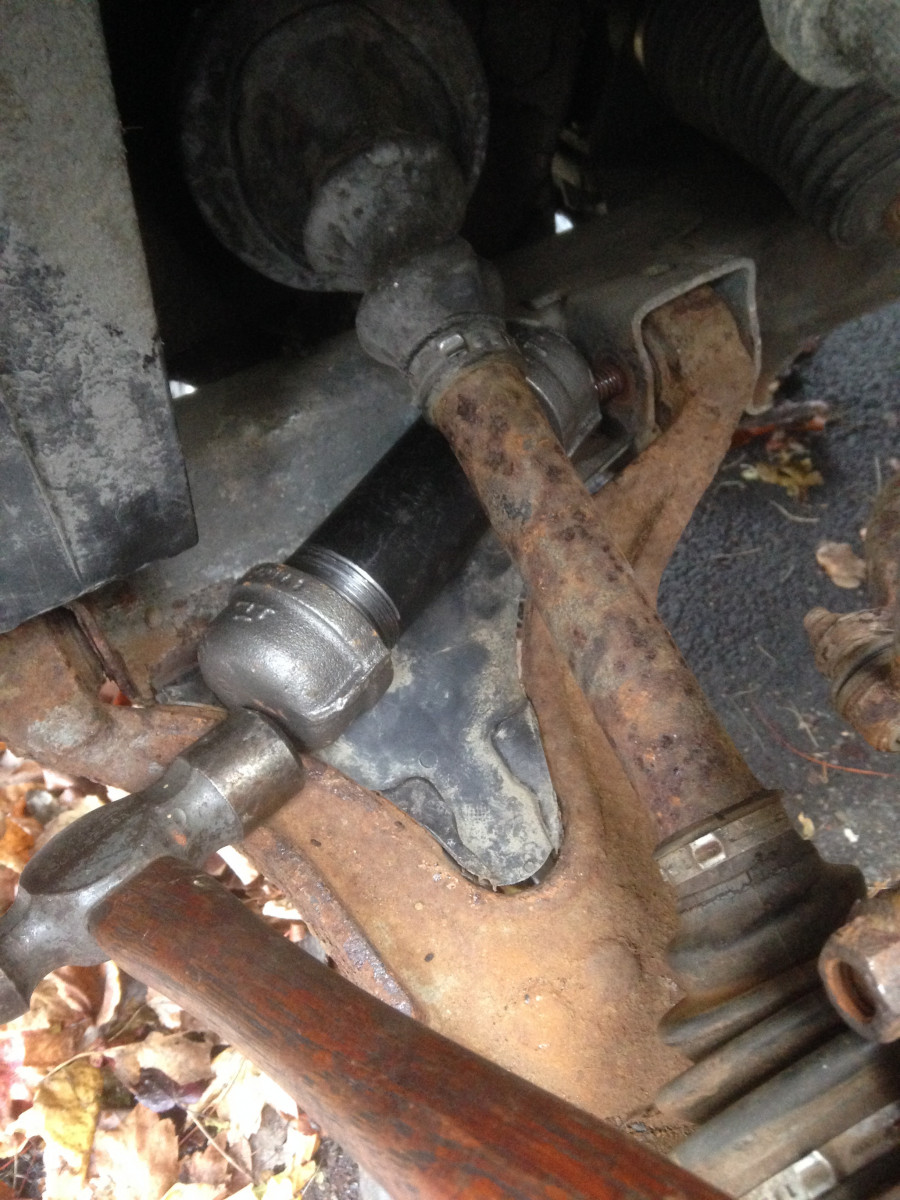

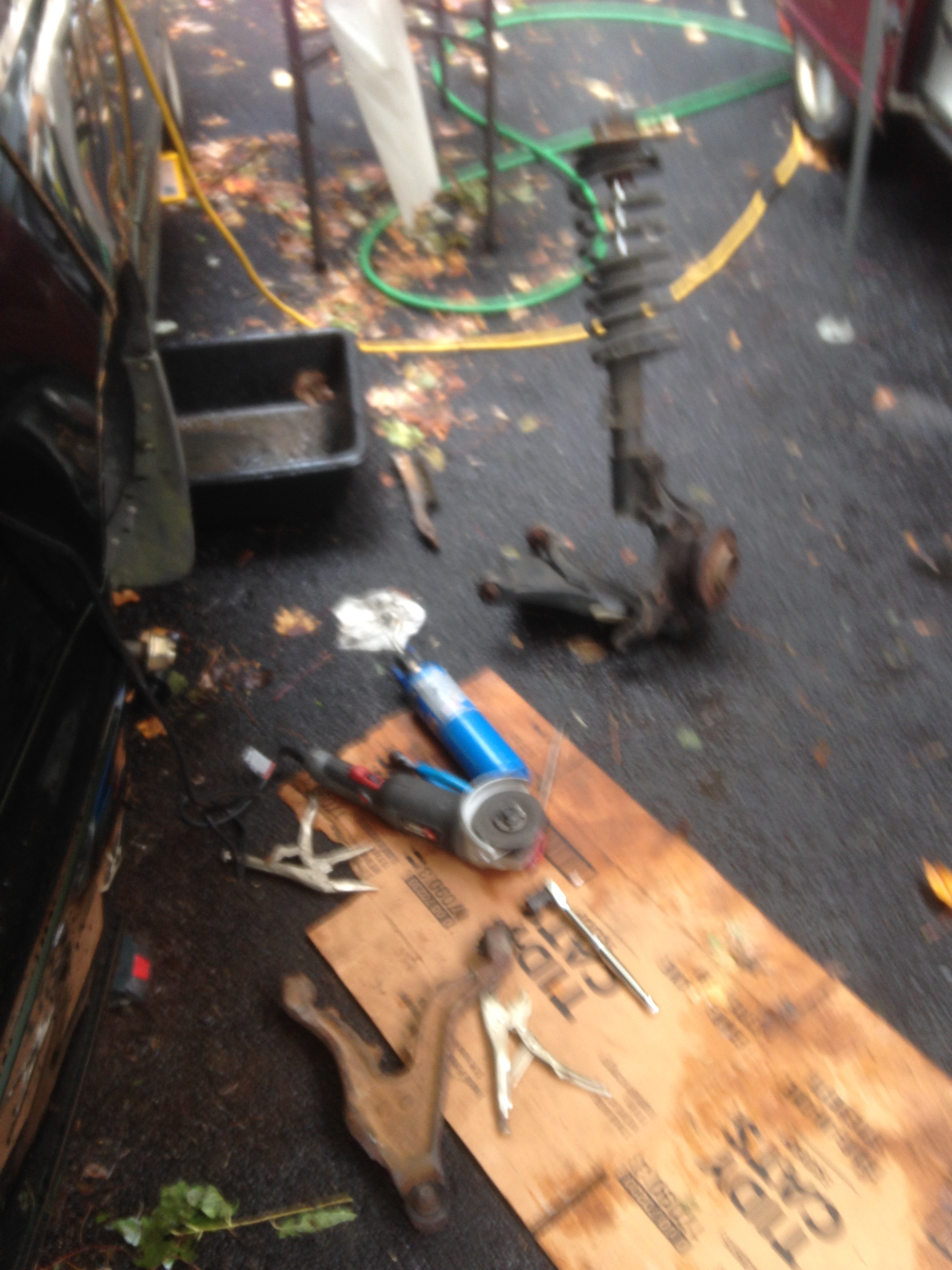

Left side LCA strut and knuckle all unbolted. Wait, LCA Nuts are off , one Bolt pushes out, the other one ... stuck

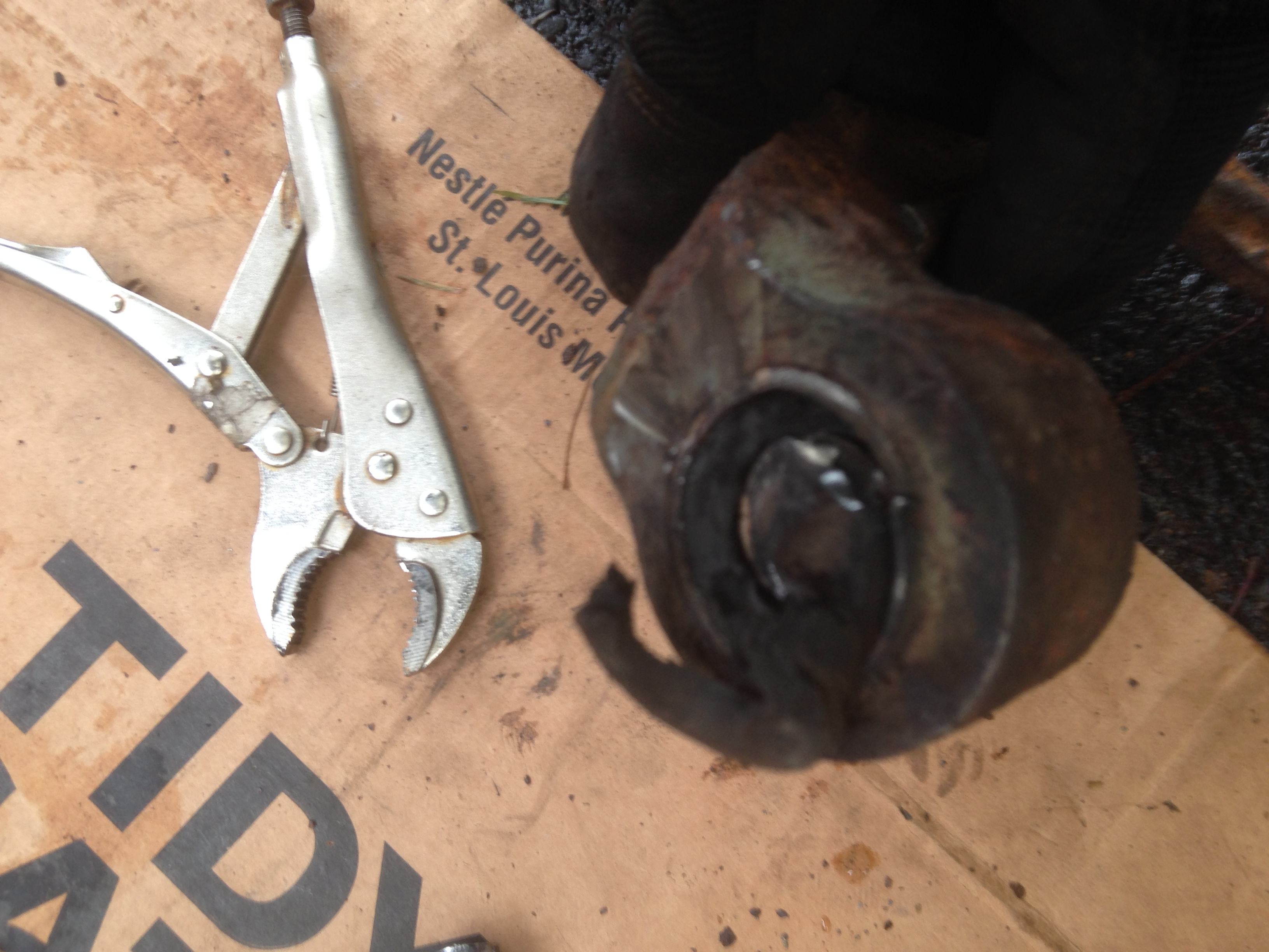

Turns out the metal bolt has bonded to the metal insert in the bushing. You can't impact it off because the rubber absorbs all the action.

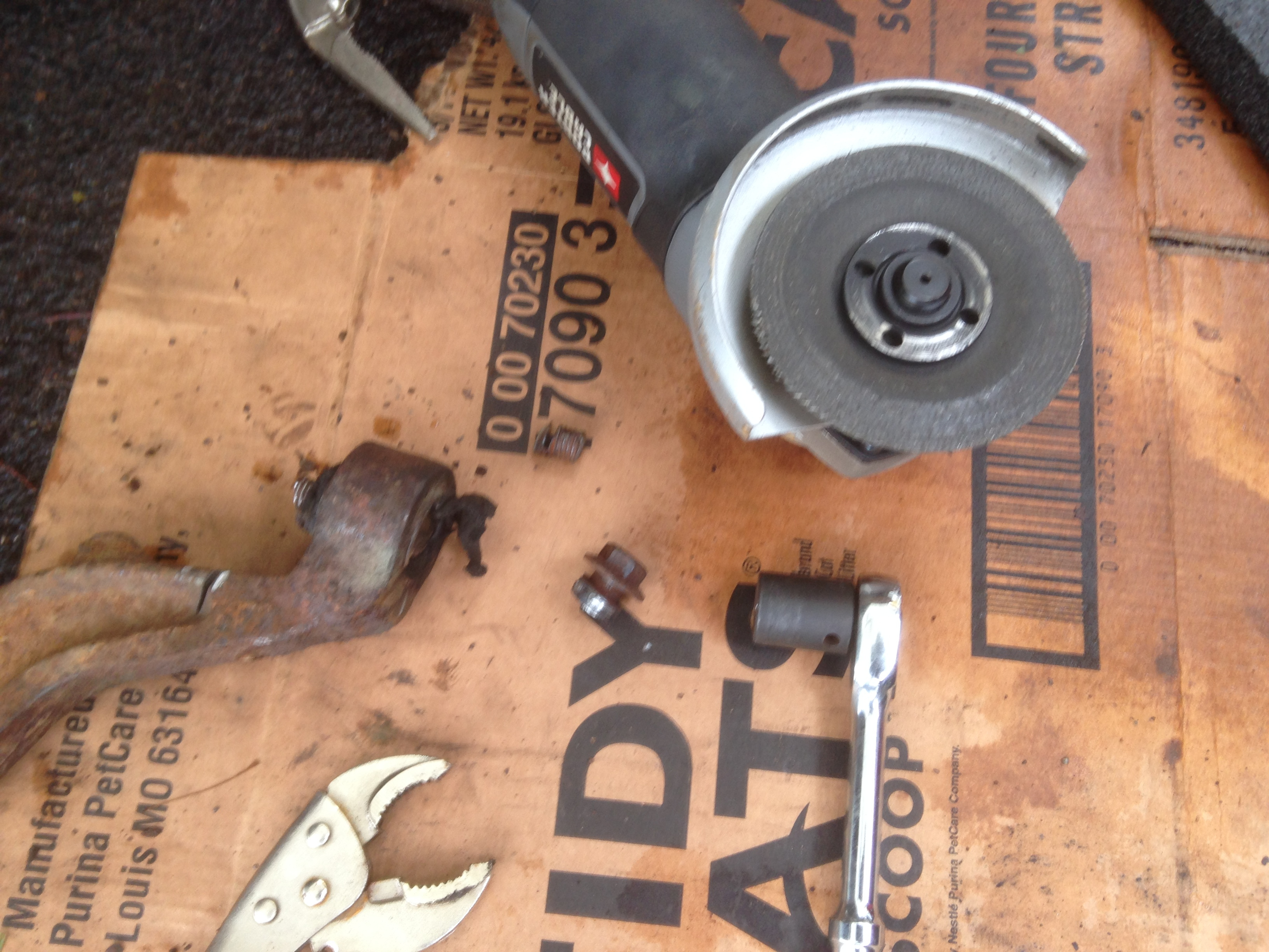

I melted the rubber with a torch which left me with a bolt that spins but nothing to grab.
I tried all sort of pressure Tricks but ended up cutting it off with A wheel. Clearance was tough as we needed a 4.6 inch wheel to reach in to cut
This was a four hour ideal to remove one bolt , without nut

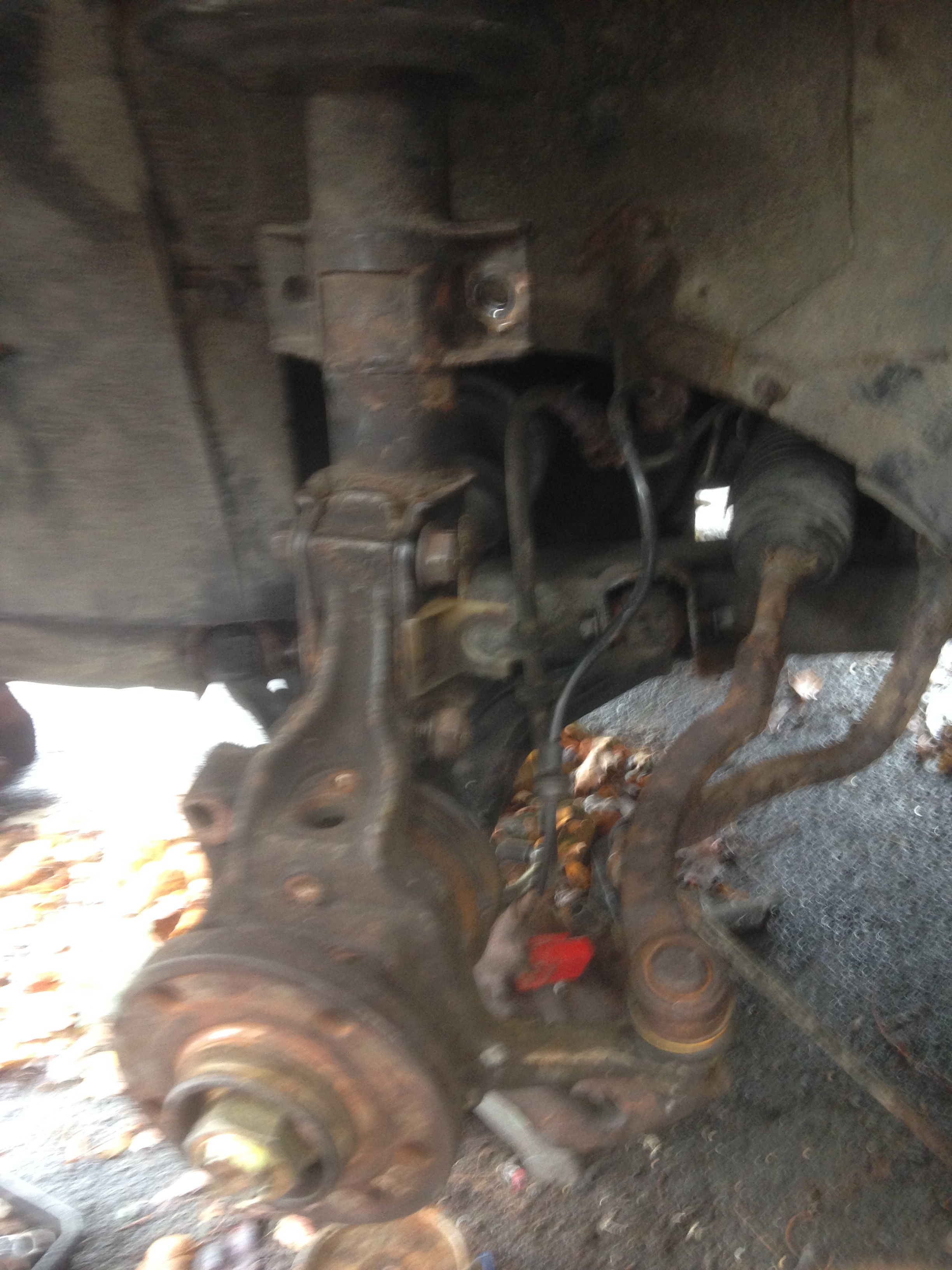

With a punch tool that heavy, try to use a bigger hammer - like 3 or 4 pound.
- Posts: 36142
Punching was useless. The energy was absorbed by the rubber bonded to the metal bushing. I was just compressing the rubber slightly. Really frustrating.

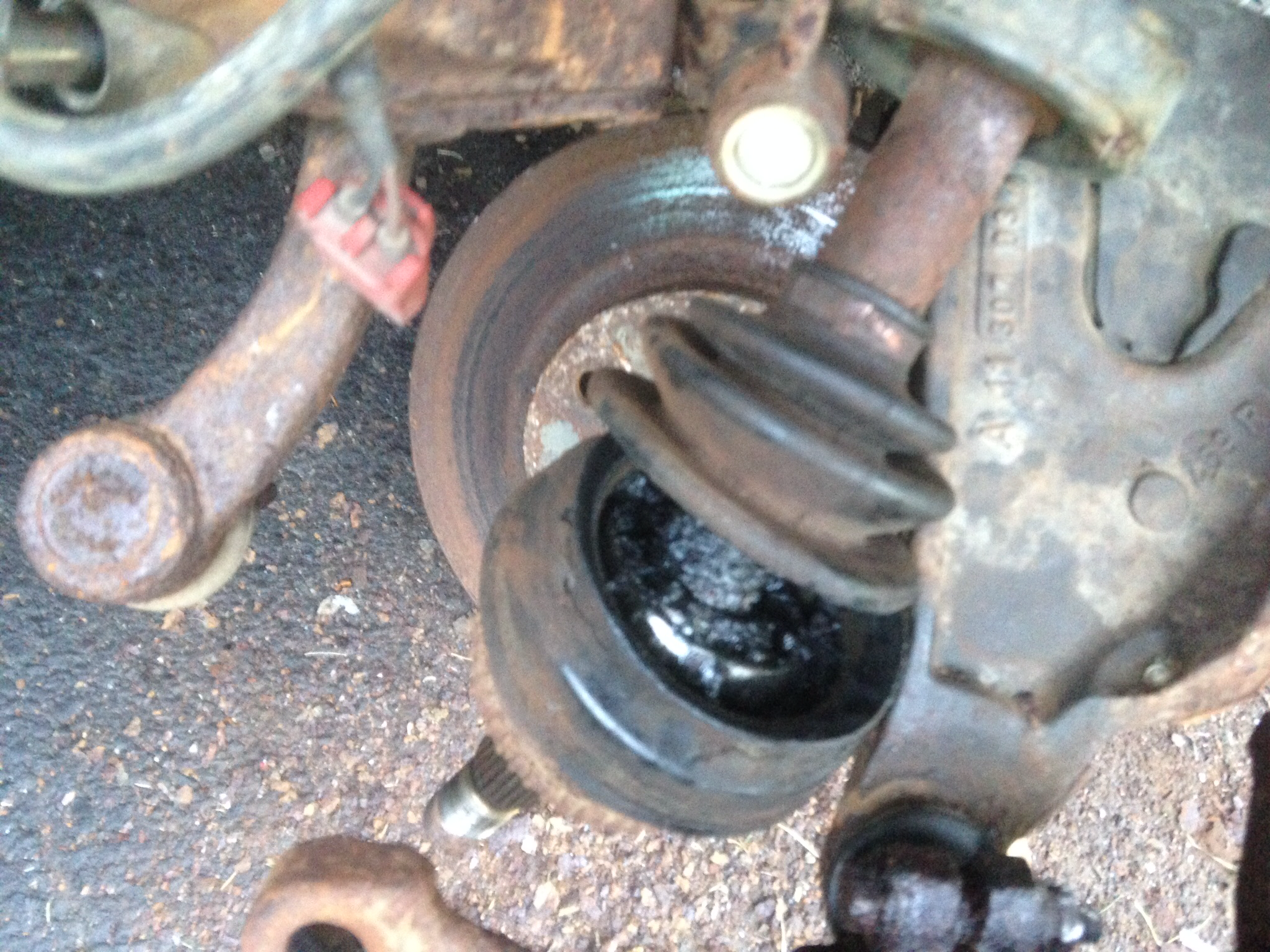

Stuck on the passenger side driveshaft
Is this kind of outer CV the kind that just pops off a circlip ? No snap ring is visible on the shaft.

IF you clean the grease off around the shaft you should find a hidden reverse 'C' clip. You have to hold the shaft in a strong bench vice, expand the clip and hit the knuckle up on off. Much easier with a helper unless you have 3 hands. Sometimes the clip gets stuck in the groove. You may have to work on it to get it to be able to move and rotate in the channel.
I use a brass drift under the knuckle to prevent damage.
