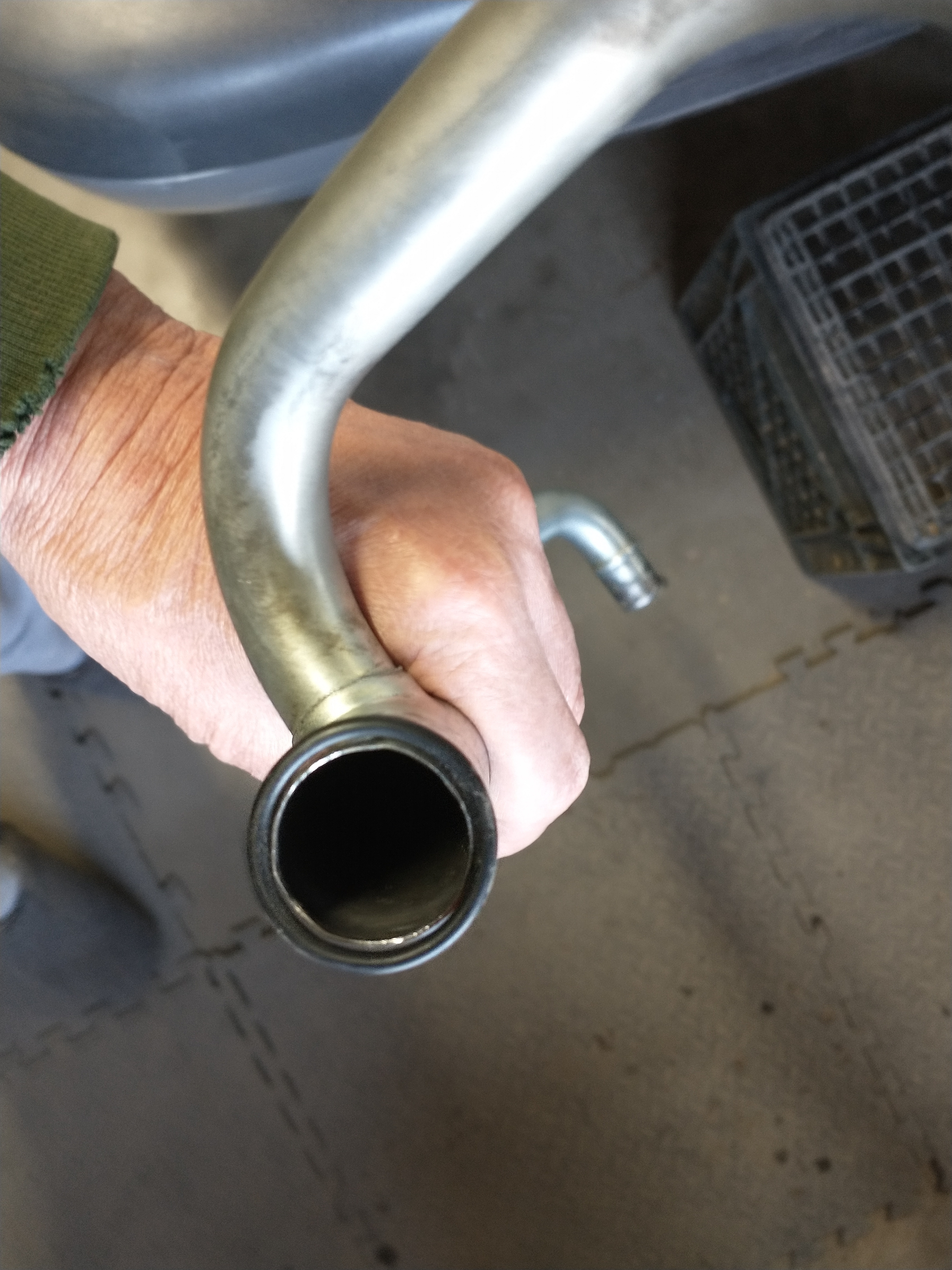

Received an O-ring today, but won't have time to install till this weekend.
It would appear that the tapered end makes a world of difference. You can certainly see why the straight cut pipe would be hard to install and be pron to nicking the O-ring.

Looking at my pic, it looks like there is a small nick in the new O-ring, but it's just something with the pic.
Ring is in perfect condition.

Installation went beautifully !
I can say that the O-ring can be installed without pulling the water pump. As long as the end of the pipe is tapered. I also slipped the O-ring on the pipe and left it that way for a couple of days to help stretch it some. When I was ready to install, I took it off the pipe and popped it in the recess. I say popped because that's what it pretty much did. Fit the recess snugly all around, unlike the first O-ring.
A little lubricant, and the pipe slipped right in.
If the center mounting tab on the pipe had been flipped around 180*, then the pipe could be removed without taking off the exhaust manifold and turbo. Would have been a simple thing to do during design phase. That one bolt makes you have to pull all of that other stuff just to remove the pipe.
